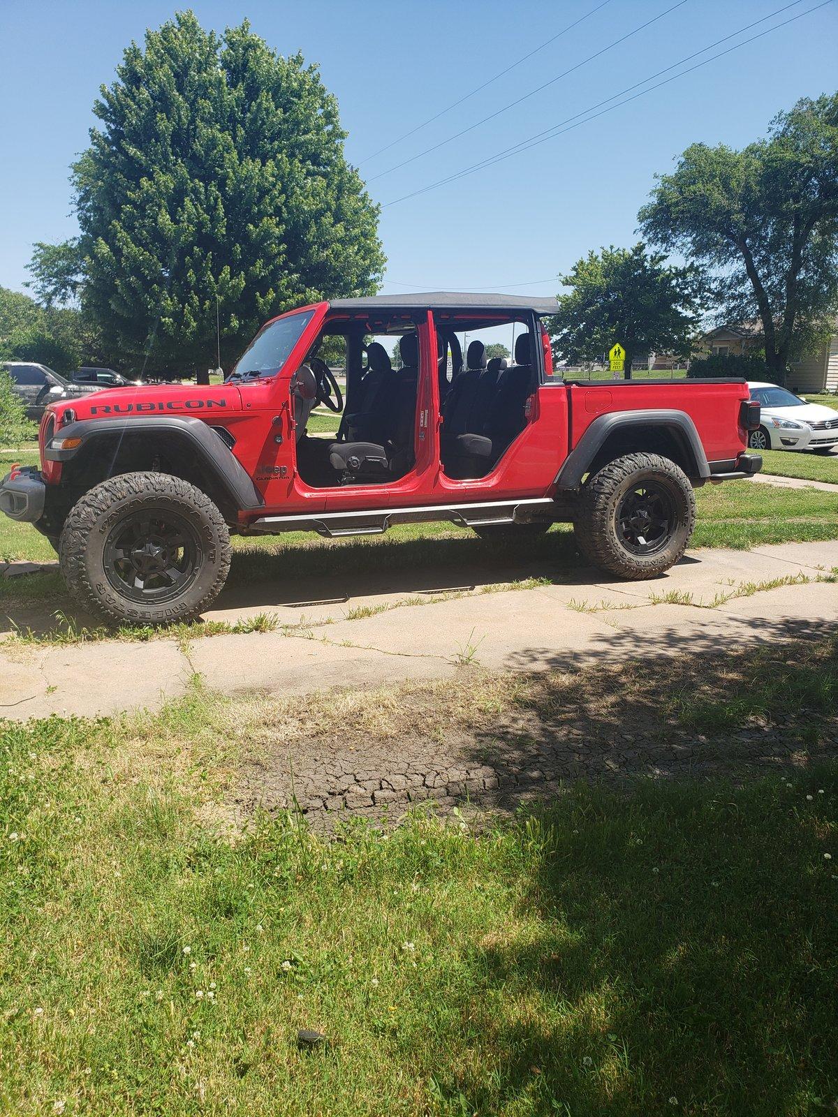

That was quick haha Looks good! Factory steel wheels or did you paint the aluminum wheels black?
Yea these are the rims it came with. One of the reasons for me choosing this truck. The granite color with black sort of ghosted throughout does it for me.
