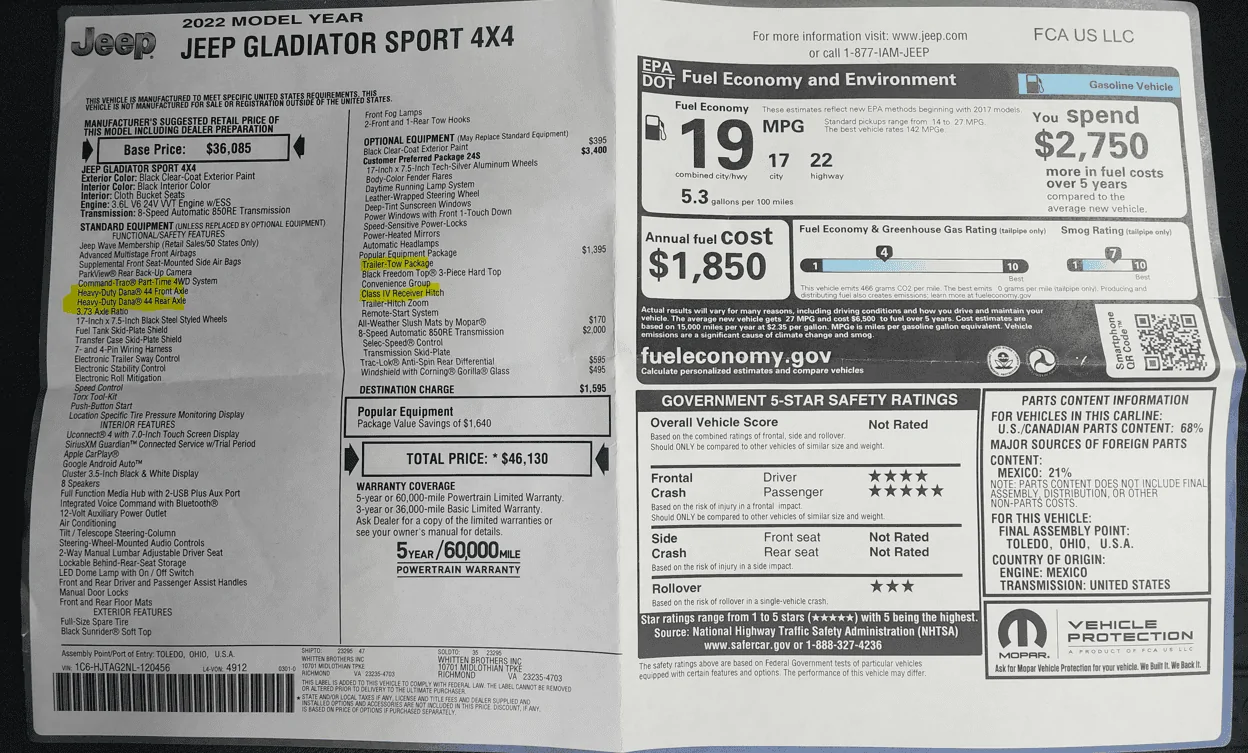

Does my Sport S have the max tow? I was under the impression it would specifically state "Max Tow" on the window sticker but mine does not. I question this because my sticker state 3.73 gears but also the Dyna 44 upgraded axles and class IV receiver. Here is my sticker.

2021 Gladiator Sport S. Max Tow.
No, you do not. You would have 4.10 gears.

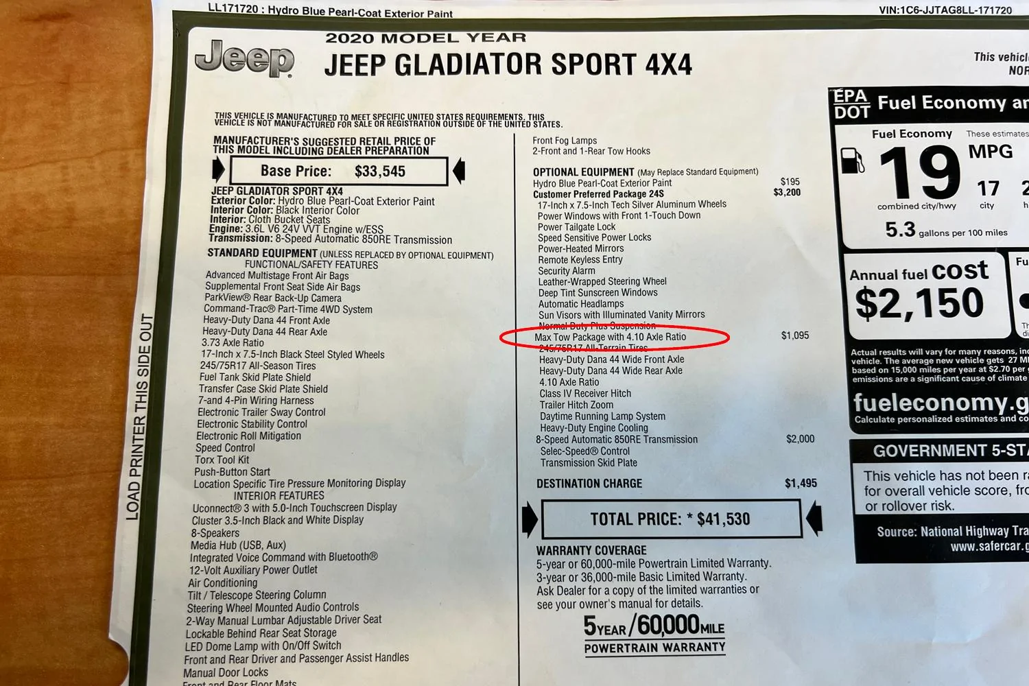

Here the window sticker from the Hydro Blue Giveaway Gladiator we built two years ago:

That is what I thought, but also thought the Dyna 44 axles were only on the Max tow. I see there is a Dyna 44 Wide though - which mine does not say.
All gladiators have Dana 44s, front and rear. But Rubicons, Mojaves, and Max tows have the widetrack version.

I am pretty sure the answer is a resounding NO.
