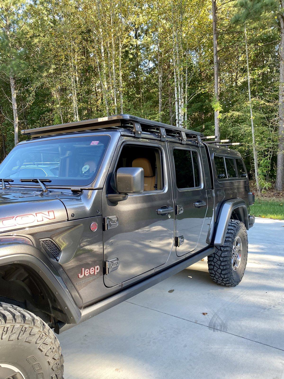

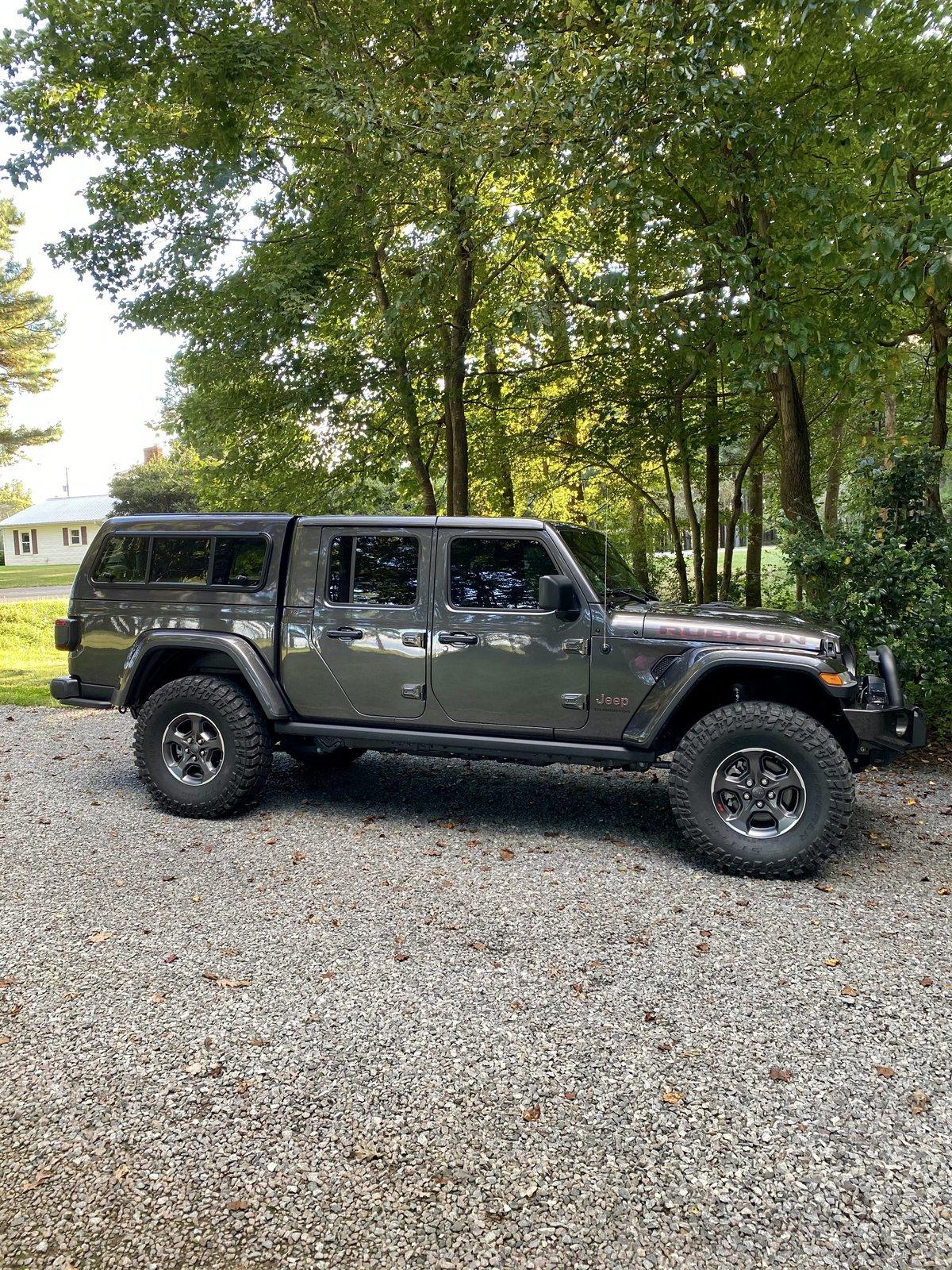

I’m going to swing my by the local dealer to see what they say. I’m running 37’s, Synergy 3” springs, front and rear track bars, lower control arms, etc. I just plan to lay it out there and just request the new steel steering box. Then I’ll install my Synergy brace. It currently handles pretty well and I noticed the most difference with the new lowers, trackbars, and falcon shocks. I’d just rather have the steel box...
With that kinda rig they better hook you up. It makes me sick that I bought this truck a month ago, saved for two years to pay for it, and I can't get any help from the company that sold it to me.
I hear you. I fell that regardless of the JT they should swap out the aluminum steering box for the updated steel one. It’s just good customer service. I mean it’s a $600 swap for FCA, geez...
