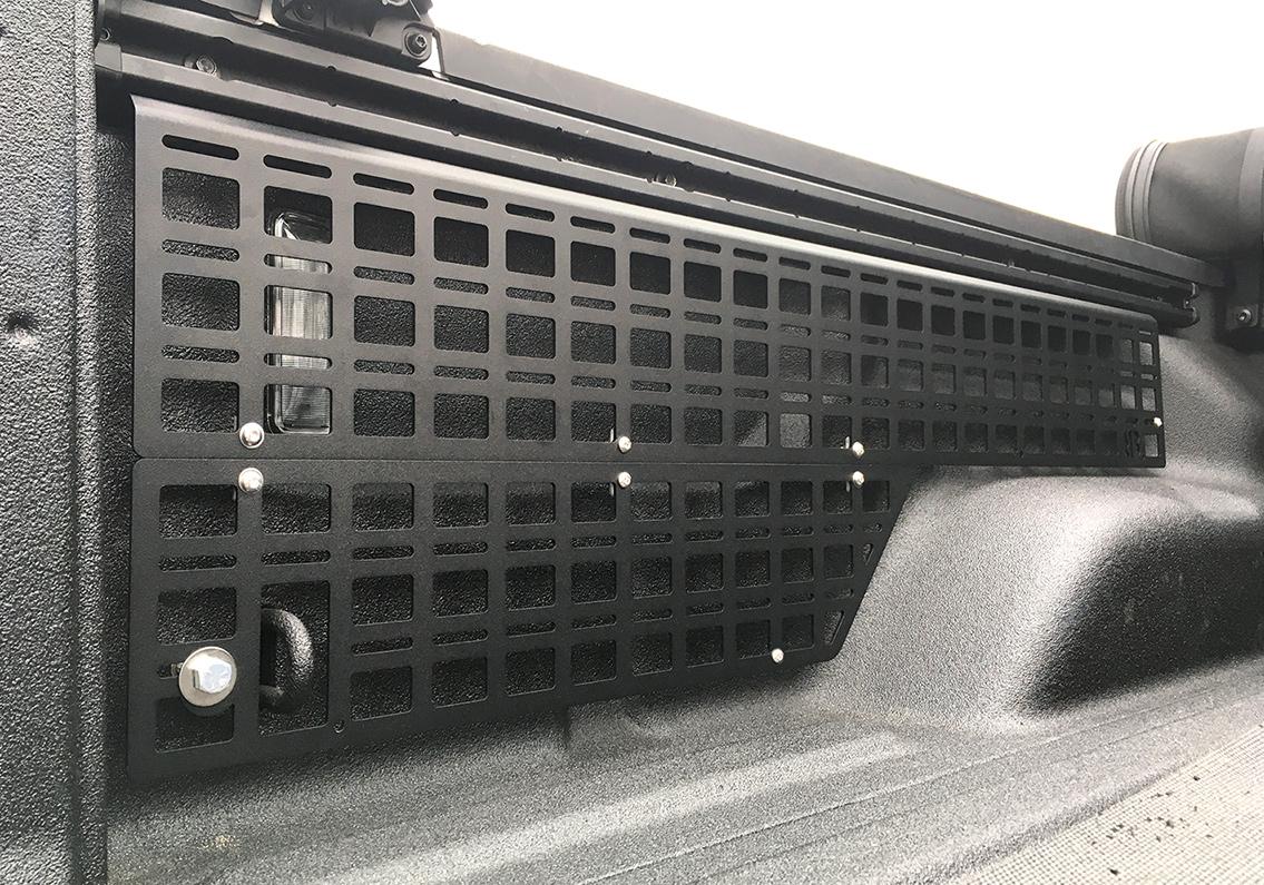

Let me know if you have any questions or concerns with our MOLLE panels. After reading through all the comments I wanted to chime in on a few items that you are considering. Our panels are all aluminum for lighter weight and no rusting. The hardware is stainless. While black would look better, it rusts, and that is not an acceptable option for us. I designed the panels to fit under the rail using bends, not secondary brackets, for optimal strength and they do work with the Diamondback cover. As for the bed light hole. When I was designing the panels I tested keeping a hole for the light but in the end I decided not to have the hole for a few reasons. The lights are angled to shine into the bed. The panels that have a hole directly in front of the light is not helping much as the light does not shine straight forward where the hole is. With all of the MOLLE holes in the panels there is very little difference in the lighting. And, since the whole point of having a MOLLE panel is to mount gear, once items are mounted, the light is being blocked, so I chose to have more usable space on the panel vs a cutout for the light. We also offer the option of a full lower panel (for either side) or a lower panel with a cutout for the bed outlet. If you don't have the outlet, you can choose a full lower panel and not lose mounting space for the cutout if it is not needed. Oh, and NO driliing

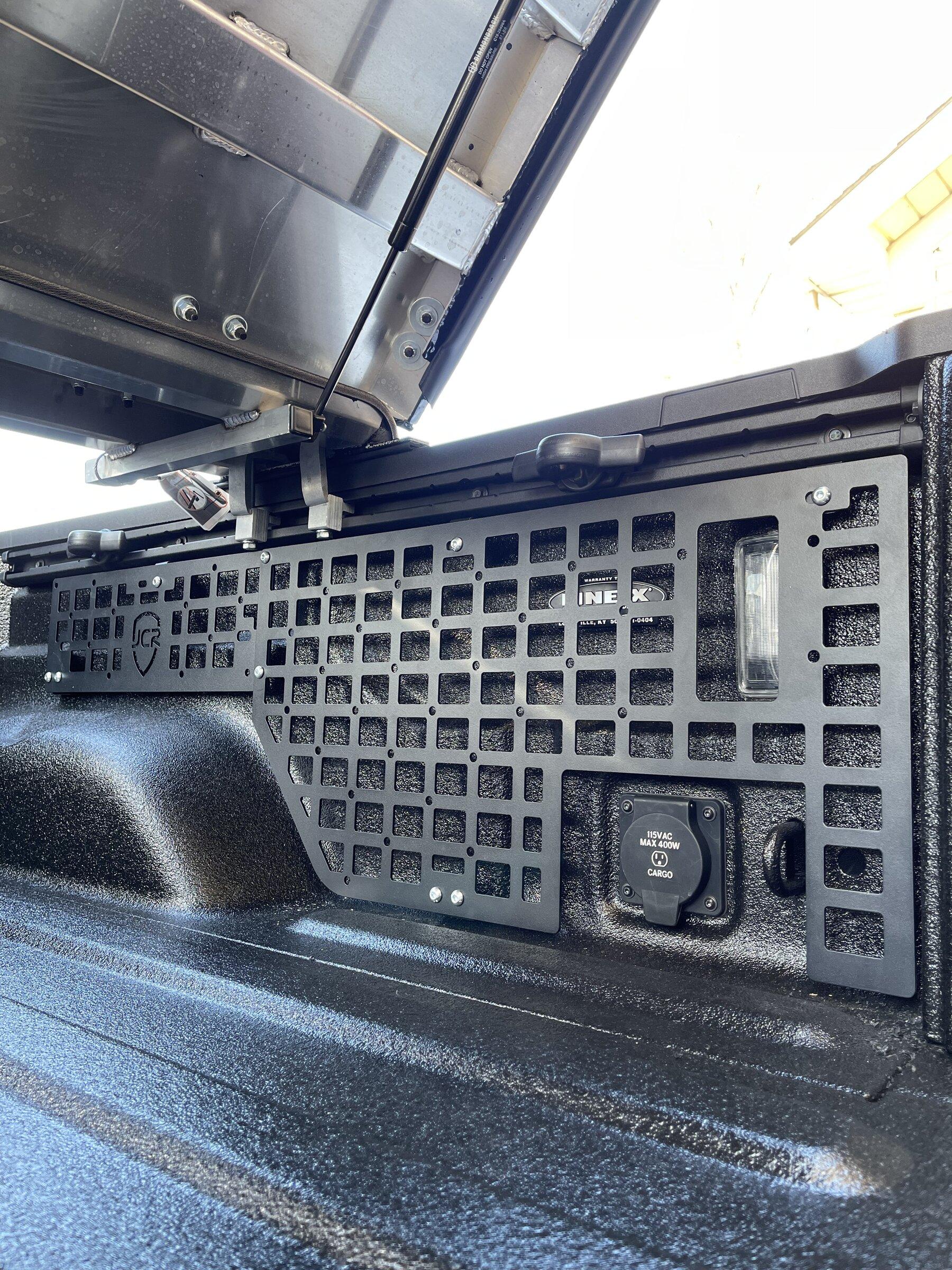

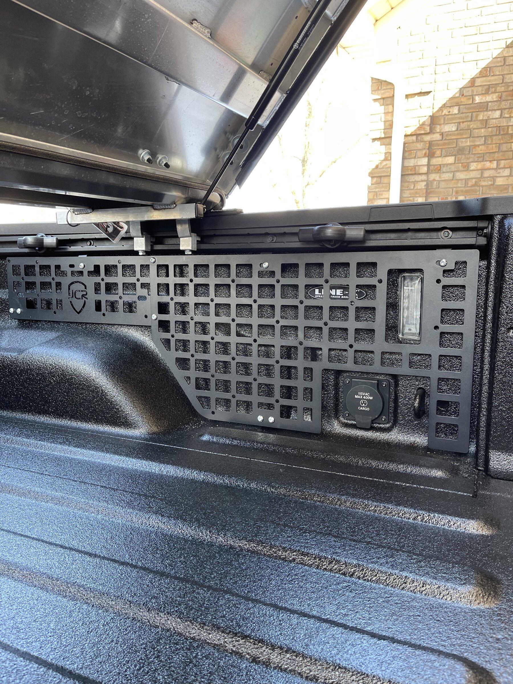

@JcrOffroad at the time because I wanted something that mounted behind the trail rail to give the most flexibility. As it turns out, the RSi Smartcap clamps can be moved around so it wouldn't have made any difference. The panels have been great, no complaints and they fit with the Bedslide (barely).
If you want to stop them from banging around with heavy items as mentioned in an earlier post, you can bend the tabs inward after you mount them behind the trail rail. When you install the panels, they will sit tight against the side of the bed with some pressure. I don' t get any noise whatsoever from them even with the Hi-Lift.
Jeep Gladiator Inside Bed Molle Setup 20220130_141854
It looks like the @BuiltRight and @813 Fabrication & Design panels are high quality as well, not sure you can go wrong with any of them.

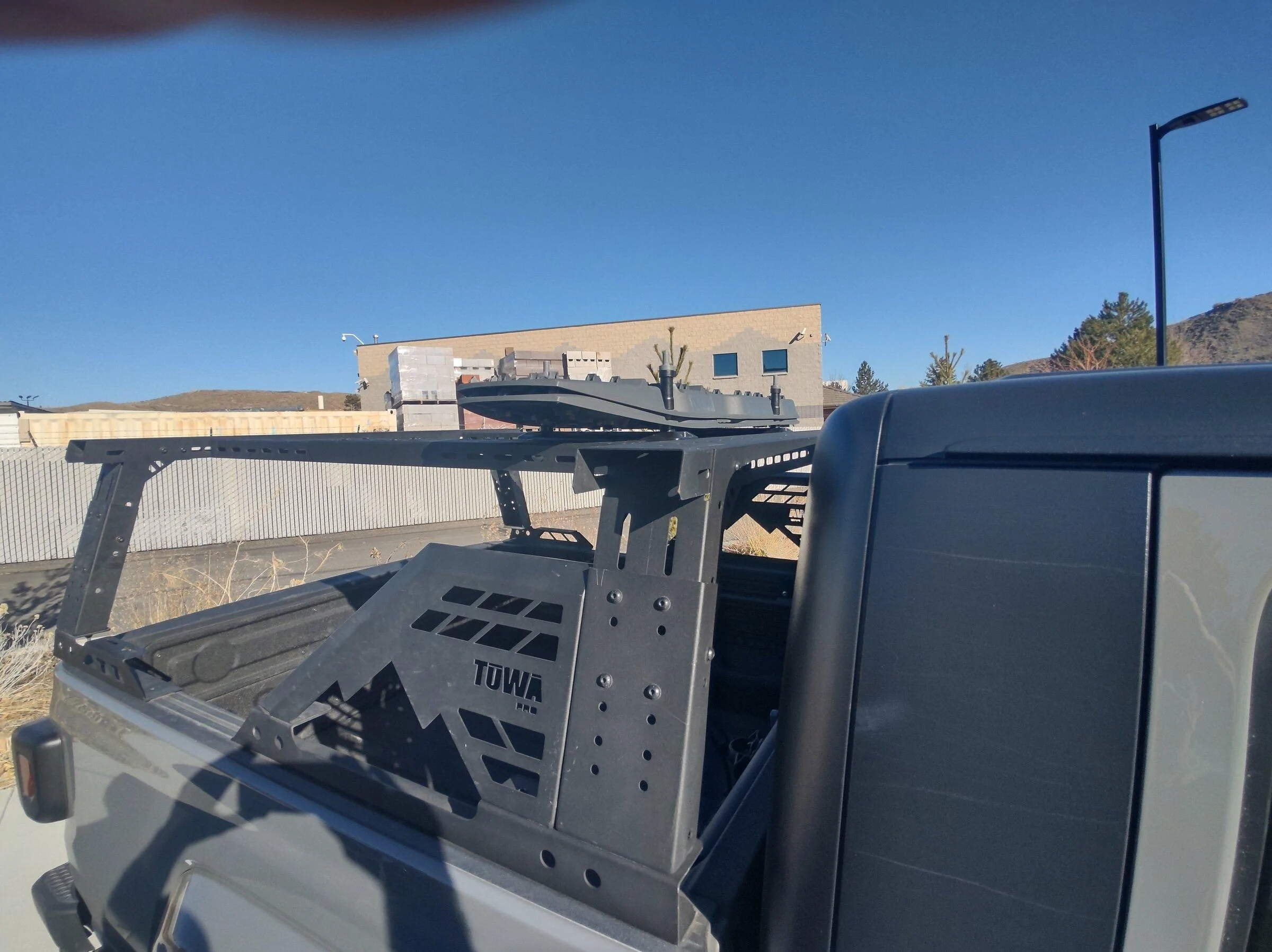

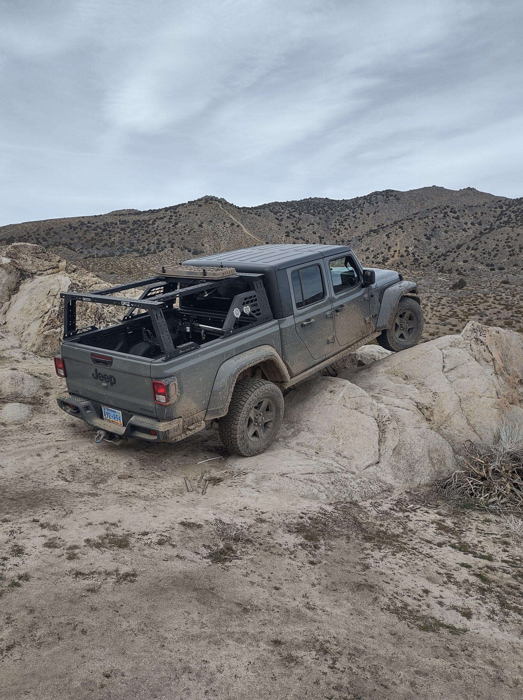

Recovery boards I ended up making a couple aluminum cross brackets for my bed rack. Purchased the mounting system from Exittrax. Quick fists on everything else

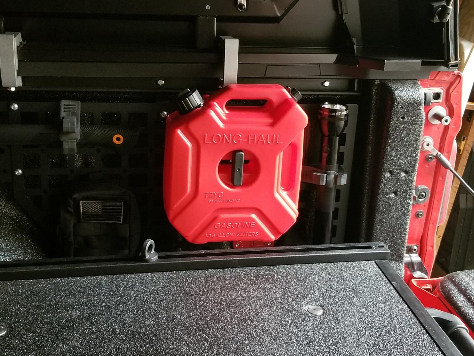

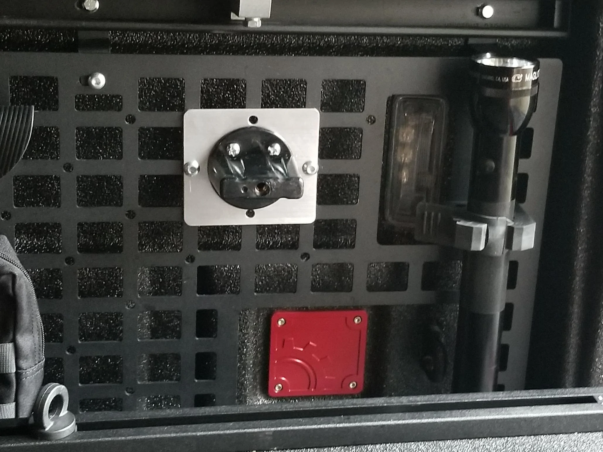

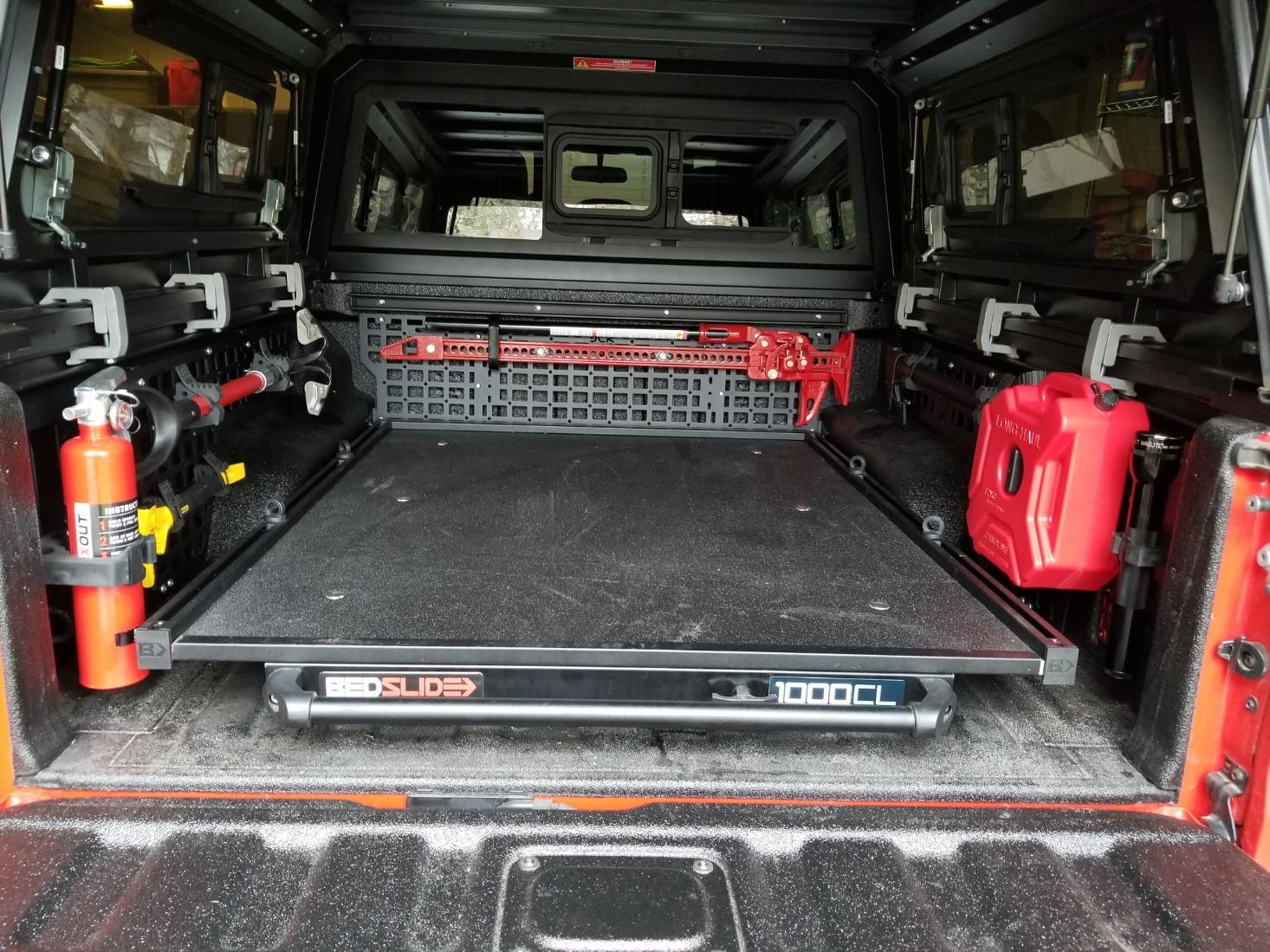

Quick fists, molle bags and some aluminum stock are your friends.
Jeep Gladiator Inside Bed Molle Setup 20220130_141624
Jeep Gladiator Inside Bed Molle Setup 20220130_141828
Additionally, most of the molle panel manufacturers have a few custom mounts. I'm using the @JcrOffroad Hi-Lift mount.
