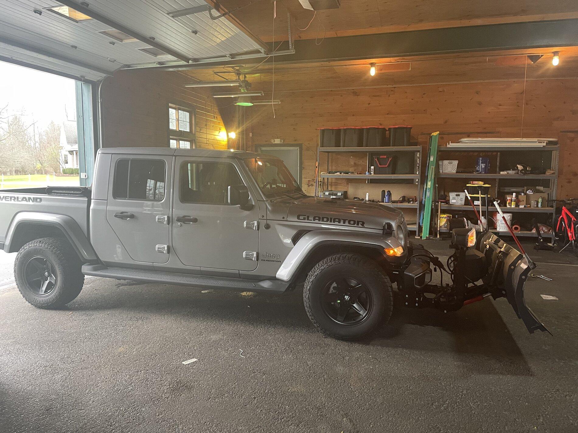

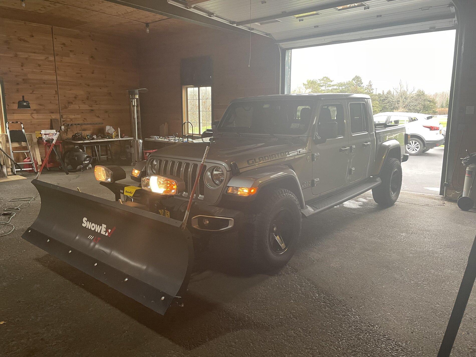

Just started the install of my Impact setup. Got the truck mount installed and working on the harnesses today.
Where did you poke through the front end with your hookup plugs (plow & Light)?
I had to drop the windshield and take off the side cap. There's a small opening on the passenger side that goes inside the cab. I'm not happy with it but there really isn't anywhere else that I have found. It's really tight that's the one thing the one ton trucks have on these jeeps.. lots of space to run wires.

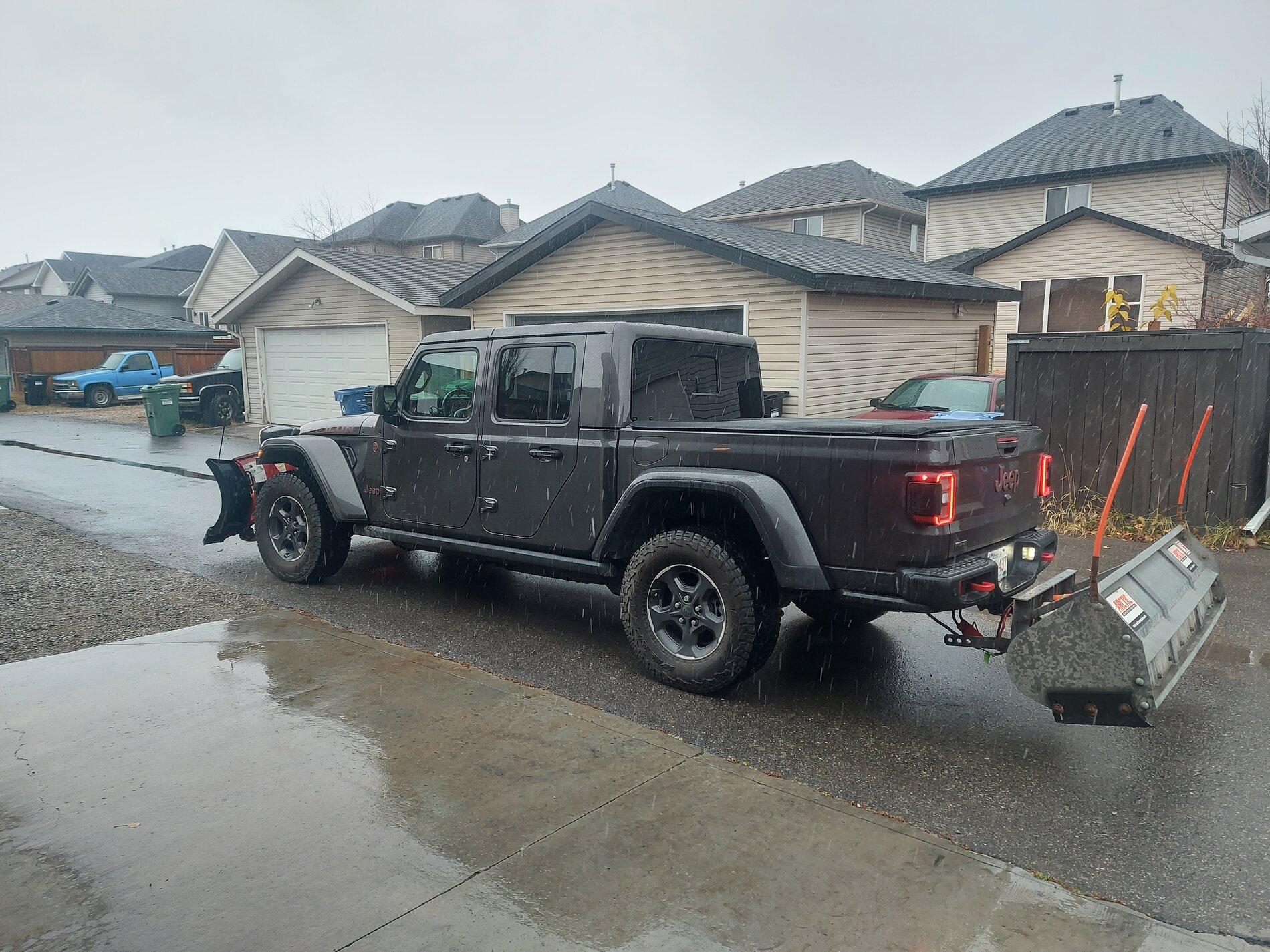

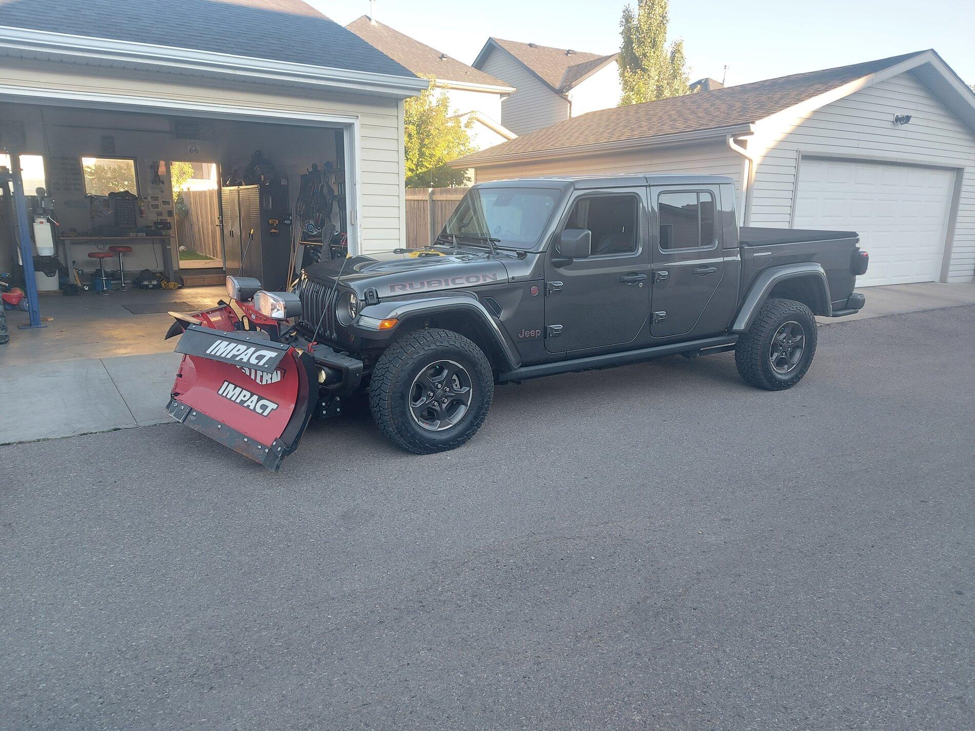

I have been plowing now for 15 years in Calgary and I can tell you there are a lot of those hours that I'm still putting in. I just did one 3 days ago. I have plowed with skid steers, one tons and now jeeps and I have found that the jeeps are a great rig to plow with. So much that I sold the Superduty in the spring and up graded into the gladiator. (Or down gated I'm not sure) I finally got to use it today and it's as good as my LJ. The one tons have there place for sure but the acreages and small business is were I plow the most. The skid steers are good to they just take to long to load and unload. But the only down side to all of this is your body. Mine is getting pretty beat up doing it. Back mostly. I think about slowing down but.... making money sometimes can be fun.

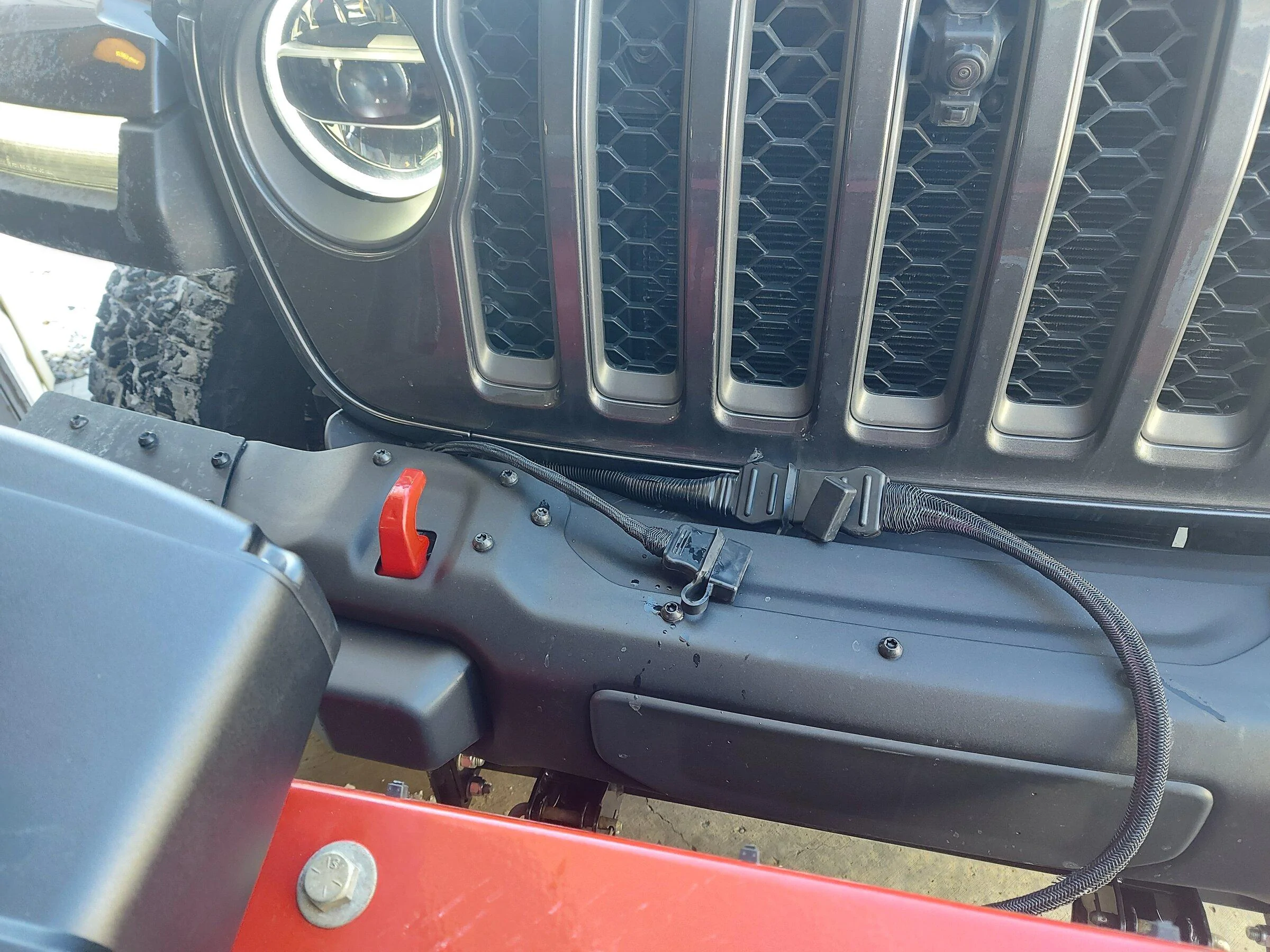

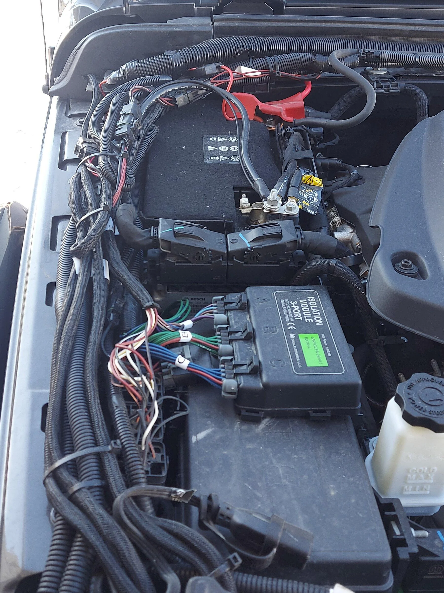

Oh, man. Wasn't expecting that answer!! How about out by the grille? Did you just route the plow/light plug under, or go through the grille?

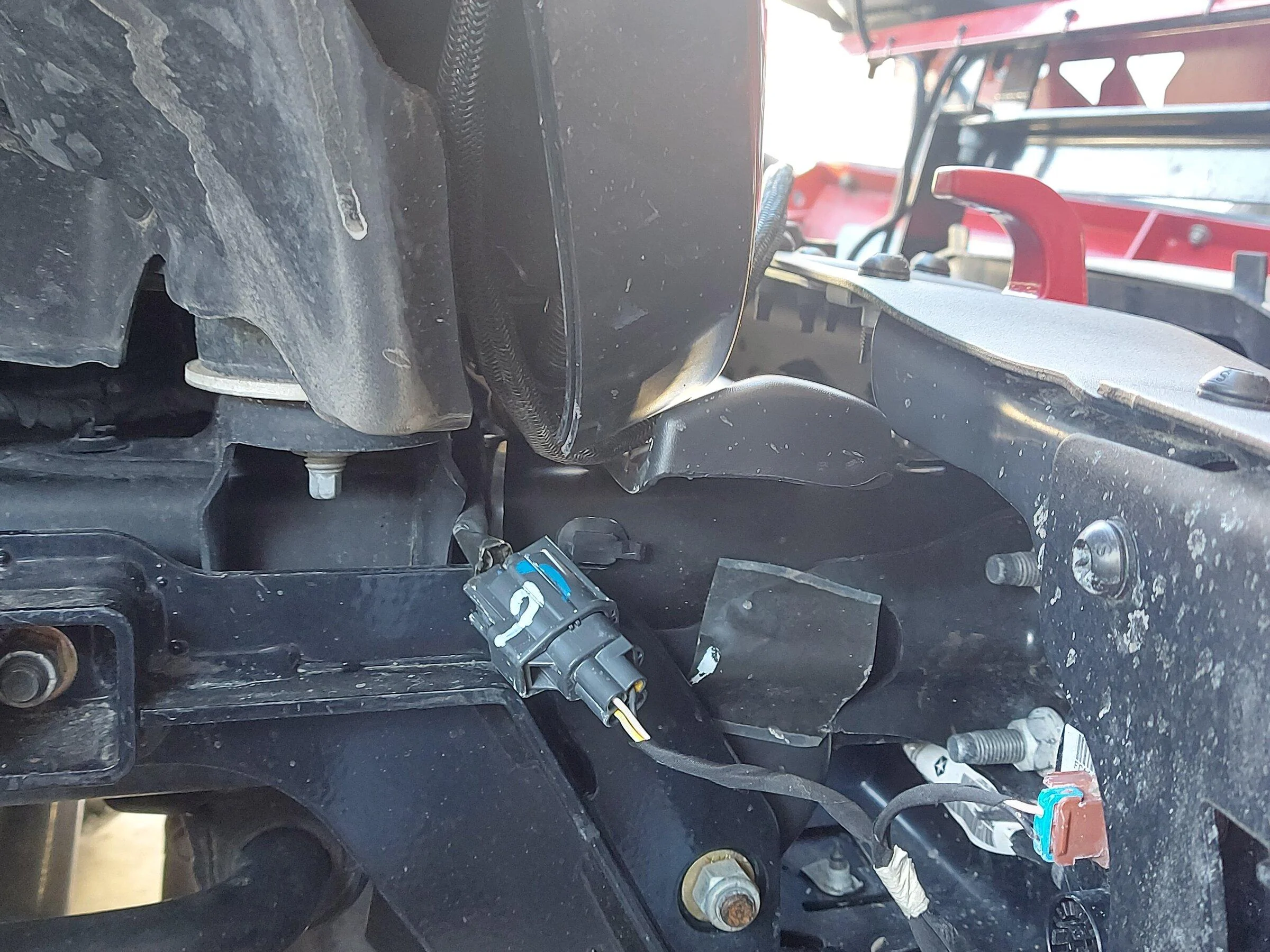

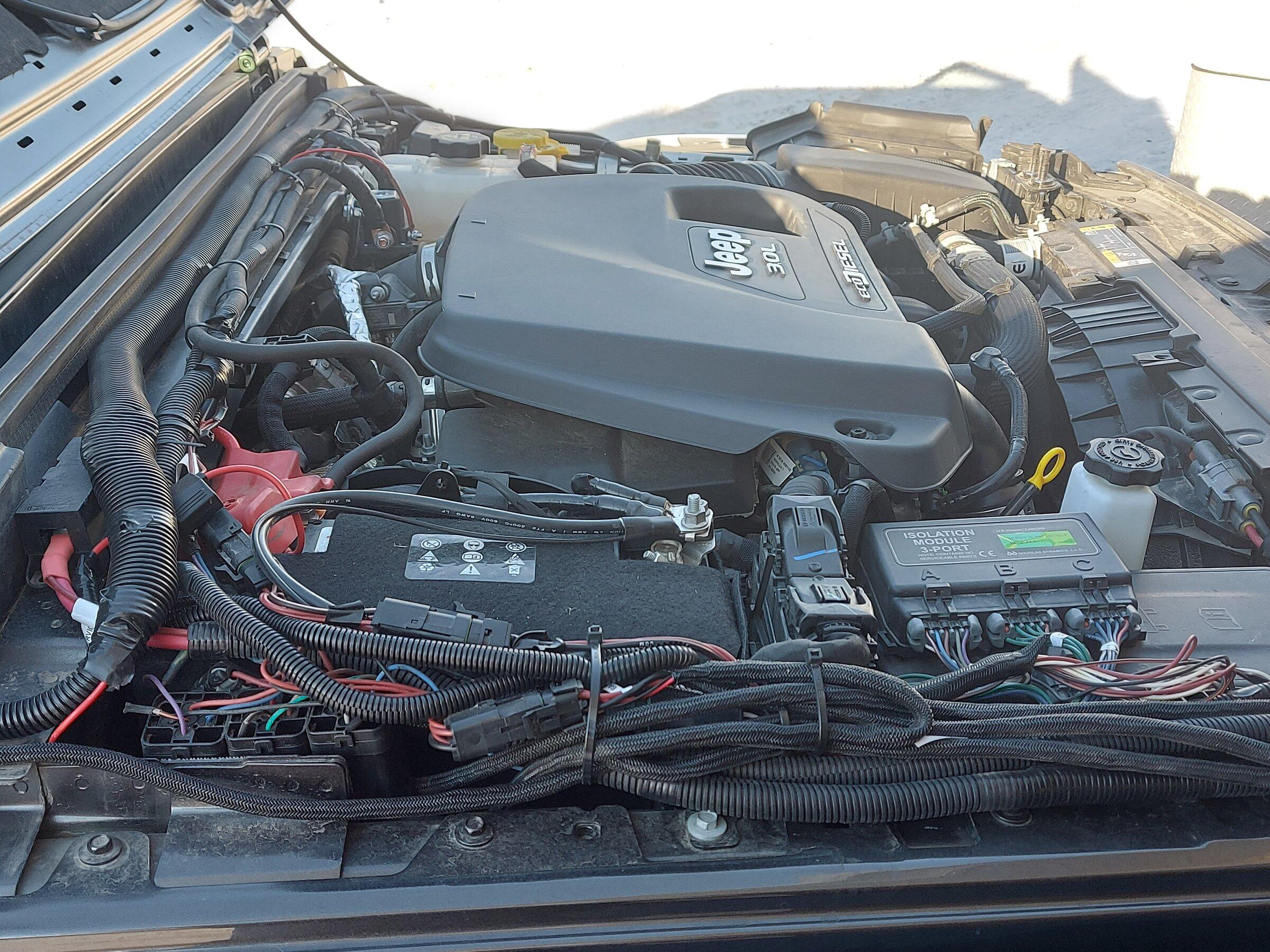

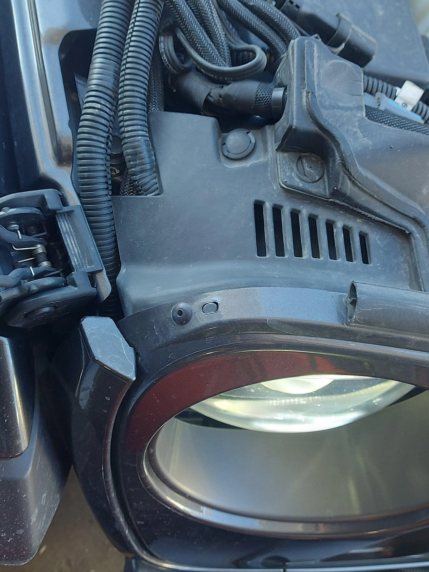

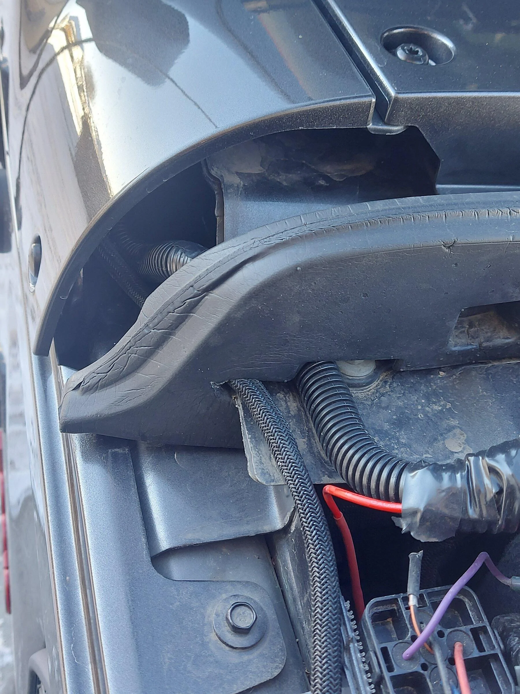

I'm pretty sure I went under the grill I will try and take some pictures
It's not pretty.. keep in mind that some of those wires are for the rear plow

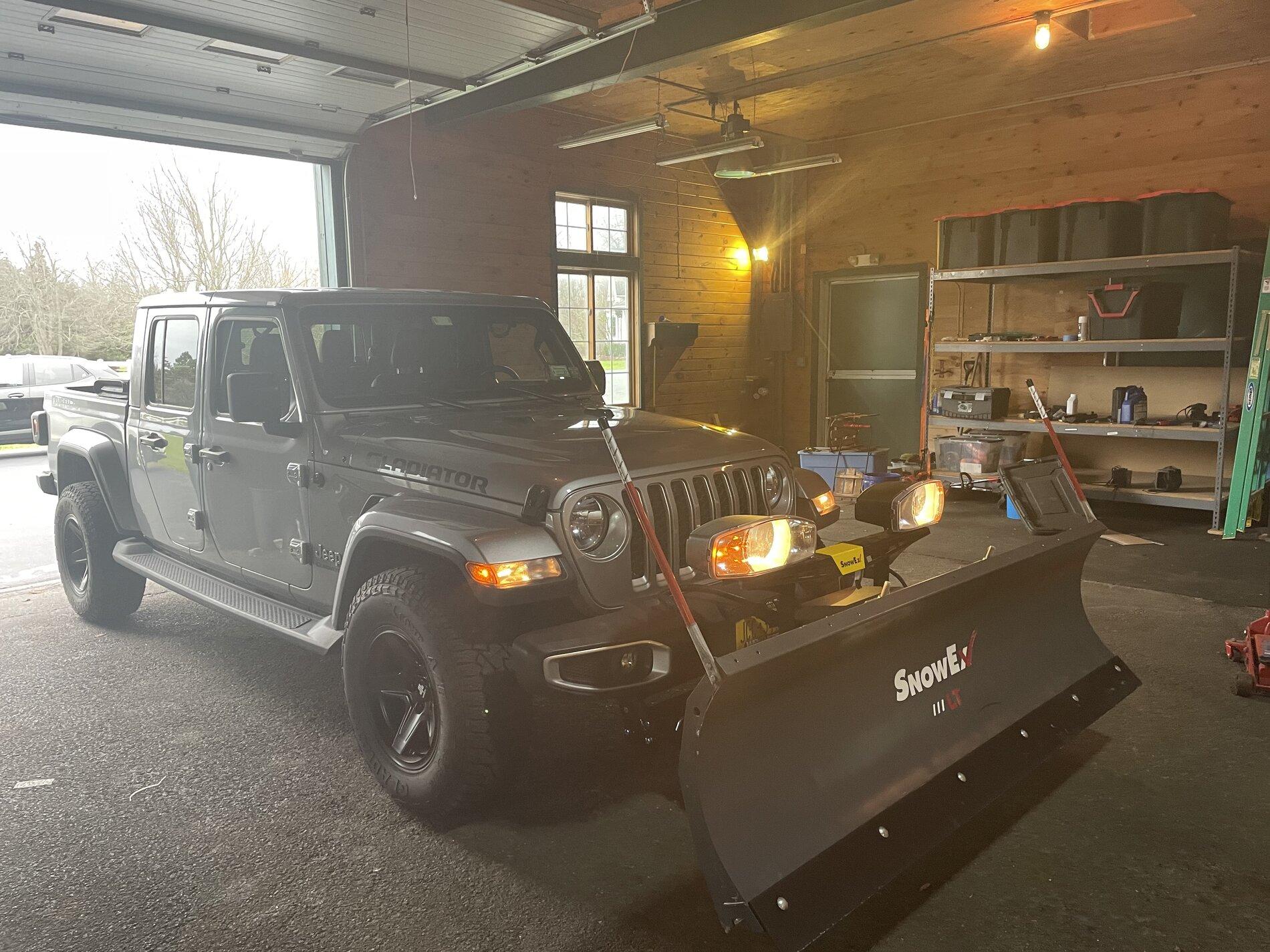

That is a lot of wiring! I wasn't able to start that portion yet, kinda wanted to see what you had done. So thanks for all the pics!
My previous JK I had installed a Snow Dogg. Pretty easy and way less wiring. The main problem was the wires were just barely long enough. If I hit a good enough snowdrift, I might knock the plugs apart. Finally had to rig up a clamp to hold thing together while I was hooked up.
Any issues splicing into the headlamp wires, etc? Any tips or tricks you learned?

I just had to splice the turn signals the rest is plug and play. It really isn't as bad as it looks I've done 3 now and I know what your going through. I got overwhelmed on this one as well until I got into it. The hardest part is running the lines.
