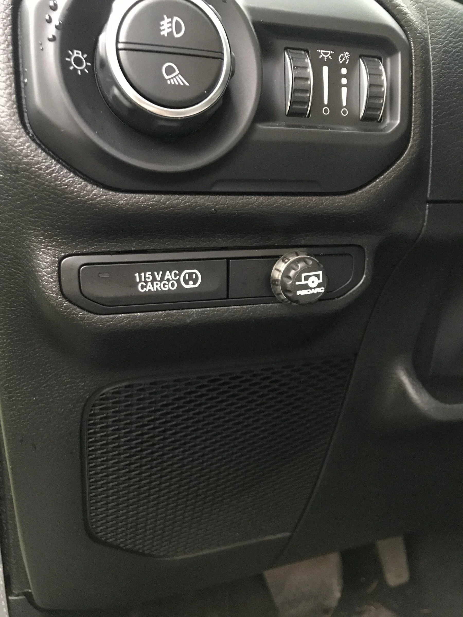

This project is costing more than what it’s worth, but I am determined to get this figured out. I bought a couple of the switches and started probing at one with a multimeter to determine what does what. Between that and the Mopar Connector Repair kit diagram, I got a good understanding of the circuit.
The switch appears to be a pressure sensitive switch, but with some circuit cuts, simple soldering and a little wiring, I was able to turn the switch into a momentary switch. Paired with this Momentary to Latching Switch Converter, used for making light sabers, I now have a functioning switch. The great thing about this switch converter is that it does have an LED indicator that I hook up to the LED on the switch, which turns on when you push the switch. A video below shows it in action. If anyone is interested, I can provide more info on what I did to the switch to make it work.

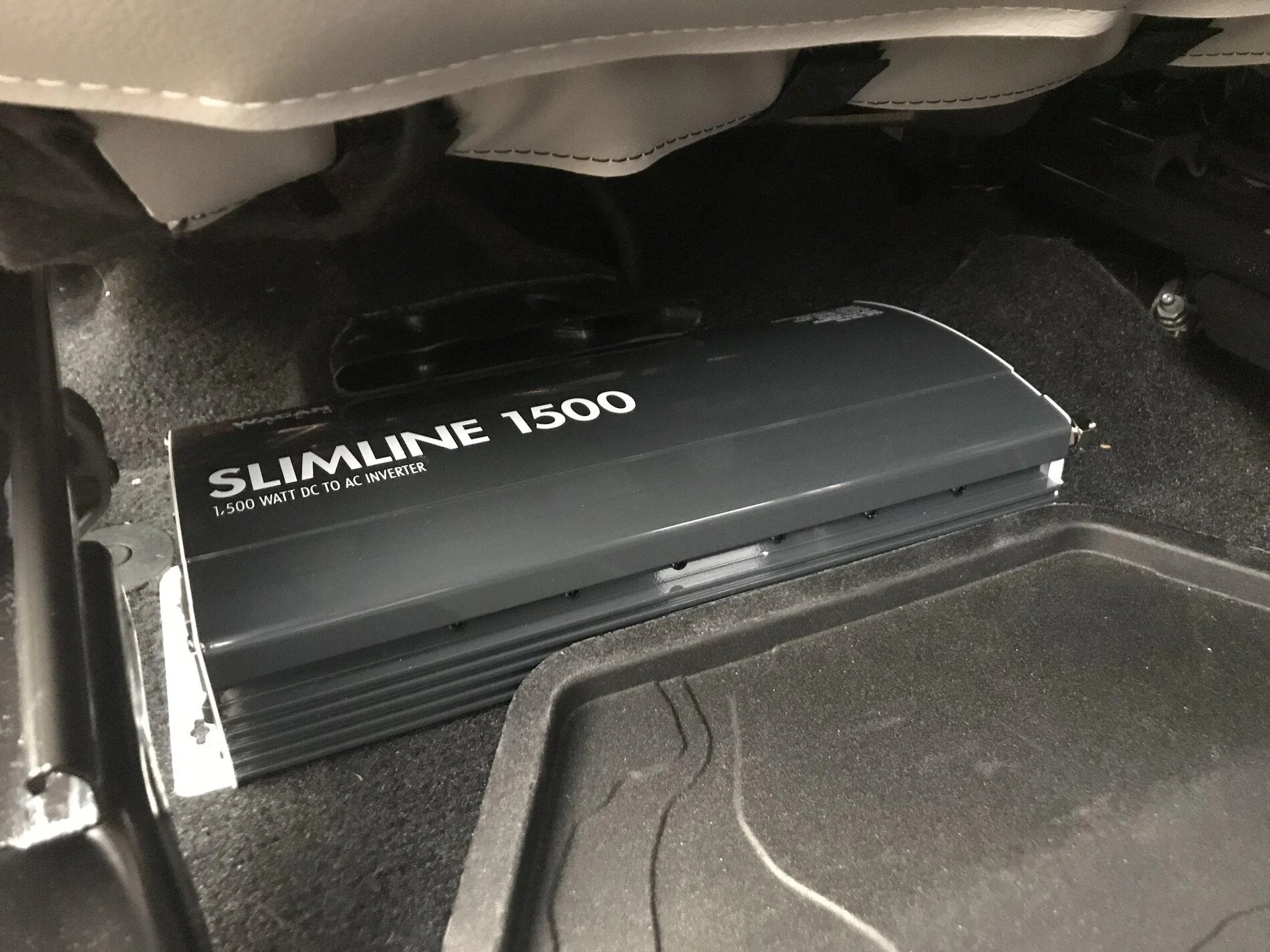

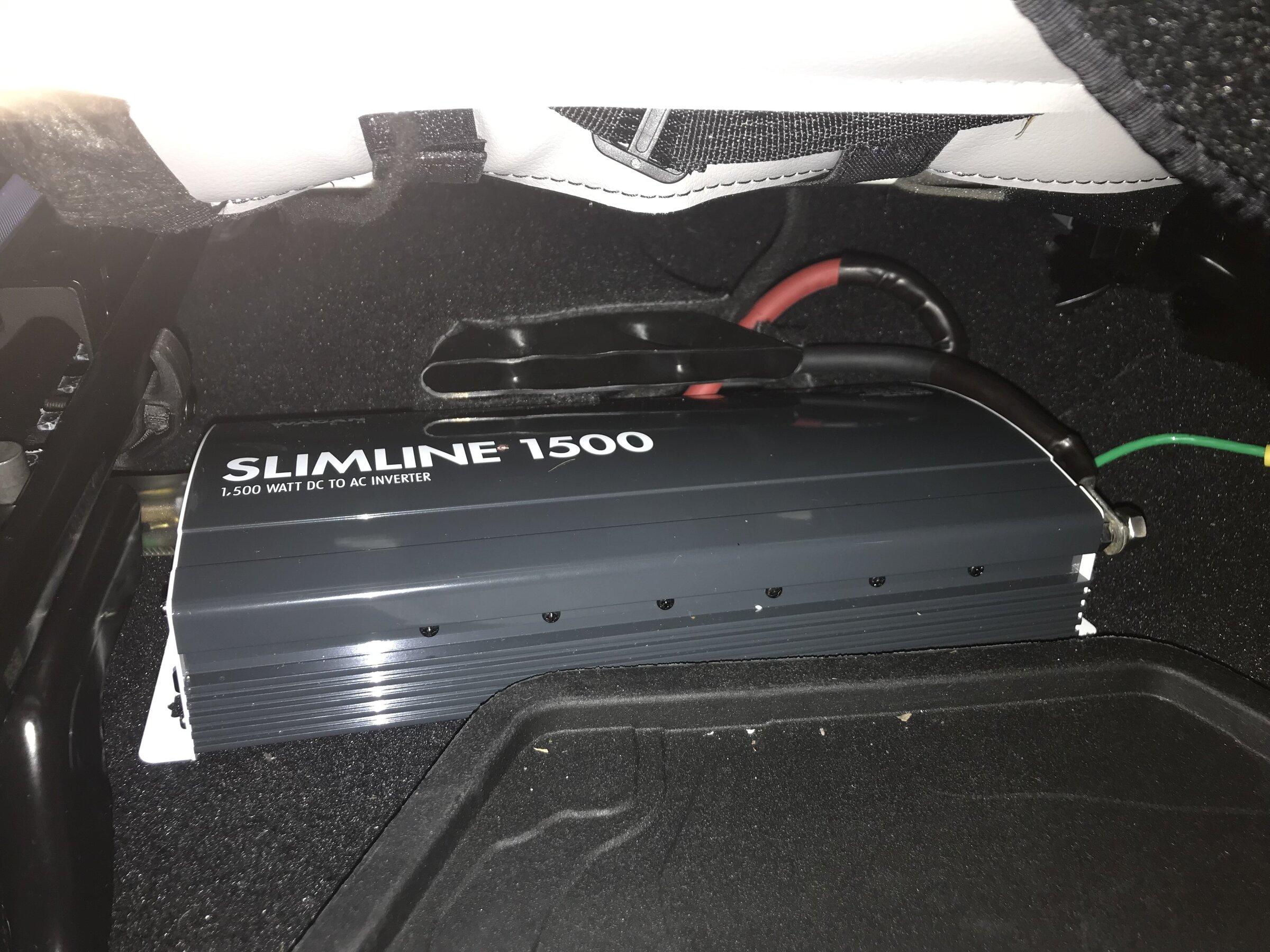

I am now waiting for the rest of my parts to come in. I plan on hooking this switch up to a 150a continuous duty solenoid, which will be activated by my latching switch. I plan on installing that in the driver side footwell. I will have 2 gauge cable going to the battery and inverter, with a large fuse on the battery side. I am using the Slimline 1500w inverter (can be found cheaper on other sites, and I now realize this is a modified sine wave inverter. I’ll use it until I can find a better alternative) which fits nicely underneath the drivers seat. That was the best location I could find, and it looks like there is even a factory stud under the seat by the center console that I might be able to use as a ground the inverter. The foot heat is a little flexible and will fit over it.

There are still quite a few steps, but figuring out the switch was the hardest part, with the rest of the steps installing everything in. I wanted a factory look, but didn’t want to tie into any modules for fear of ruining factory warranty. I’m hoping this is the best way. I am also using the blank switch on the right of the bed outlet switch as a place to install my redarc brake controller knob. Once I get parts installed, I’ll provide more details.

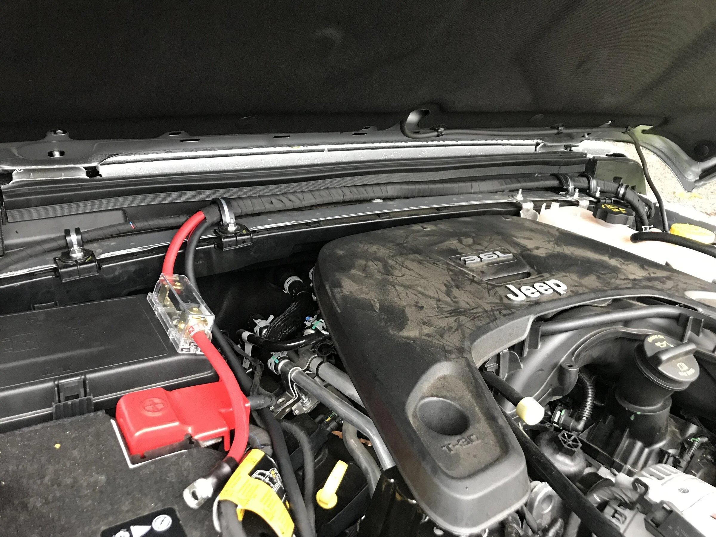

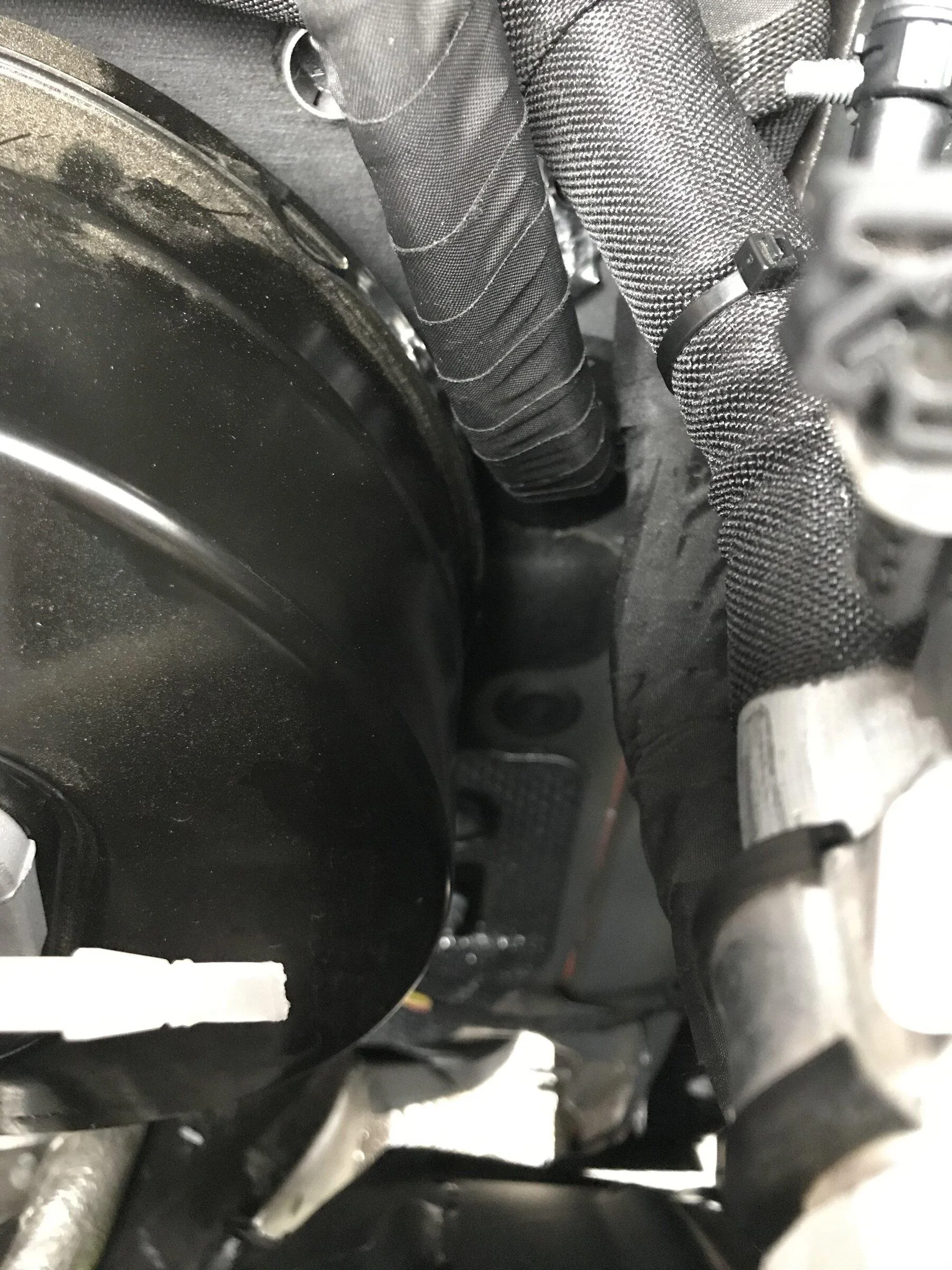

Doing research, I determined 2 gauge wire was the size needed to safely bring that power to the inverter, with a 200a fuse to the hot lead. I bought cloth tape to make the harness appear factory and wrapped the cords up (positive, negative, extension cord from inverter to outside). Along the firewall was a great place to mount the thick harness. I cut a 1 in hole into the clutch pedal plug, with a rubber grommet. Threading the harness through the grommet was difficult, but between dish soap and unwrapping electrical tape (like unraveling thread around a finger to remove a stuck ring), I was able to coax the grommet/plug to where I needed it to.

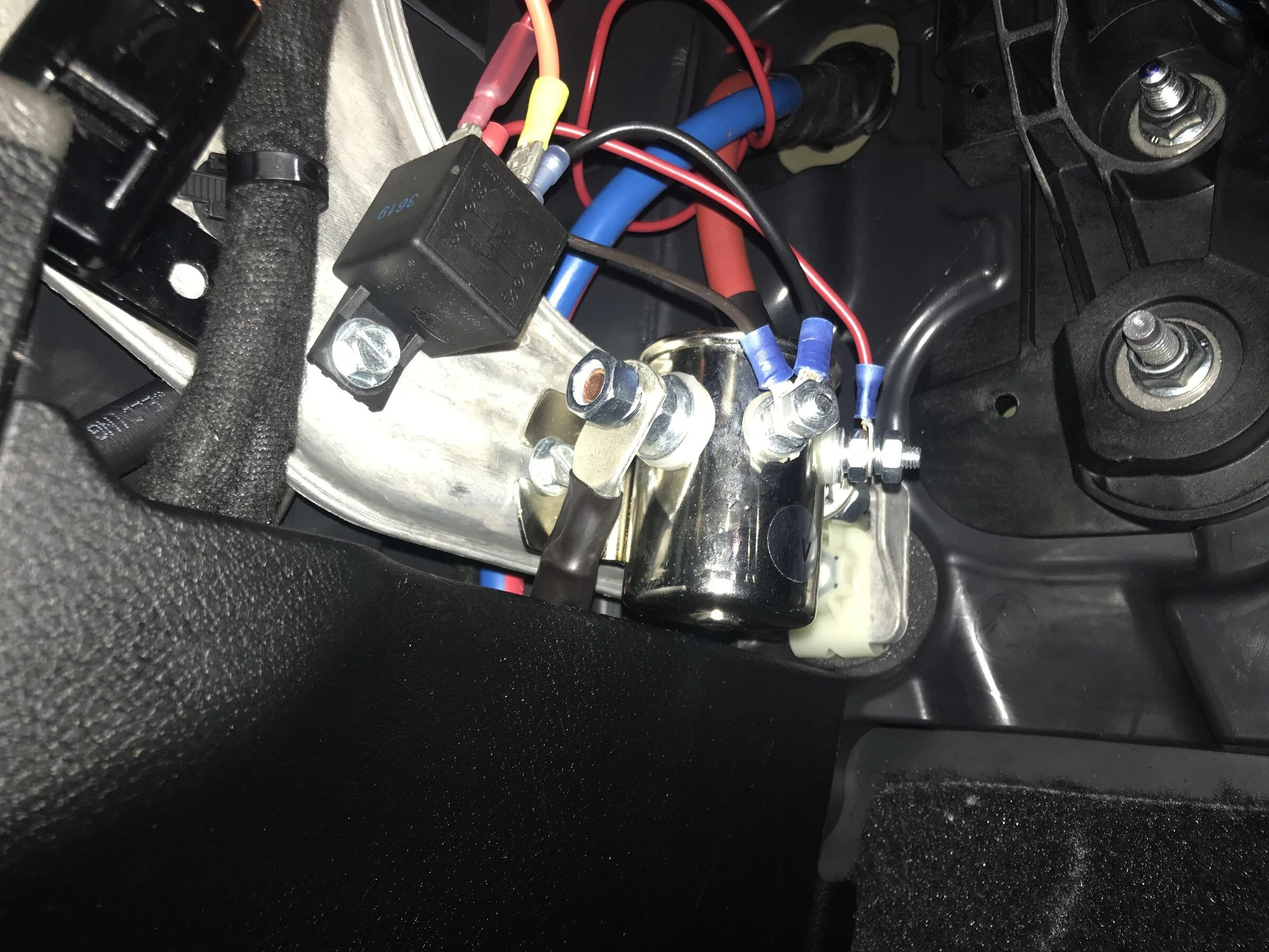

Inside the truck, the positive cable goes to a 300a continuous duty solenoid mounted in the kick panel area (please excuse my cable management). The factory switch I modified to be a momentary switch paired with a circuit card to make it latching controls a relay which turns on the continuous duty solenoid. This was to avoid too much amperage draw and burn up the latching circuit card. Both the relay and solenoid are only powered when the truck is on acc or on. The indicator LED for the switch does turn on, and the light for the switch text is tied into the the cigarette splitter harness bezel light I installed. It dims and turns on with the rest of the dash lights.

Finally, the cords are routed behind the kick panels until they get to the seat. I had just barely enough cable to make it to the inverter. The inverter is grounded to a ground under the seat. I have yet to hook everything up, but the solenoid does work, so it’s just a matter of hooking up the cables to the battery and to the bed outlet.
