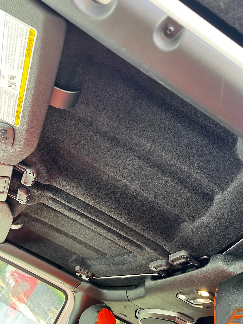

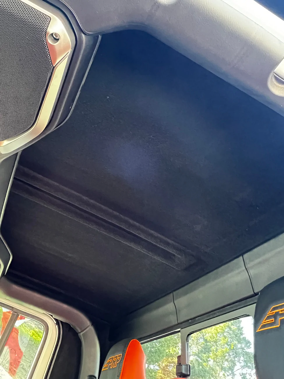

I've been very happy with my cover king. I installed mine a little different. I covered the panels with dynomat and then used gorilla spray headliner adhesive. The added weight from the dynomat was minimal. There was definitely a slight drop in wind noise. The echoing when talking inside has decreased greatly and the music sounds so much better!
If anyone is on the fence about this product I would suggest moving forward and installing it. You'll be happy with the results and it makes the interior more comfortable and look better as well.
Great job on the original post! It take a while to install and documenting it like you did is awesome.
The orange tape was in place for the adhesive overspread.
