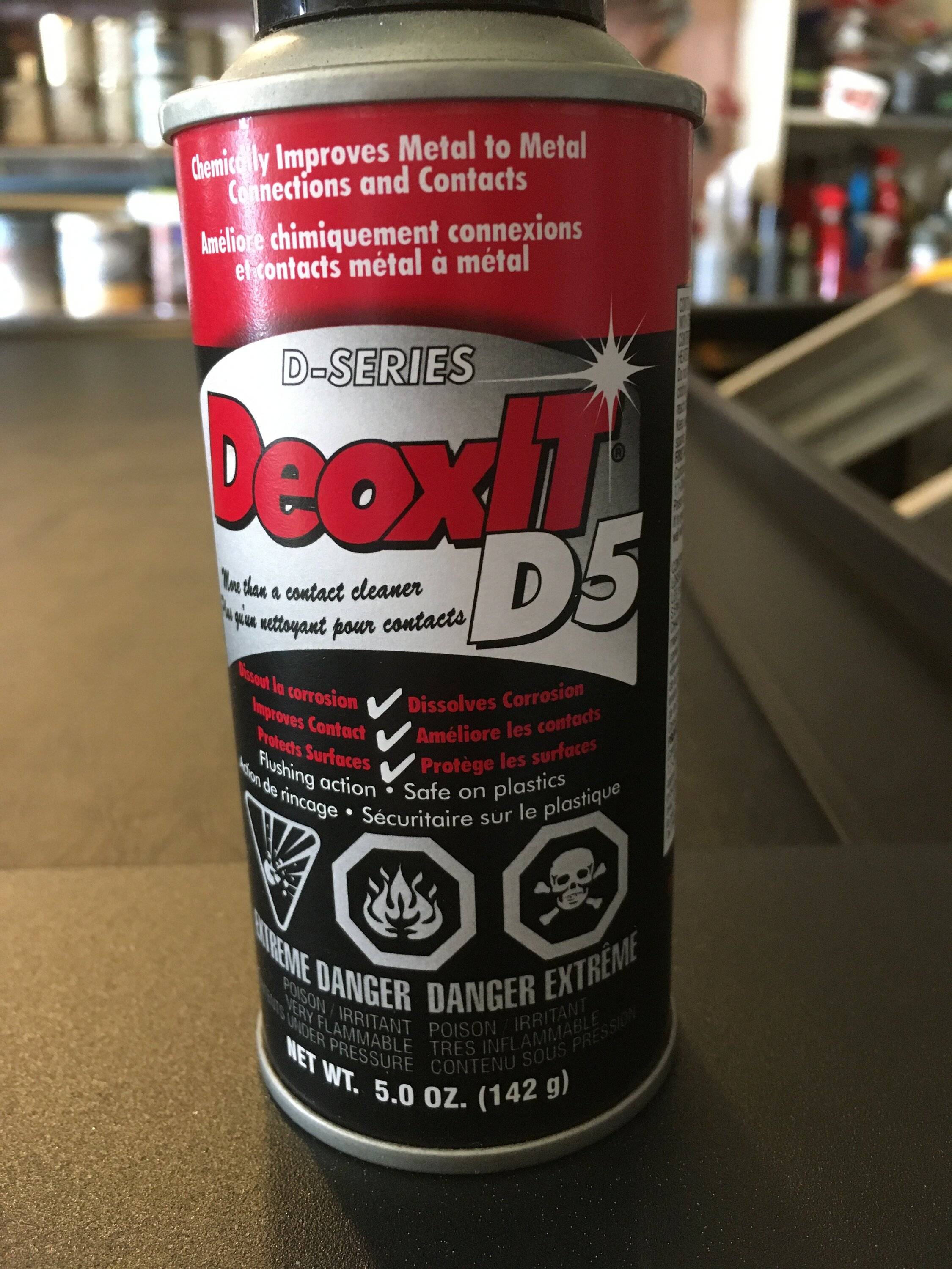

I would look at the fuse box. Take it off like you would do if going for the aux battery. Check all those connections and spray them with DeoxIT D5 contact cleaner. Also amazing stuff for your door harness connections too!
Reassemble and push down all your fuses too.
(If I was going to take the fuse box out to inspect, go a little further and check the aux battery, take it out and charge it up on an AGM charger. Put it all back and I’d bet you’d solve your problem.)
Thanks. I put a new aux battery in with the engine. What little I can find is that there is no fuse for the doors, but a self resetting circuit breaker. But I have no idea where it is located.
