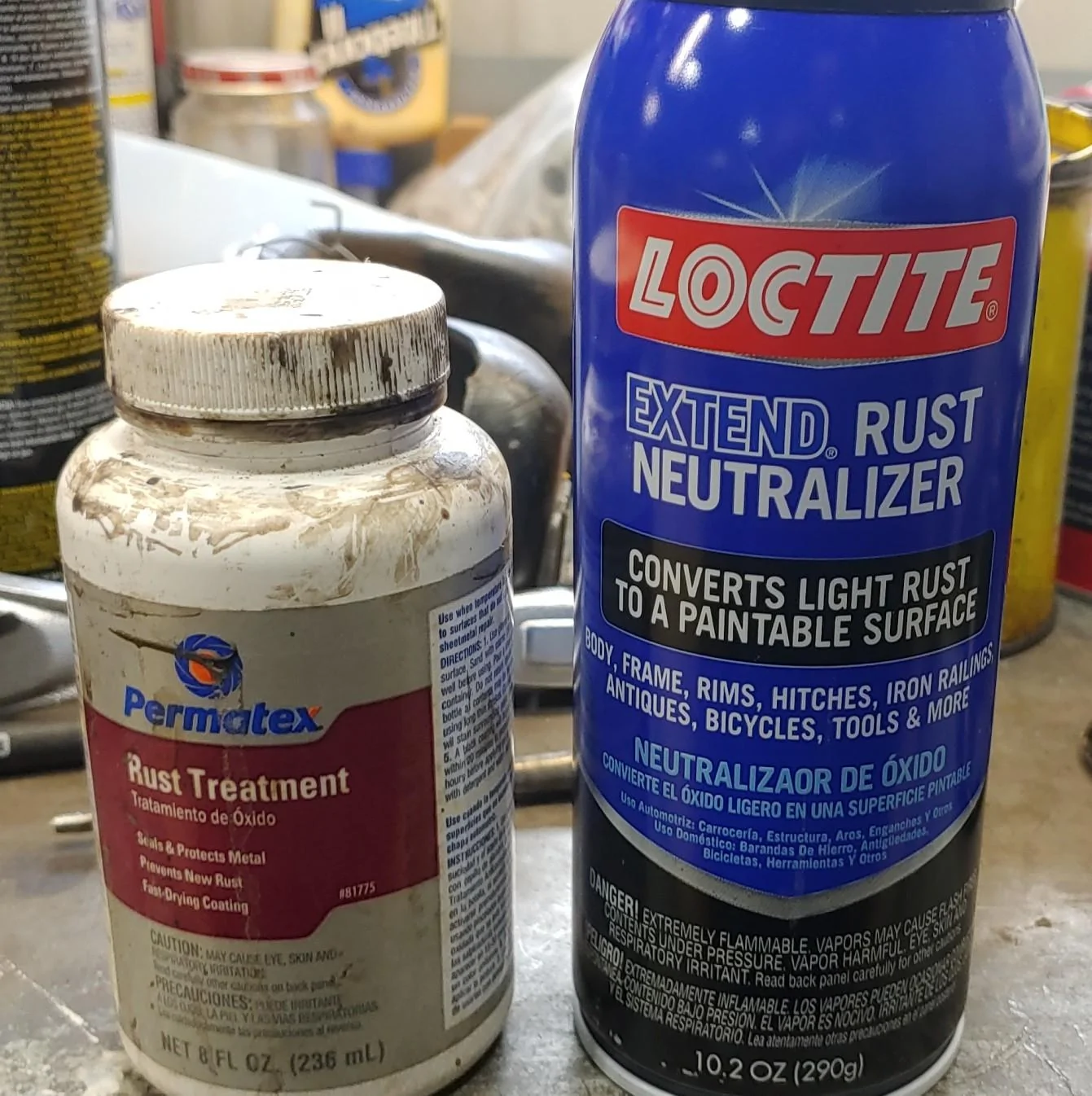

Anyone else look at their steering box after it’s been replaced? I was under my jeep the other day and noticed the “new” steering box was surface rusted pretty bad. I know it’s steel but still didn’t expect it after only a few months

Typical of most vehicles. They put on enough paint to protect during storage, shipping, or for shelf life on a warehouse shelf. They aren't painted for long-term.
During restoring multiple vehicles over the years, I learned of some of the processes involved - often, the part comes from assembly, and is simply sprayed with cheap black paint - no cleaning, no degreasing, nothing done to ensure the paint adheres or even has a minimal thickness.
Bare cast develops that "patina" really fast. It's actually protective.
If you want to keep it nicer, clean it off, brush off any loose stuff and spray it with this - it will convert the surface rust to a nice black/purplish inert material -
Jeep Gladiator Is anyone else’s steering worse after the steering box upgrade? 20210630_150536(1)
then wait 24 hours, then paint it.

thank you, I’ll definitely give it a try! Just can’t believe how bad it looks for such a newer vehicle. Makes sense though!
