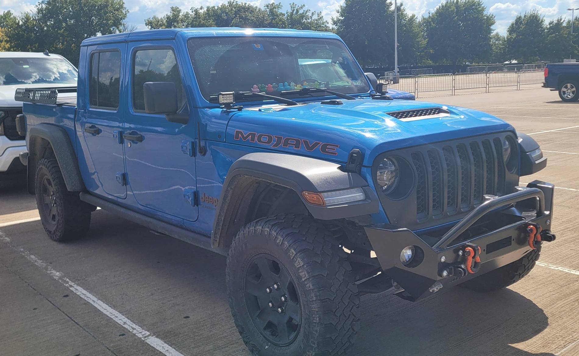

The Arcus is a great looking bumper but without the BlueOx specific hardware I wouldn't trust it. I ended up going with the Rock Hard 4x4 since I could bolt up the BlueOx connection points.
Older photo as I now have a winch in that gaping hole on top. You can see where I wired in the Trailer Lights just under the left shackle.

Why wouldn't you trust it? The Arcus attaches to the frame the same exact way every other bumper attaches. You can always add the bolts of your choice, if worried about those. I've got an Arcus and I see no difference in the way it attaches to the frame than the stock bumper or any other bumper I've seen, for that matter. Unless I'm missing something with the flat tow hardware.

I'm not saying it can't be done. But if OP was going to just purchase the BlueOx hardware from Rock Hard 4x4 and then try to put them on the face of the bumper at the end of the frame rails the cool looking protruding hooks from the Arcus would be in the way or would not be installed and then there is the bulge in the metal right in between both mounting points. The BlueOx hardware would have to be installed with spacers to clear that and it would look like an afterthought IMO.
