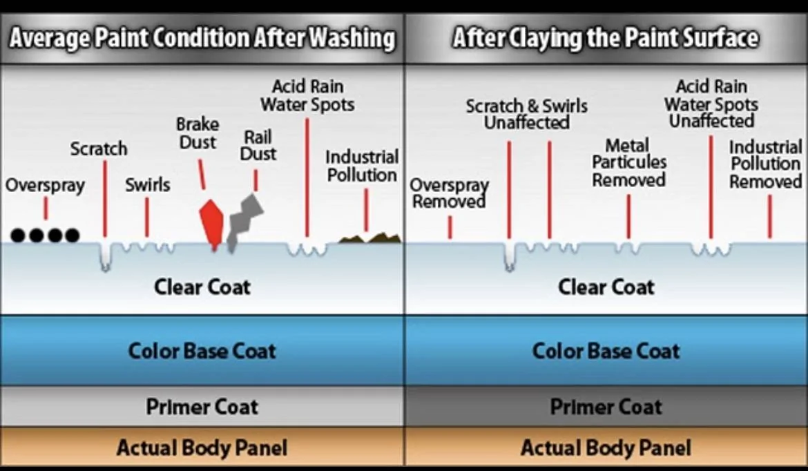

There are many kinds of coatings today, vehicles are overall getting more expensive, so cost savings are taken where ever they can be and the coating is one area however there are ways to correct paint and protect it.
1)use a two bucket system with dirt traps and only move in forward and back or side to side motions when hand washing
2) only use touch less car washes the brushes will damage the paint
3) clay bar used properly will remove other contaminants
4) coat and seal the vehicle with quality products on the regular
I do the work mostly for corrosion prevention, I take it off road and it gets All kinds of Mother Nature over it, eventually I’ll have paint damage I can’t fix for me not an issue, when it finally gets bad I’m gonna raptor coat it and just pressure was only
to each his own how you use your vehicle but preventative maintenance and some elbow grease goes a long way.
