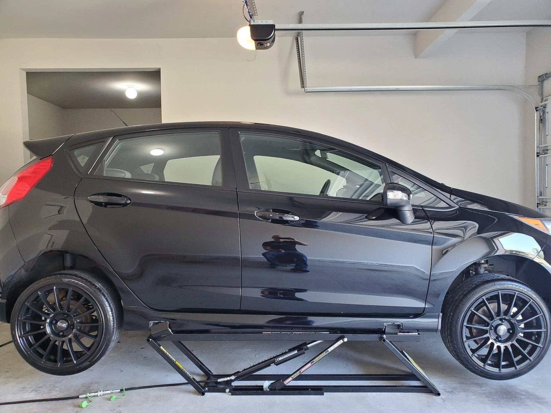

The first time I decided to apply CSL myself was on the Fiesta. I washed it, washed it with decon soap, used the Nanoscrub, dried it, put it up on the QuickJack and then went to work correcting the paint.
Did a full 2 stage correction. I bought the car new and it's a 2017. It had sat for months on different lots, been washed by brushes from mobile detailers, and the paint was absolutely trashed. I knew this when I bought it.
Once the correction was finished, I went over the panels with Eraser to degrease and remove any polish residue and then went to work with CSL. Did my first area on the passenger side rear door. Apply, wait for it to cure, remove. Checked my work and then went over the remainder of the car. Apply, cute, remove.
When I finally finished I grabbed a light and that's when I realized. Not all of the coating was coming off. It has cured out in streaks all over the car. Under the glow of an LED flashlight it looked like absolute trash. Didn't even bother with the Exo.
The only way to remove the coating is to compound it off. So I had to go over the entire car again.

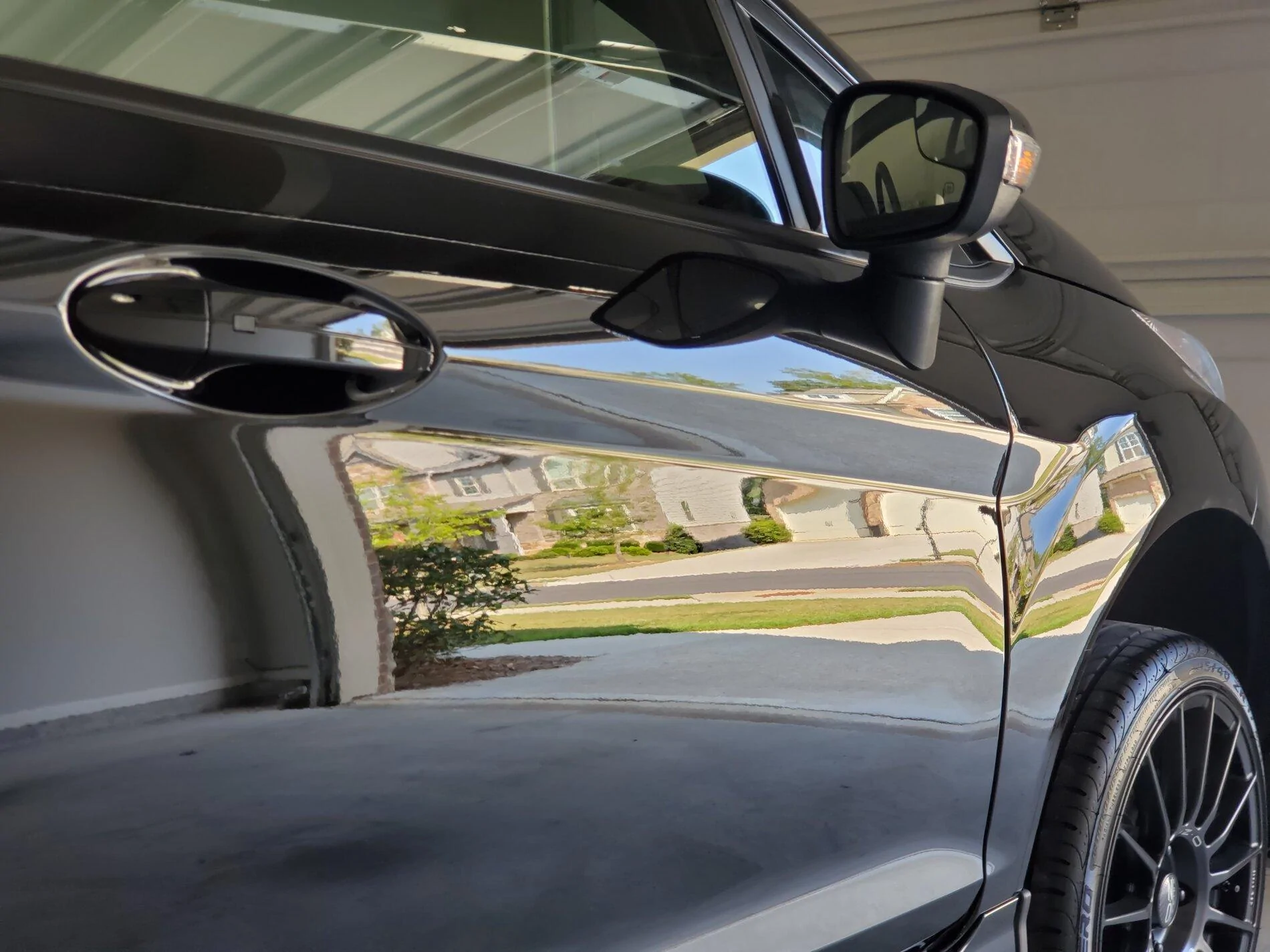

This is my Fiesta ST when I finished the full process. One coat of CSL topped with one coat of EXO. Wheels are done with C5 Wheel Armor.

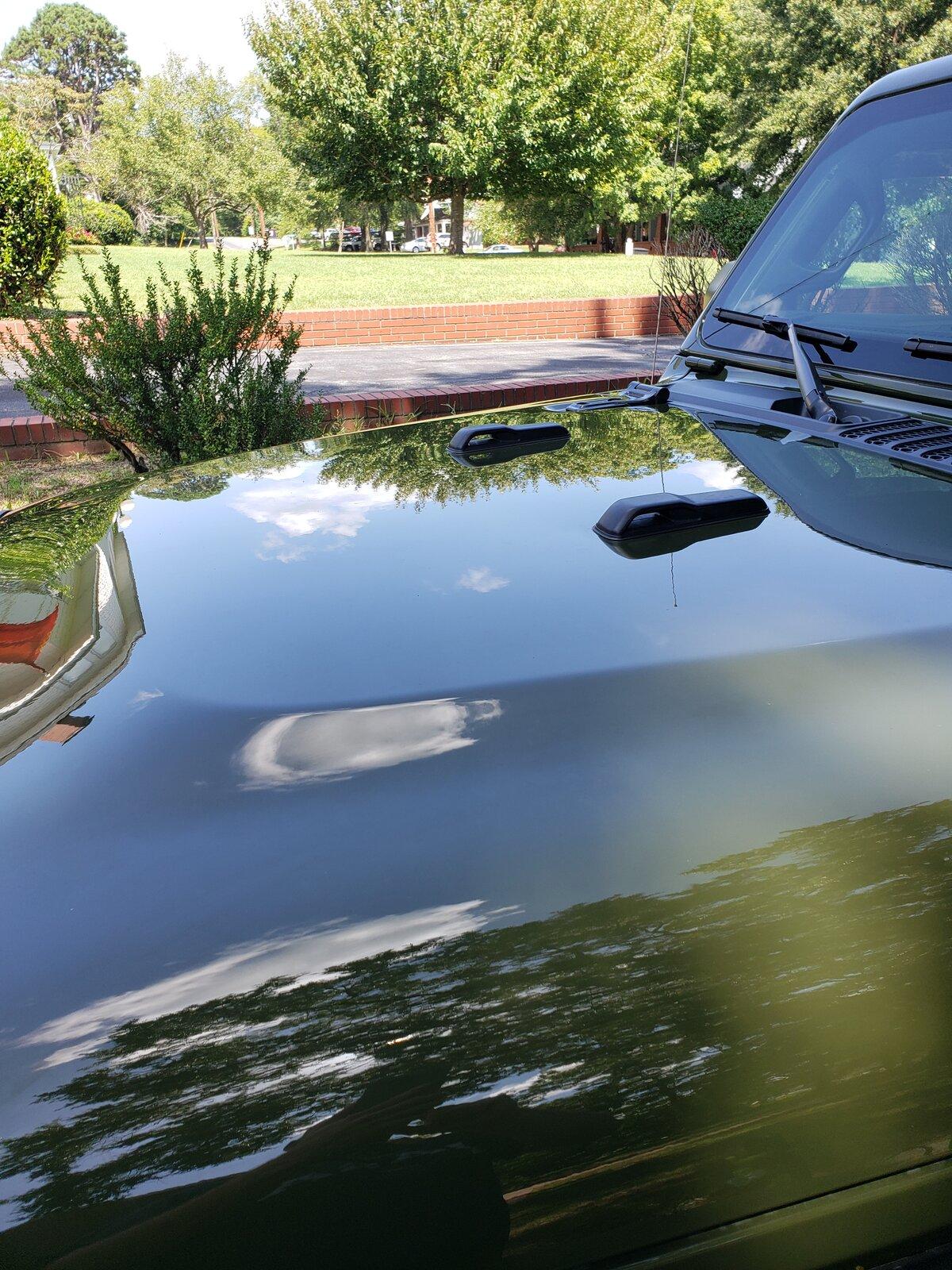

Jeep Gladiator 5 Year Ceramic Coat 20190919_154432
Jeep Gladiator 5 Year Ceramic Coat 20190919_154438
Jeep Gladiator 5 Year Ceramic Coat 20190919_154457
