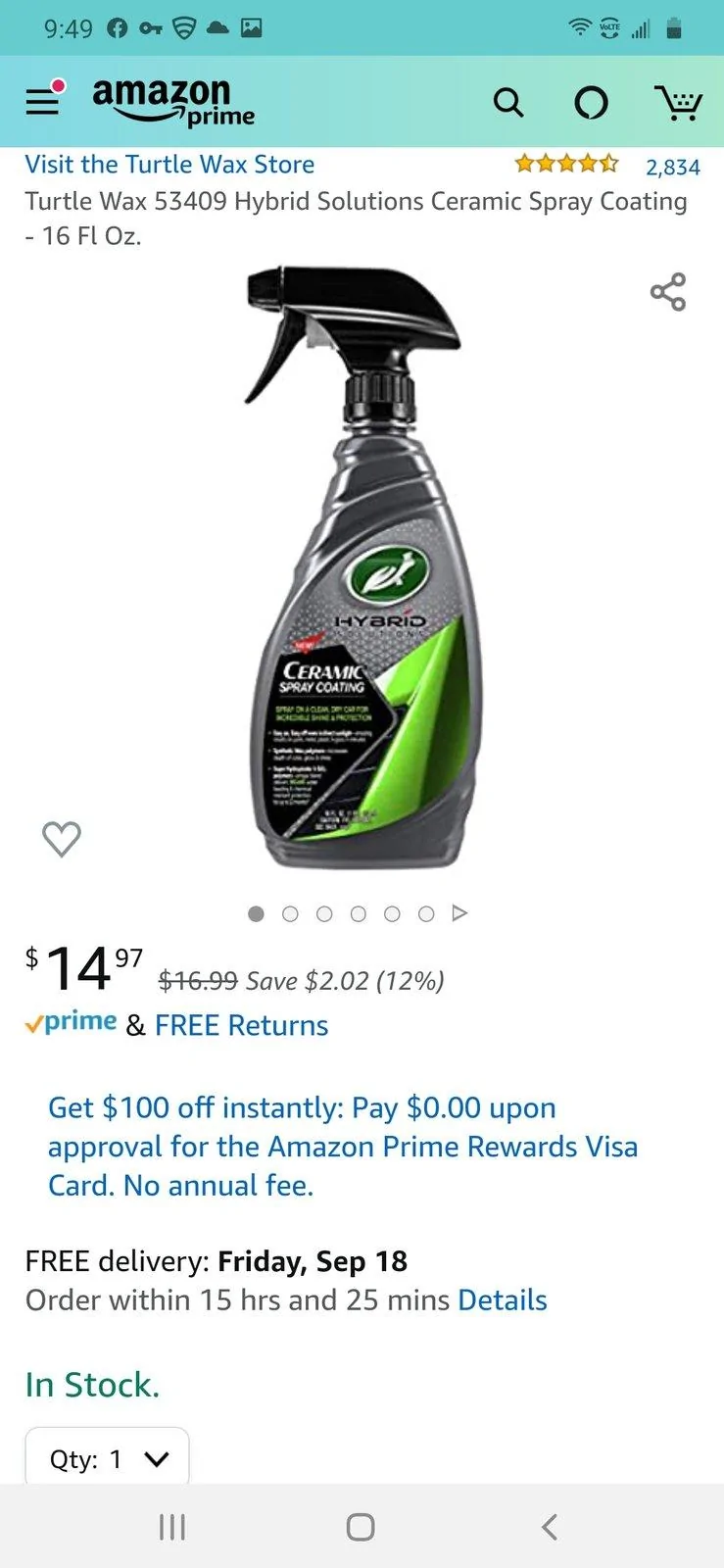

I use this. Apply to clean vehicle, wait 24 hours. Apply 2nd coat. Supposedly lasts a year. You can also use it on the plastic parts, and even the windows. It's certainly easier to clean now.
Jeep Gladiator Ceramic Coating Screenshot_20200916-214925_Amazon Shopping
