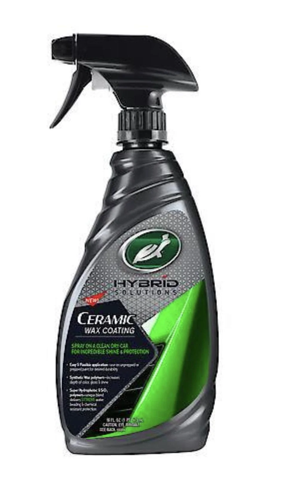

Thoroughly pleased with this stuff! It turned out incredible. I had used Chemical Brothers and wasn’t very happy with it. Just a couple of sprays per panel and at $15.99 it will last a while.
