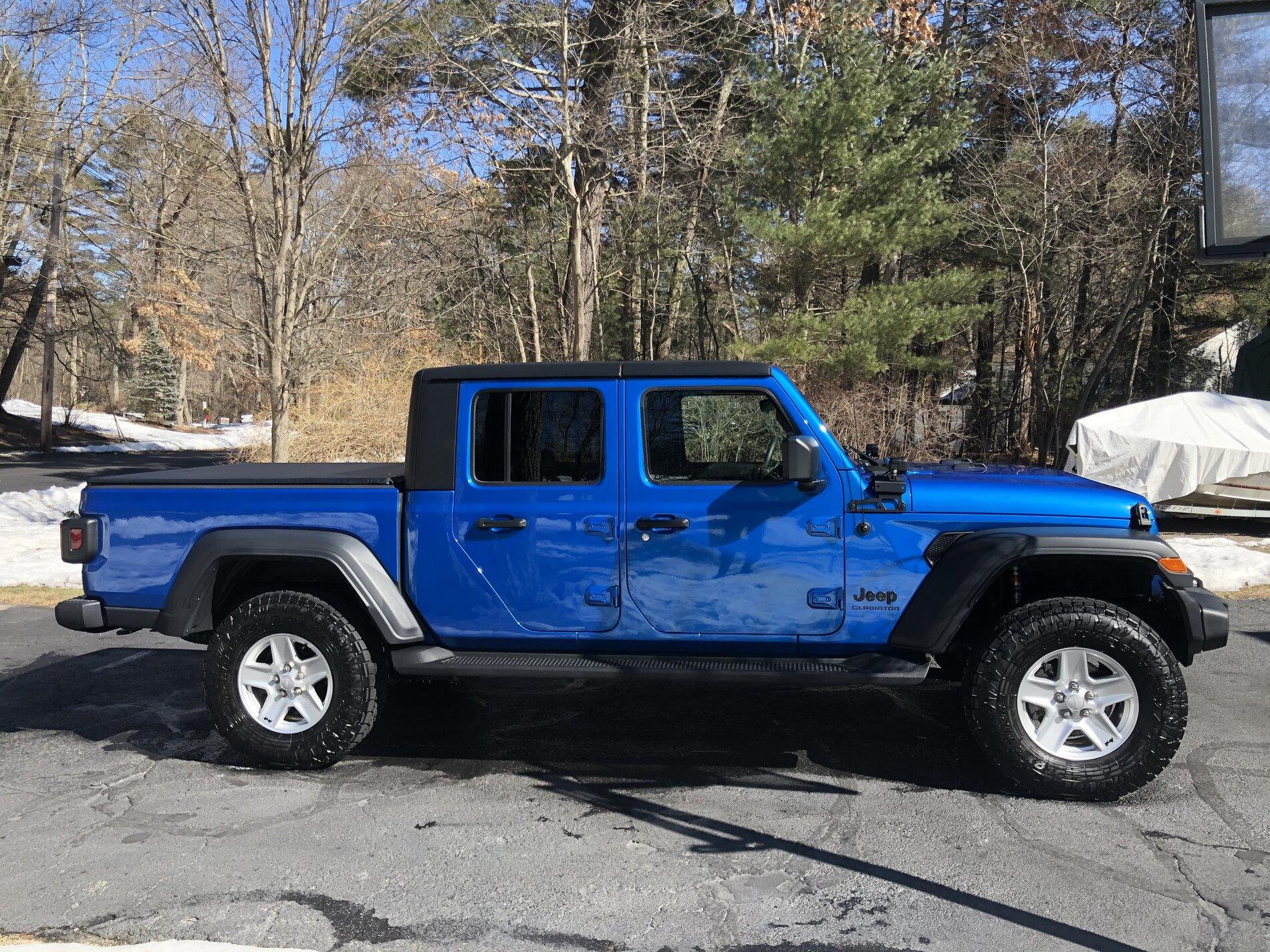

I used the Turtle hybrid ceramic coating last fall, very easy to apply. Washed it for the second time the other day, looks perfect. Very good reviews and tests on YouTube as well.
Jeep Gladiator Ceramic Coating C96F6CC0-B2B6-43B8-955E-D86272AA0D2E

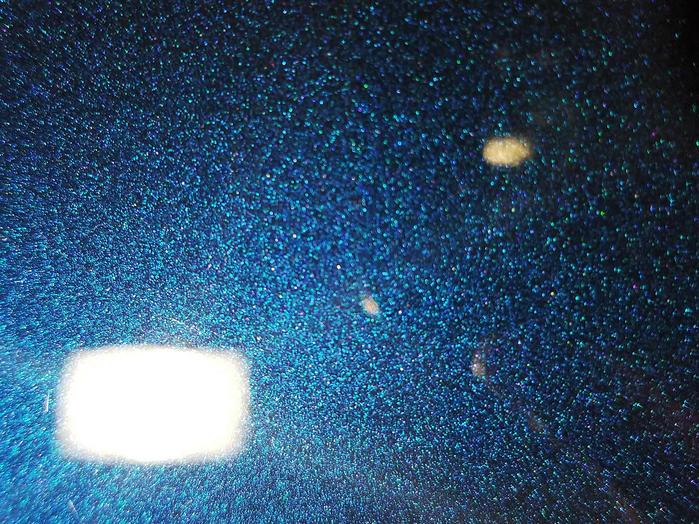

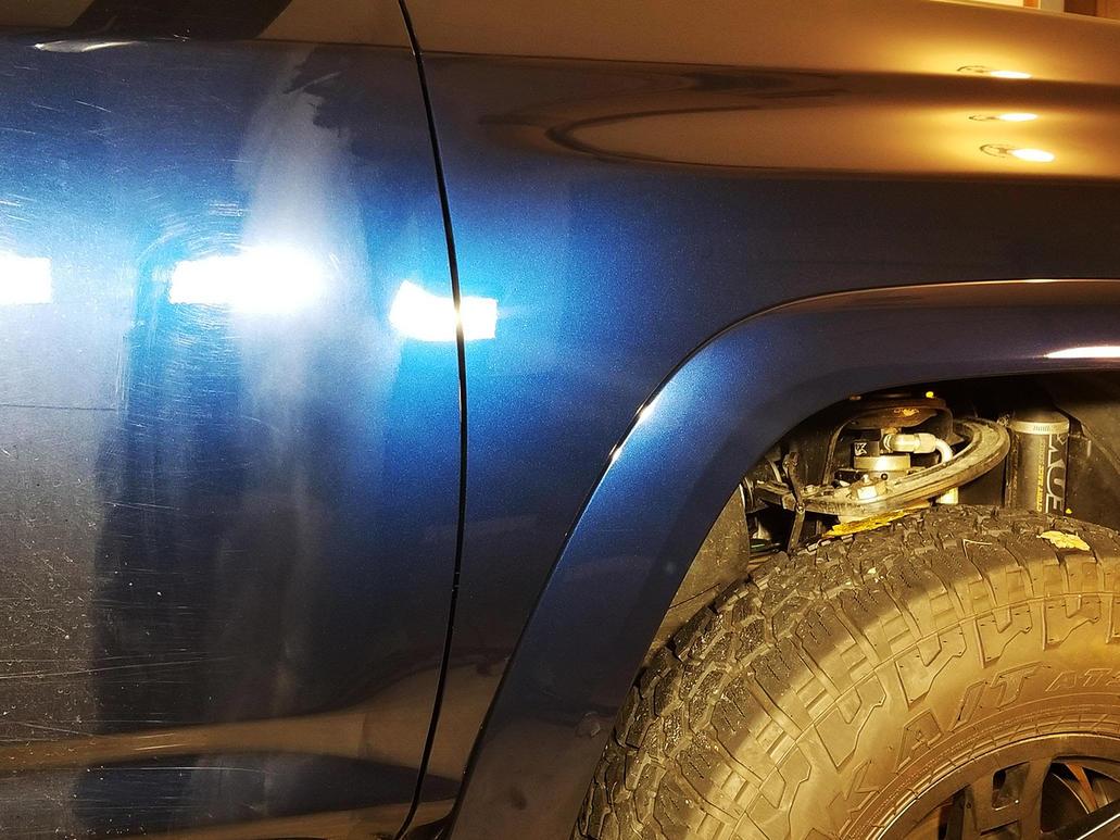

On the 4Runner, before and after DIY correction w/ ceramic on a single panel. This predated UK 3.0, this was regular. After correction I found colors in the paint that I didn't know existed.
Jeep Gladiator Ceramic Coating before-after
Jeep Gladiator Ceramic Coating color
