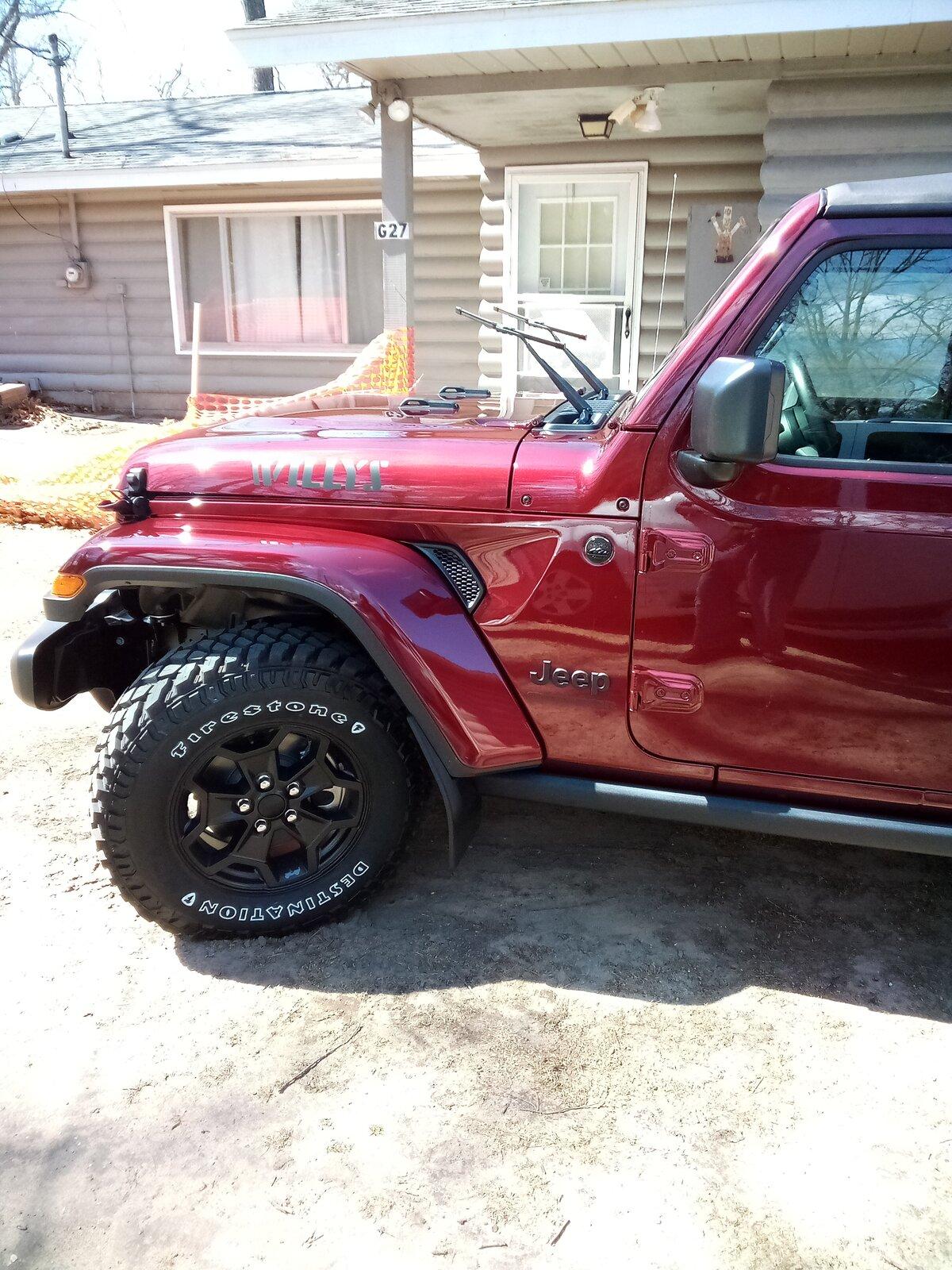

I did mine last weekend. It didn't need any real correction, at a year old. I did a medium grit synthetic clay mitt, alcohol mix, and then ceramic. Came out perfect. Going to be doing our Tesla soon and that one will need some minor/spot paint correct, then the same process. Works great on the tops and glass too, the windshield and headlights seem extra clear.

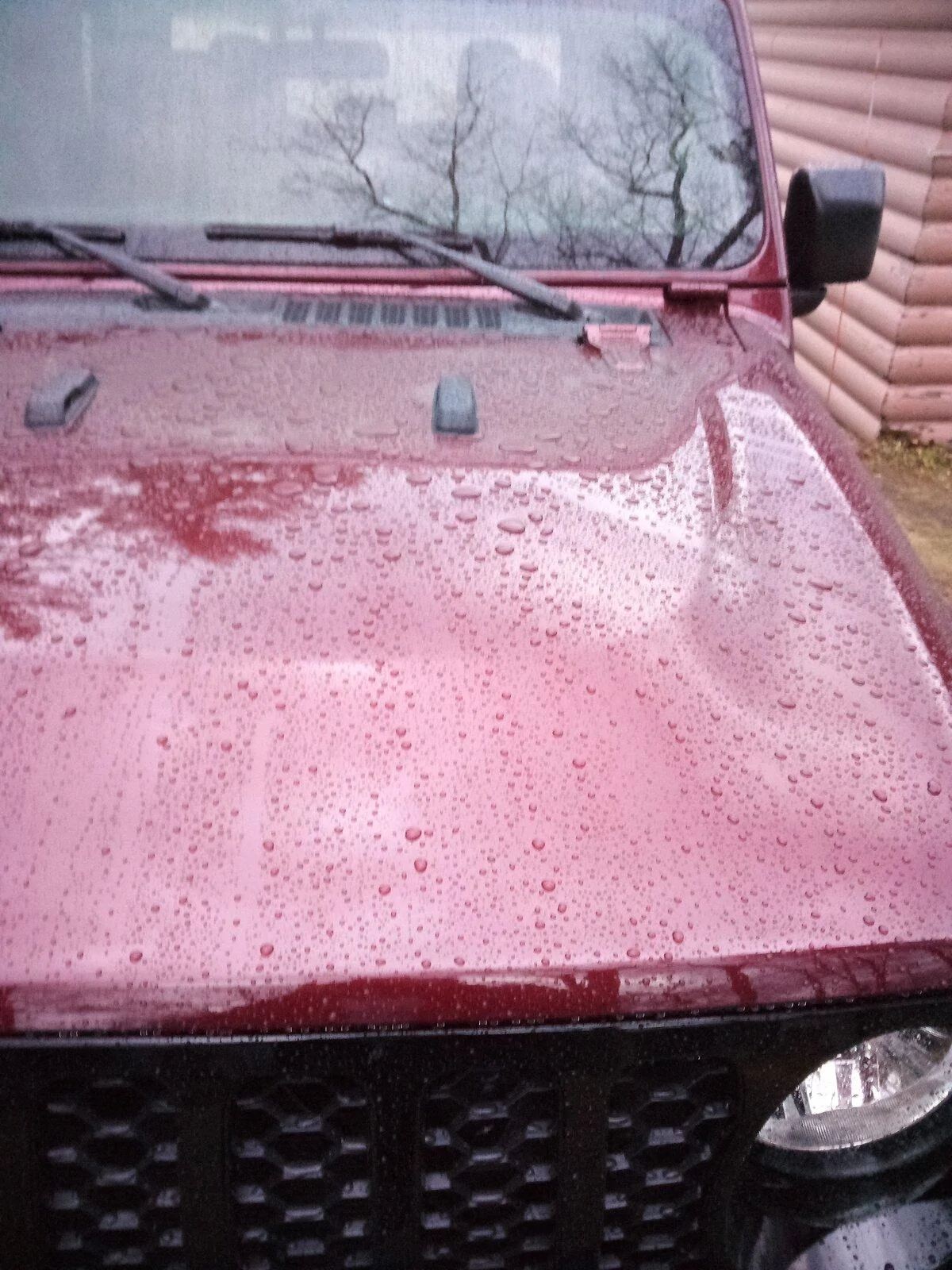

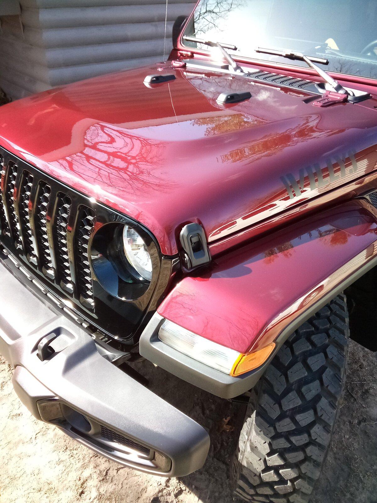

Did the turtle wax ceramic 2 coats myself , pretty happy with results & reviews on the product

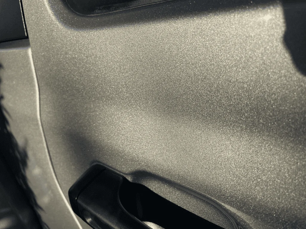

I had mine coated and a clear bra.
