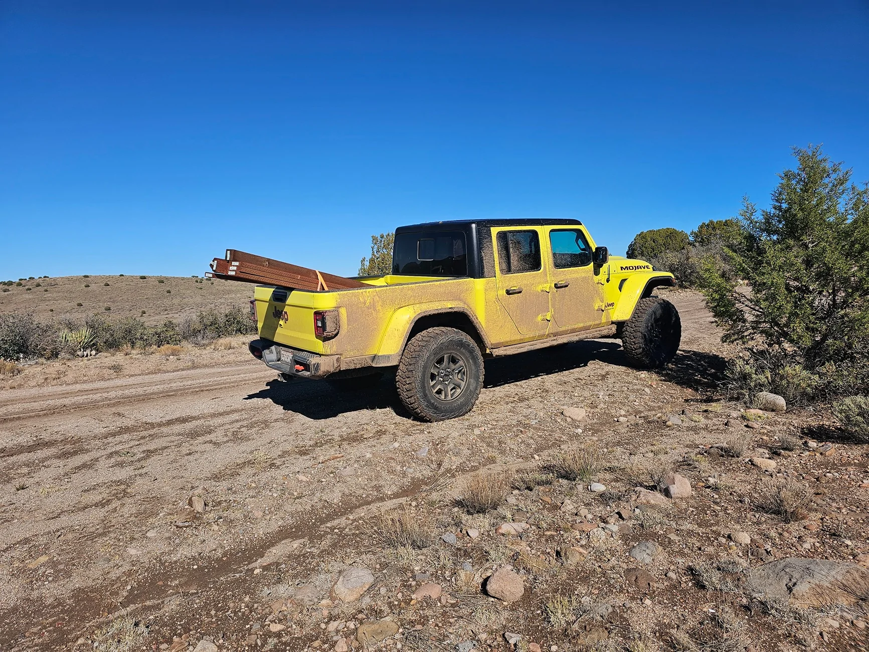

1,800lbs of pavers with no issues.
Jeep Gladiator Is the payload under rated 20251124_124516
