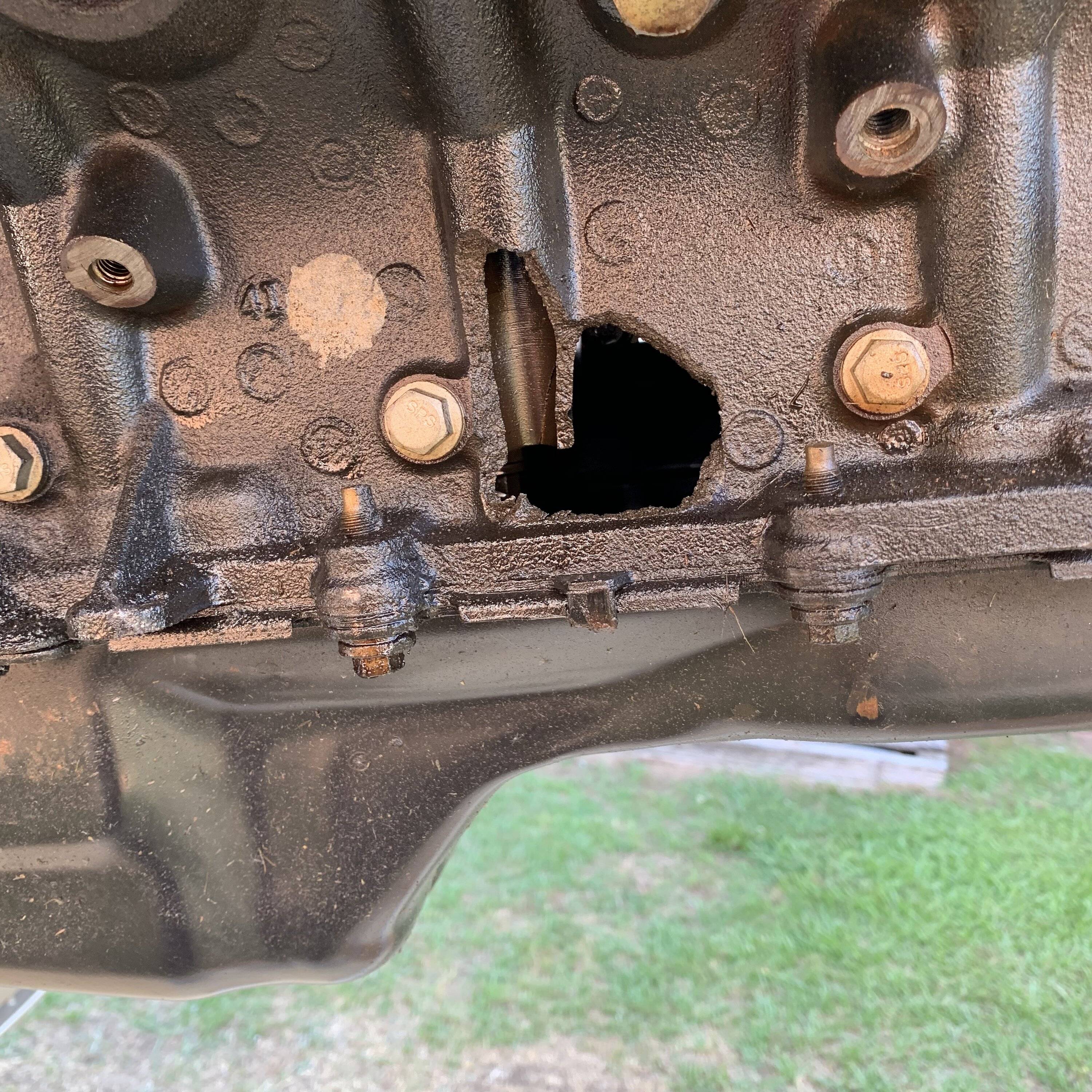

My daughter is like that. She bought an extra Crown Vic from me a few years ago, and I tried to emphasise the fact that, at least once a week, to check oil and fluids, and I would check out anything low or leaky. It was a low mileage car, about 90,000 miles on it. A few months later, she called wanting to know if she could have it towed to my house, so I could figure it out. First thing I did was check the fluids. Yep, no oil. Seems she had somehow hung an oil cooler line, and it was leaking it out every time she drove it. I asked her when the last time she checked the oil level was, it was when I had checked it when she was visiting us about a month before. This is why it stopped running:

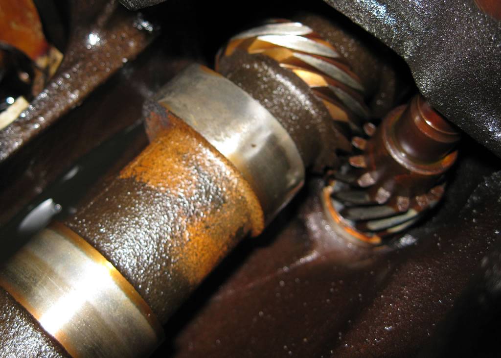

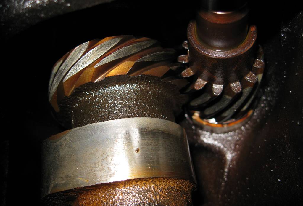

The oil that came out of this 100,000 miles 1994 4.0 was like that - black sludge.
I thought maybe they goofed and put crude in it instead of refined oil.
It ran, but it wouldn't have for much longer.........
hard to tell from the pics but some of those teeth were missing roughly 1/4 of their thickness.
Sad because as a 4.0, it could have gone another 100,000 easily.
And it will, now in my car.

But that Jeep 4.0 is in a car.
