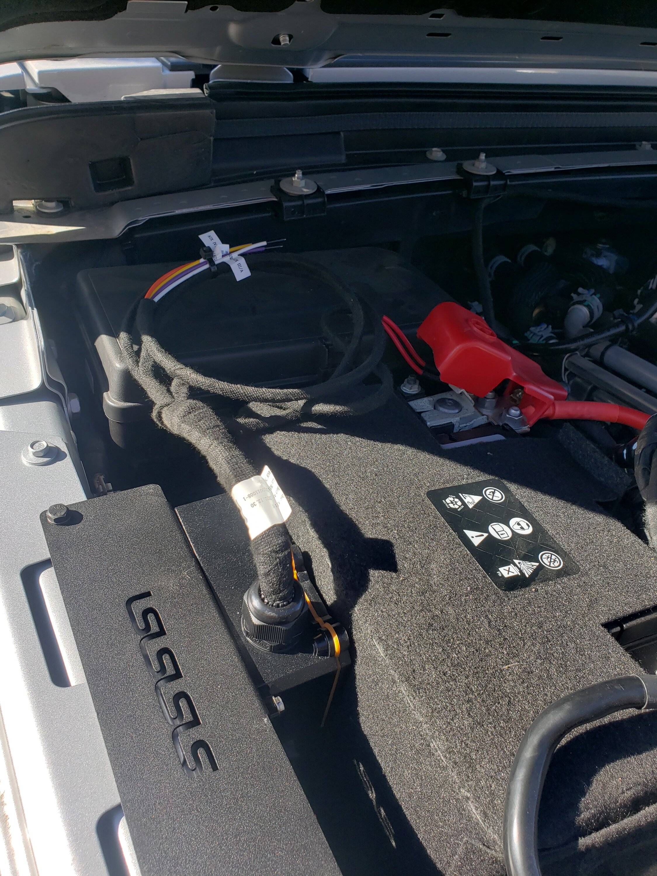

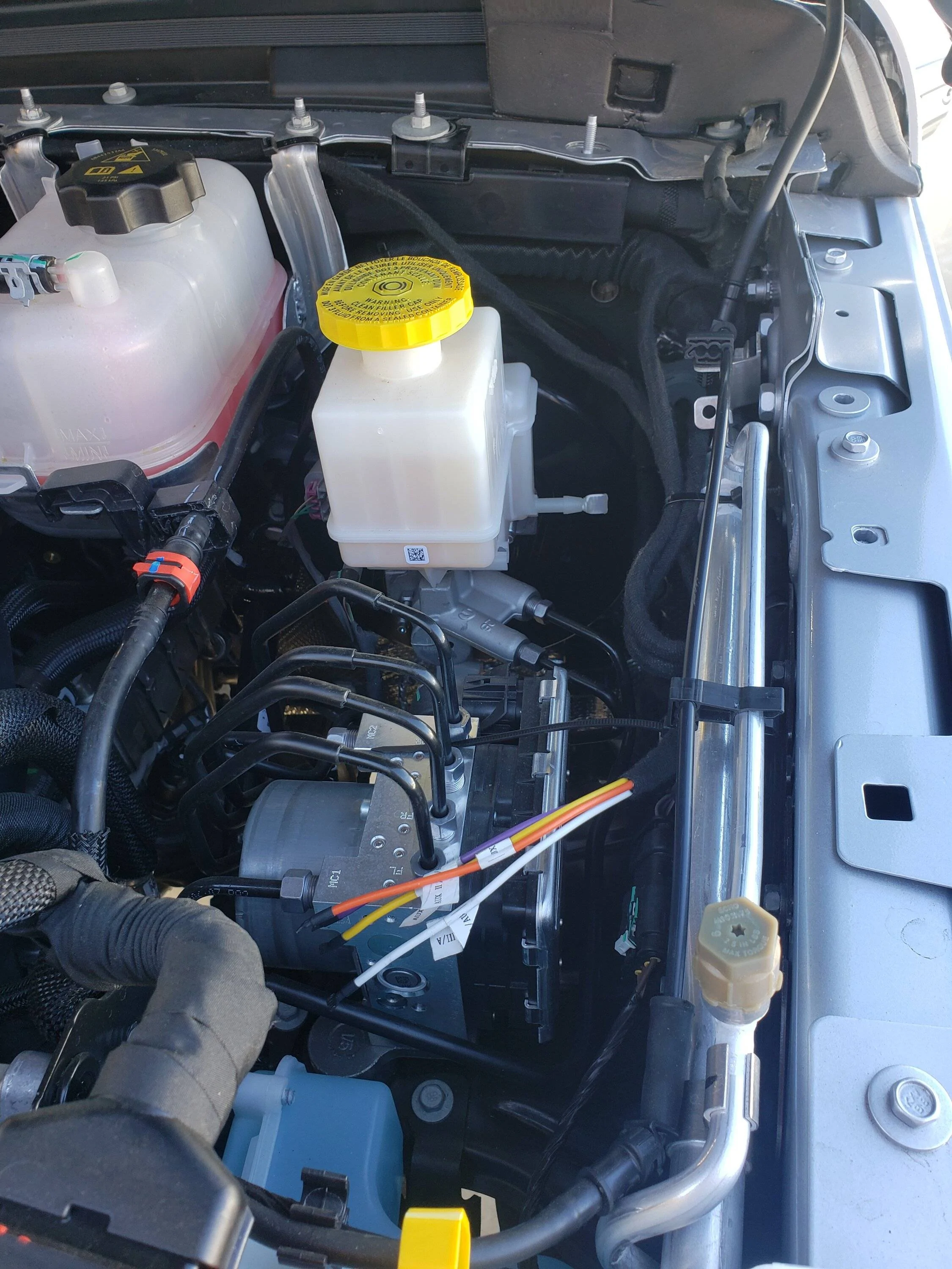

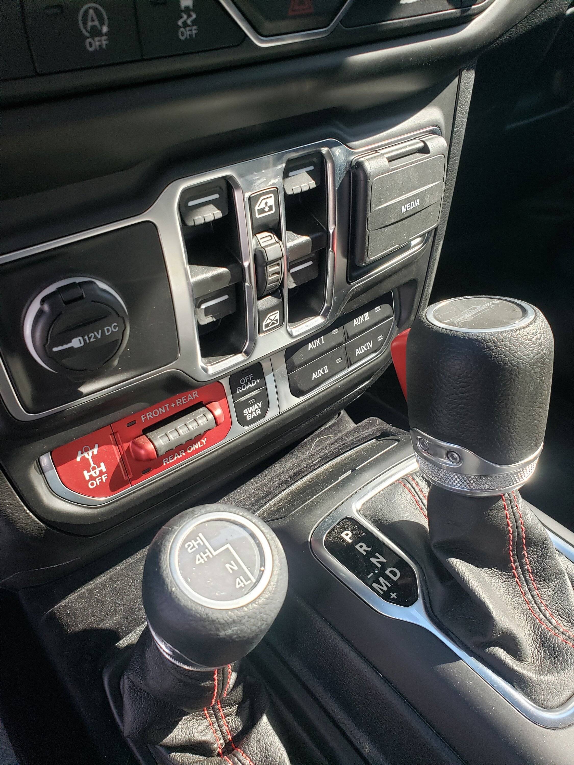

I realized I didn't post pics of the aux switch install...
Jeep Gladiator Jane, the JTR 20231007_094651
Jeep Gladiator Jane, the JTR 20231007_093637
Jeep Gladiator Jane, the JTR 20231007_093628

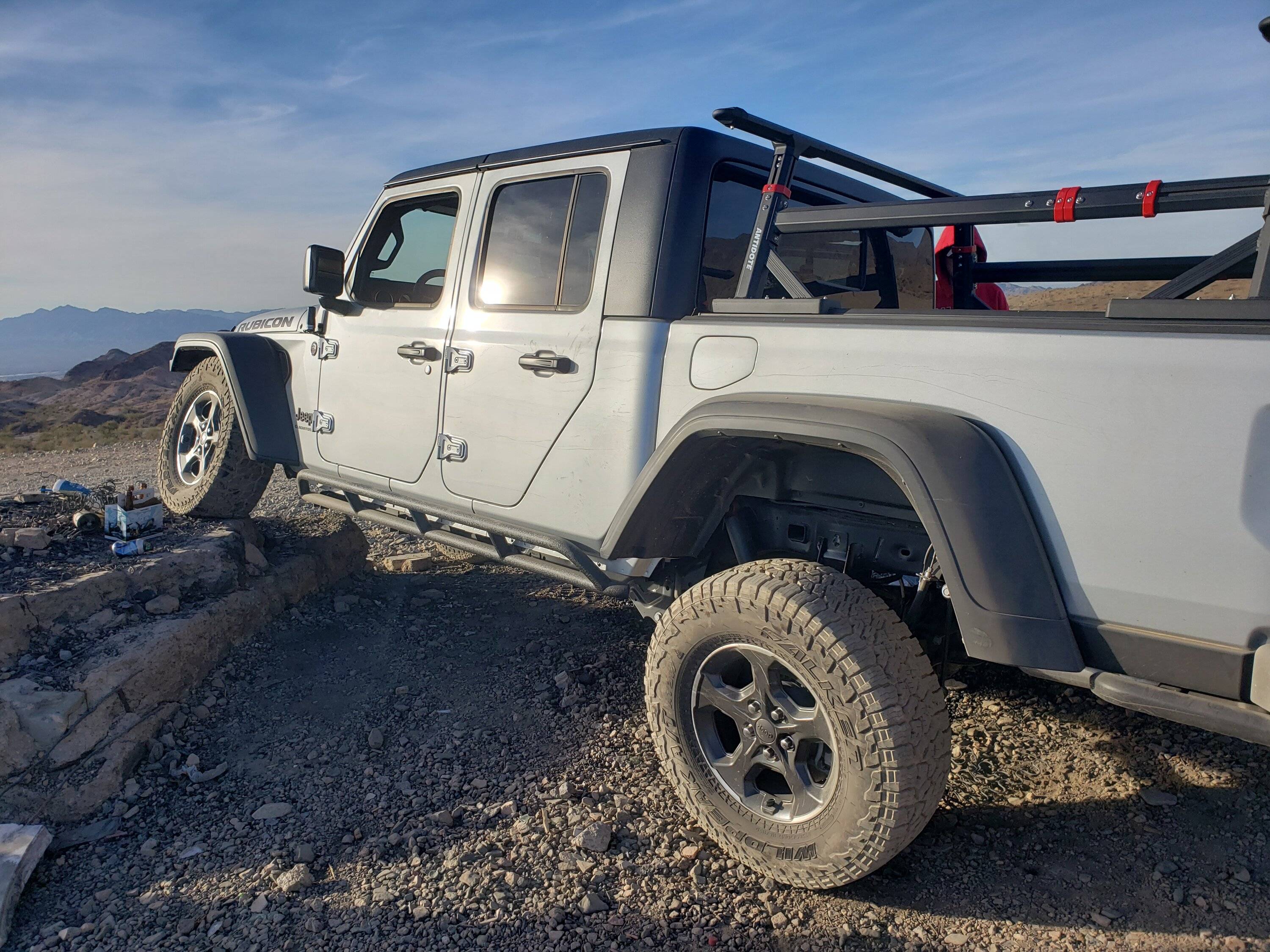

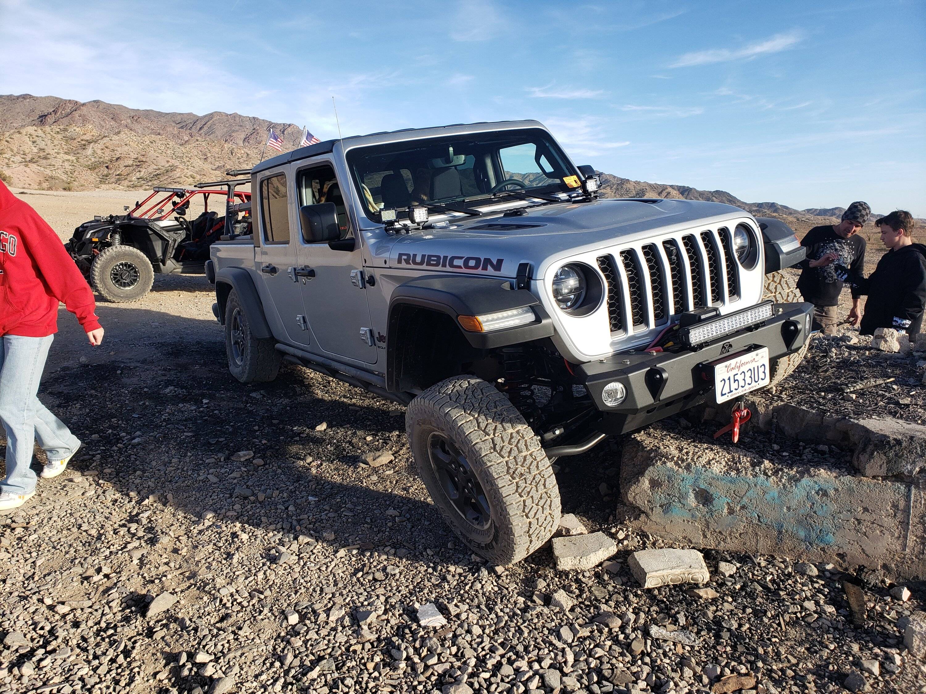

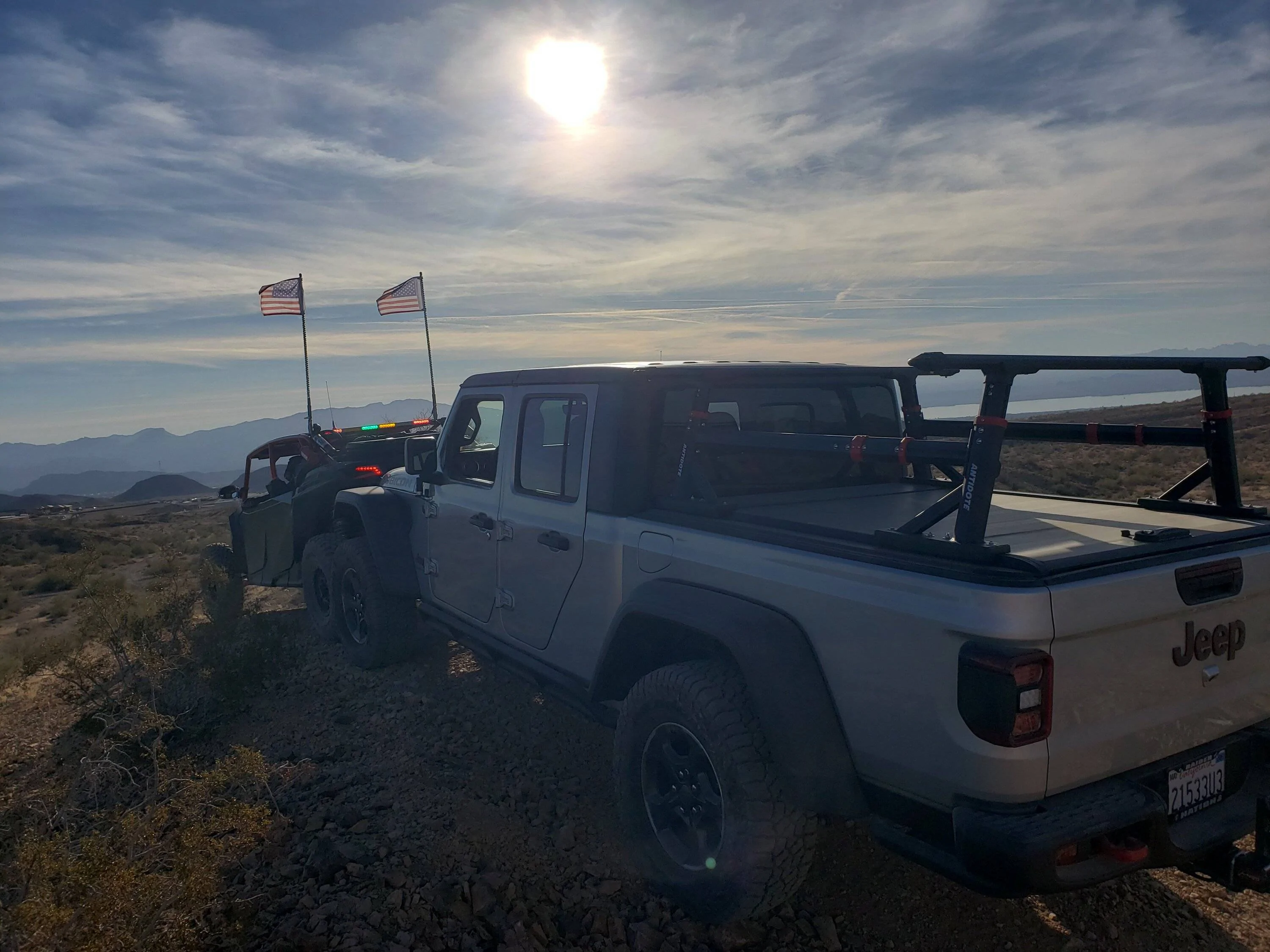

I was able to take a few days out to Lake Havasu. Got the stock 33s in dirt before the lift.
Jeep Gladiator Jane, the JTR 20231215_155649
Jeep Gladiator Jane, the JTR 20231215_155630
Jeep Gladiator Jane, the JTR 20231215_153704

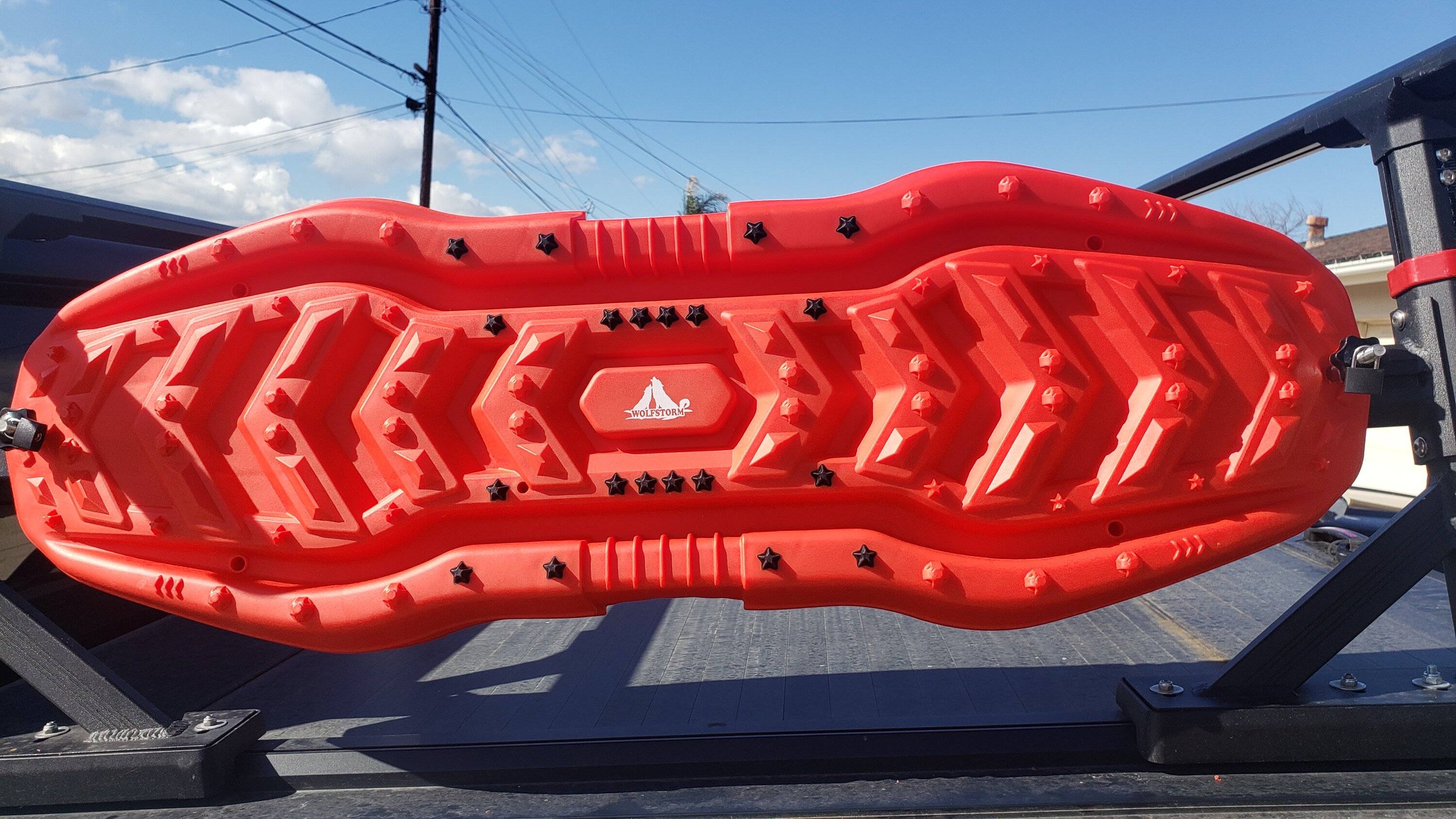

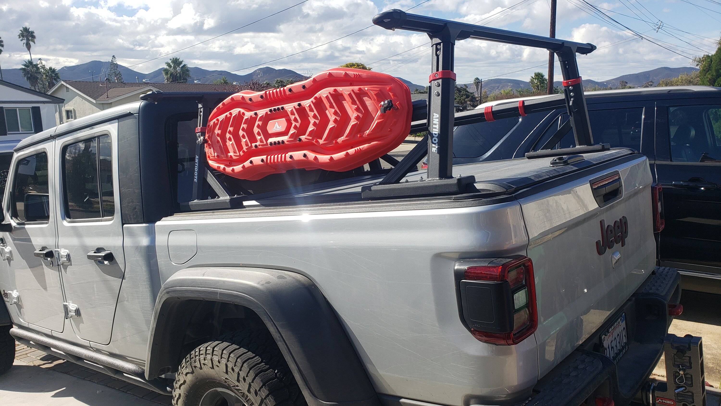

Mounted my traction boards today!
Had to add a couple holes...but they look good. Hopefully they function well also!

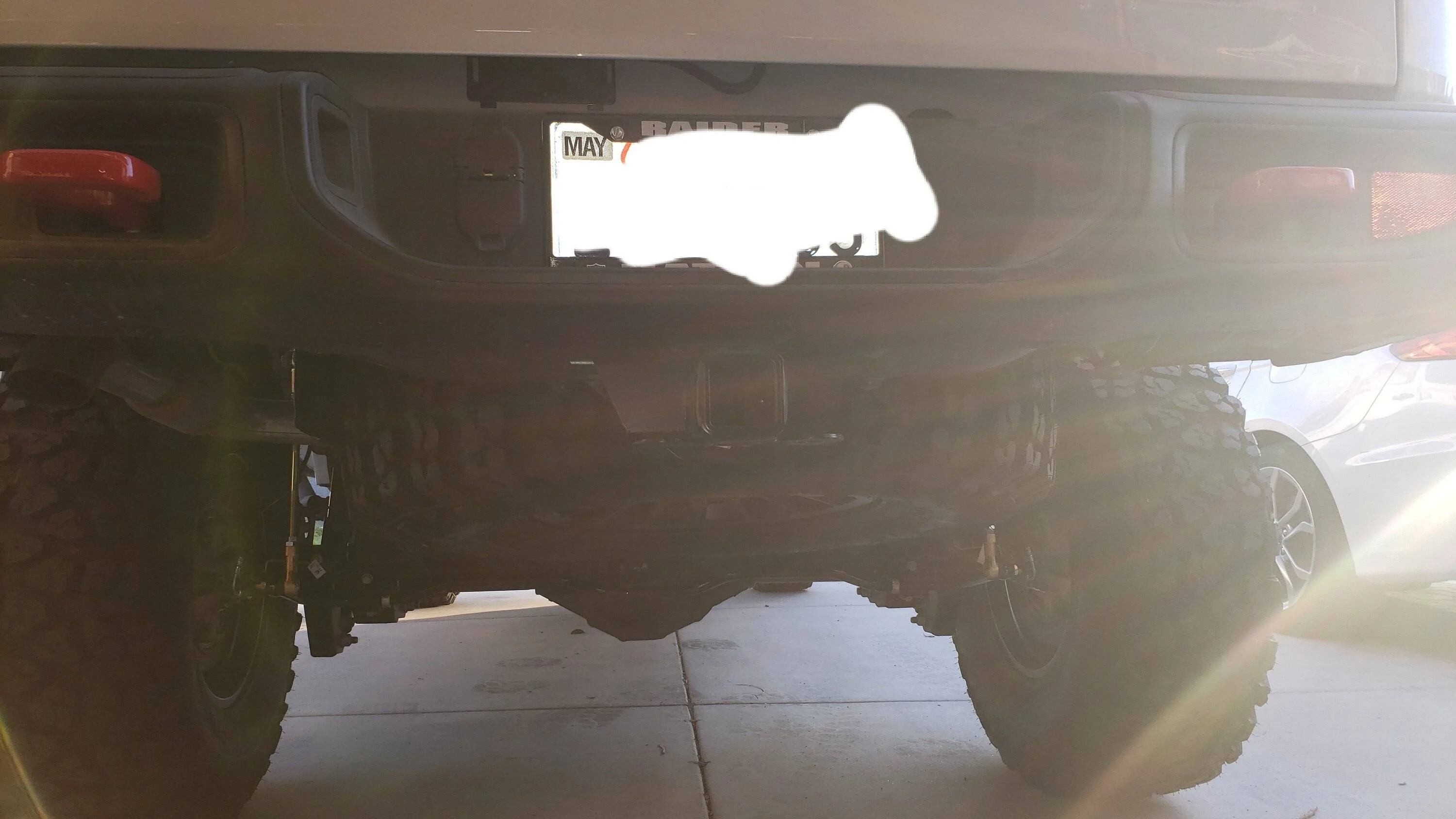

Recruited my kids to help and got the rear 90% completed.
I'll have a bit of a writeup....more of a notice of differences from videos....but this is the only pic so far. Darkness and the need to close my garage door cut today's progress short.

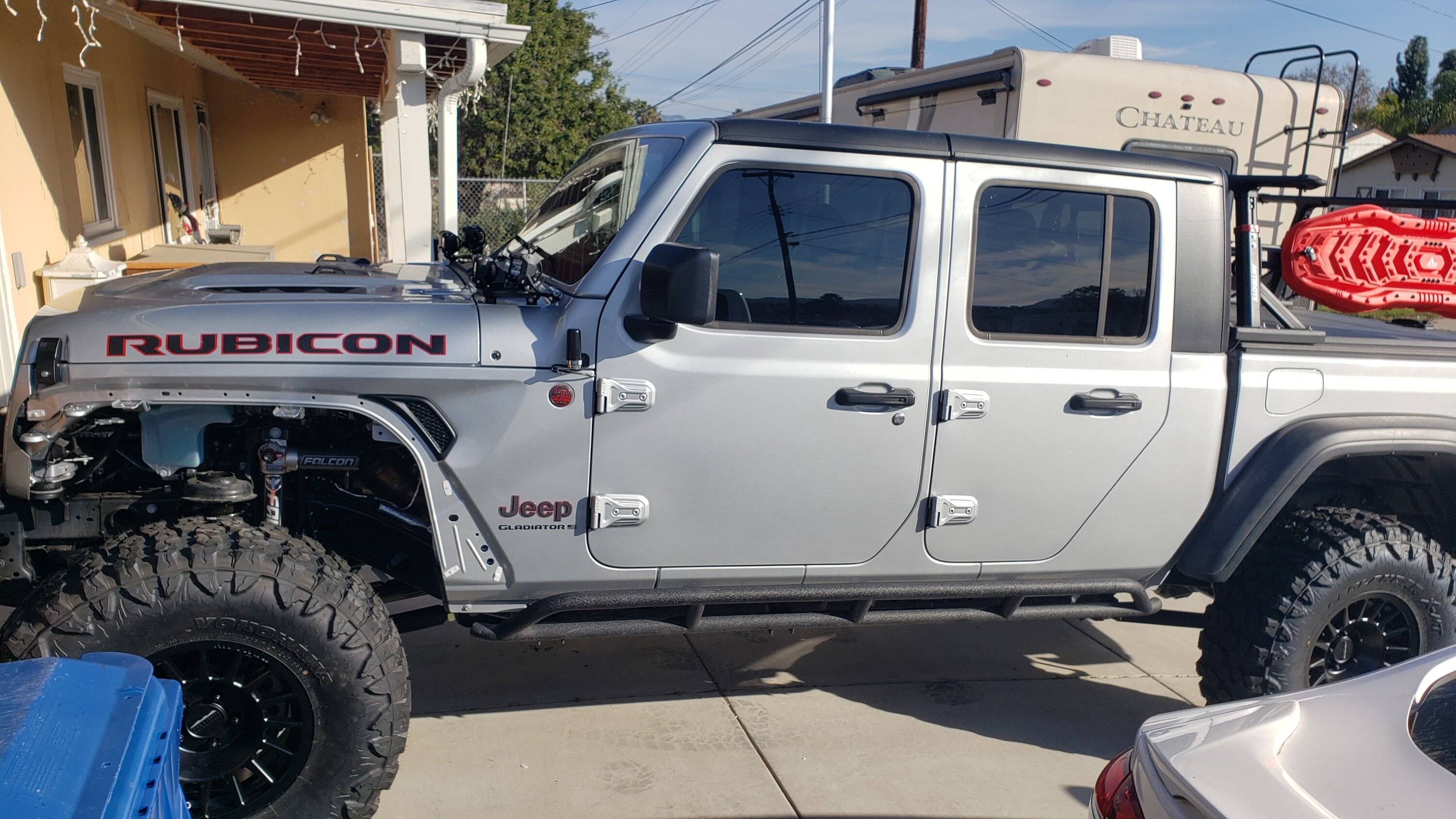

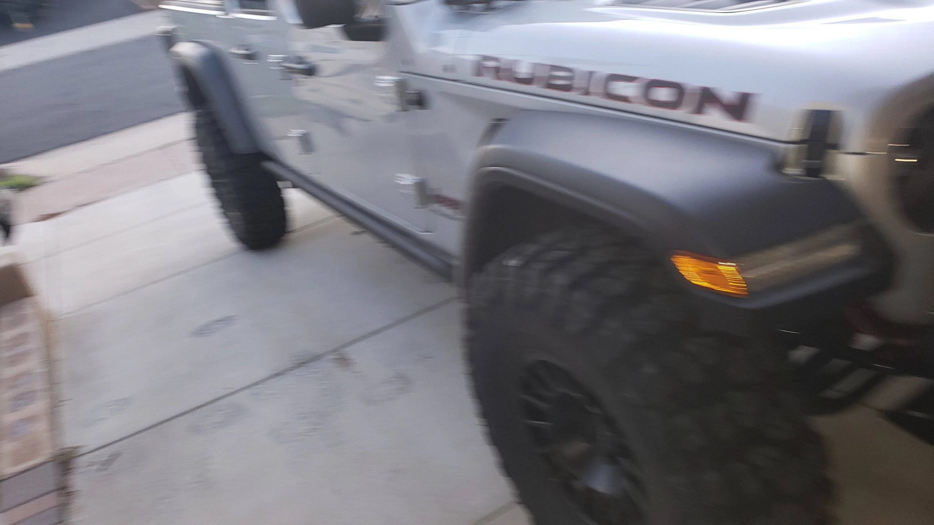

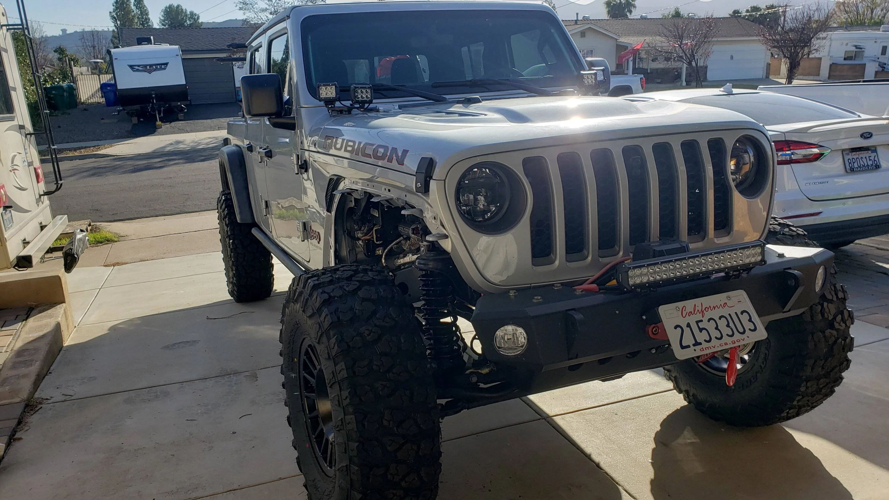

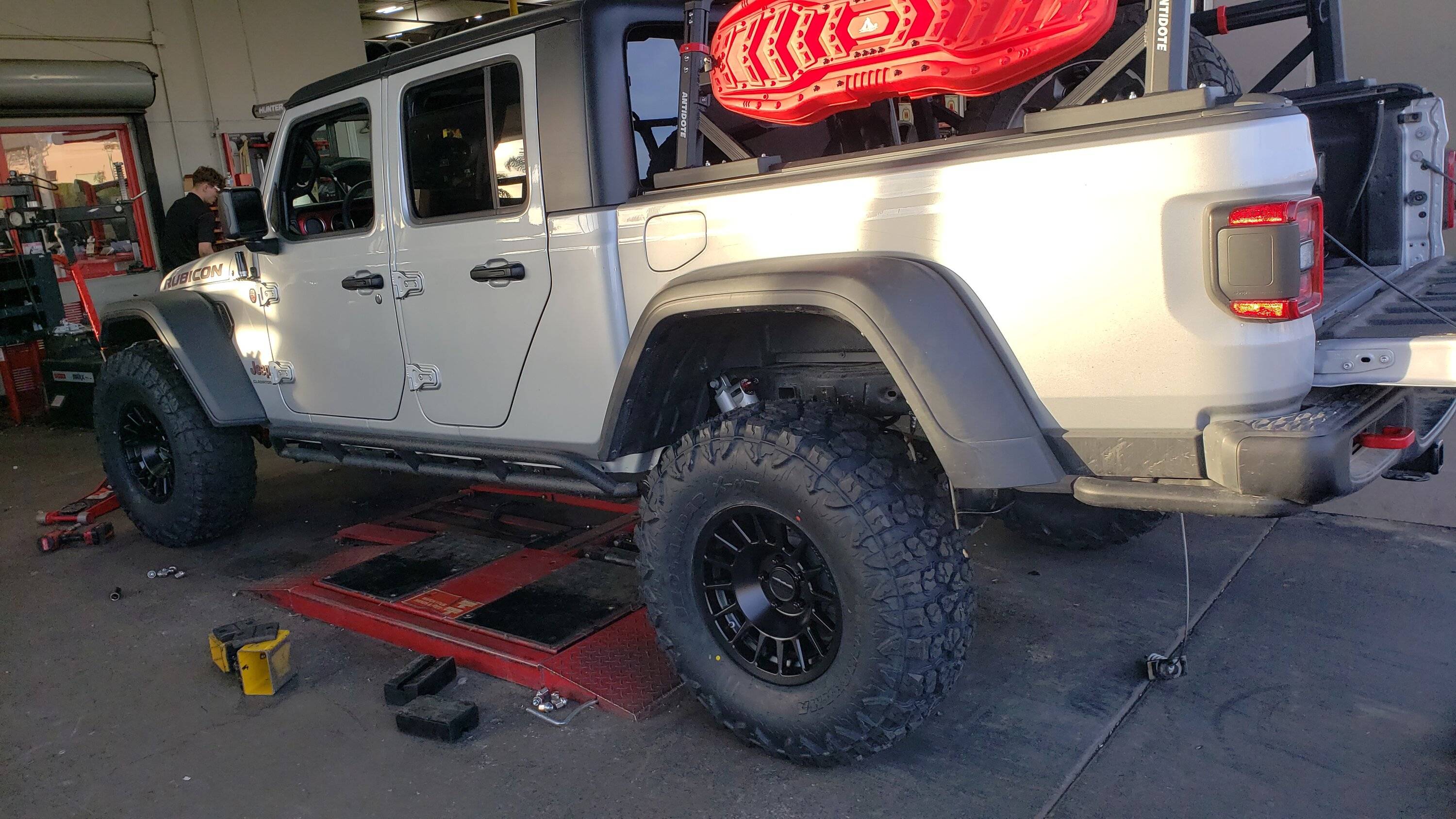

Method bead grips and Yoko 37s installed!
With the rain and life in the way the front lift is delayed. Rear is finished other than tightening the jam nuts. I don't have wrenches that big and will need to make a purchase. Did crack my 21mm impact socket. So need another before moving forward.
Work is taking over for a couple weeks so no progress until late January or February.
Oh...and the Yoko 37 spare fits in the stock location!!!
Pics!
Jeep Gladiator Jane, the JTR 20240106_161124
Jeep Gladiator Jane, the JTR 20240106_165225
Jeep Gladiator Jane, the JTR 20240106_173946

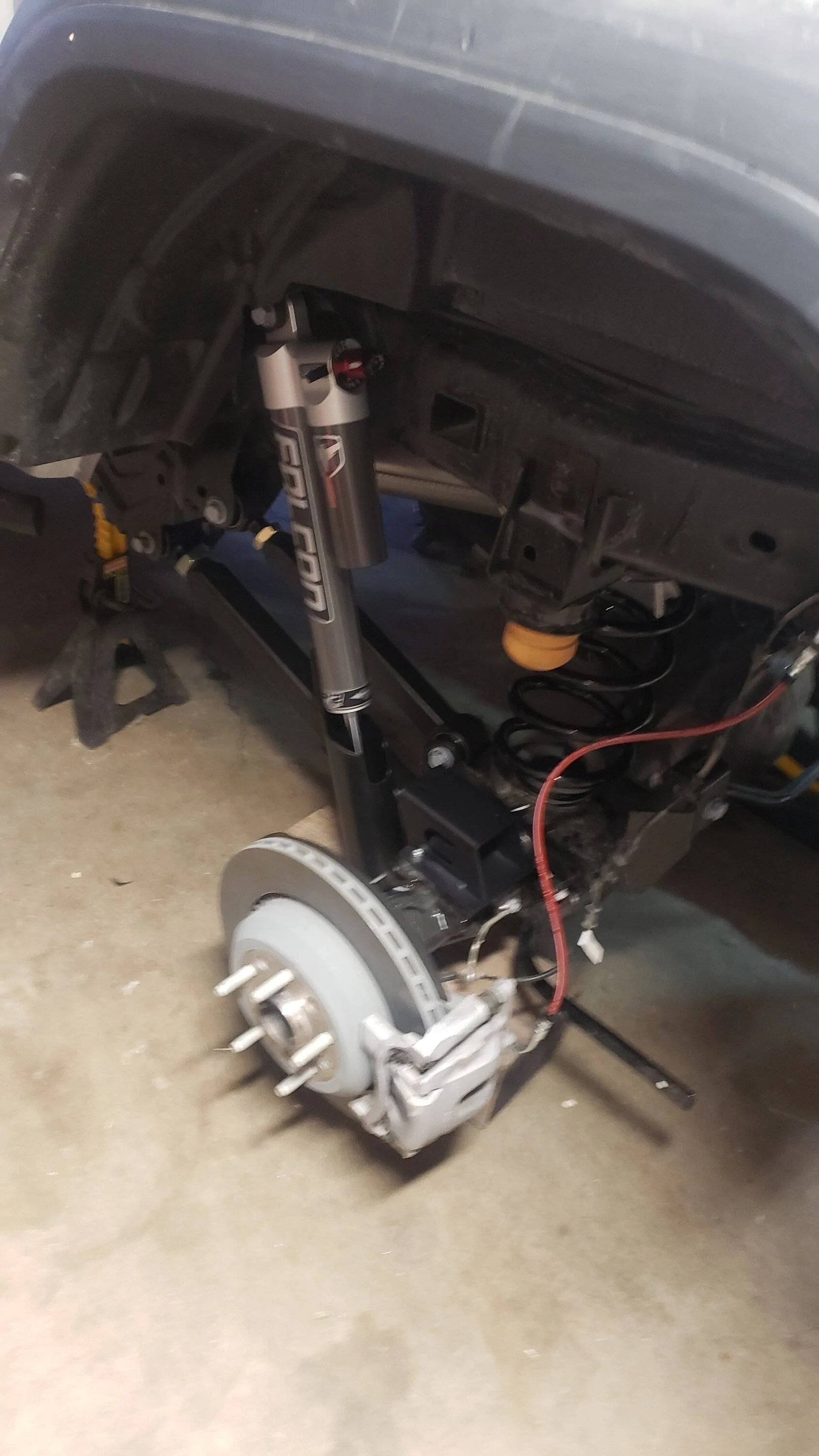

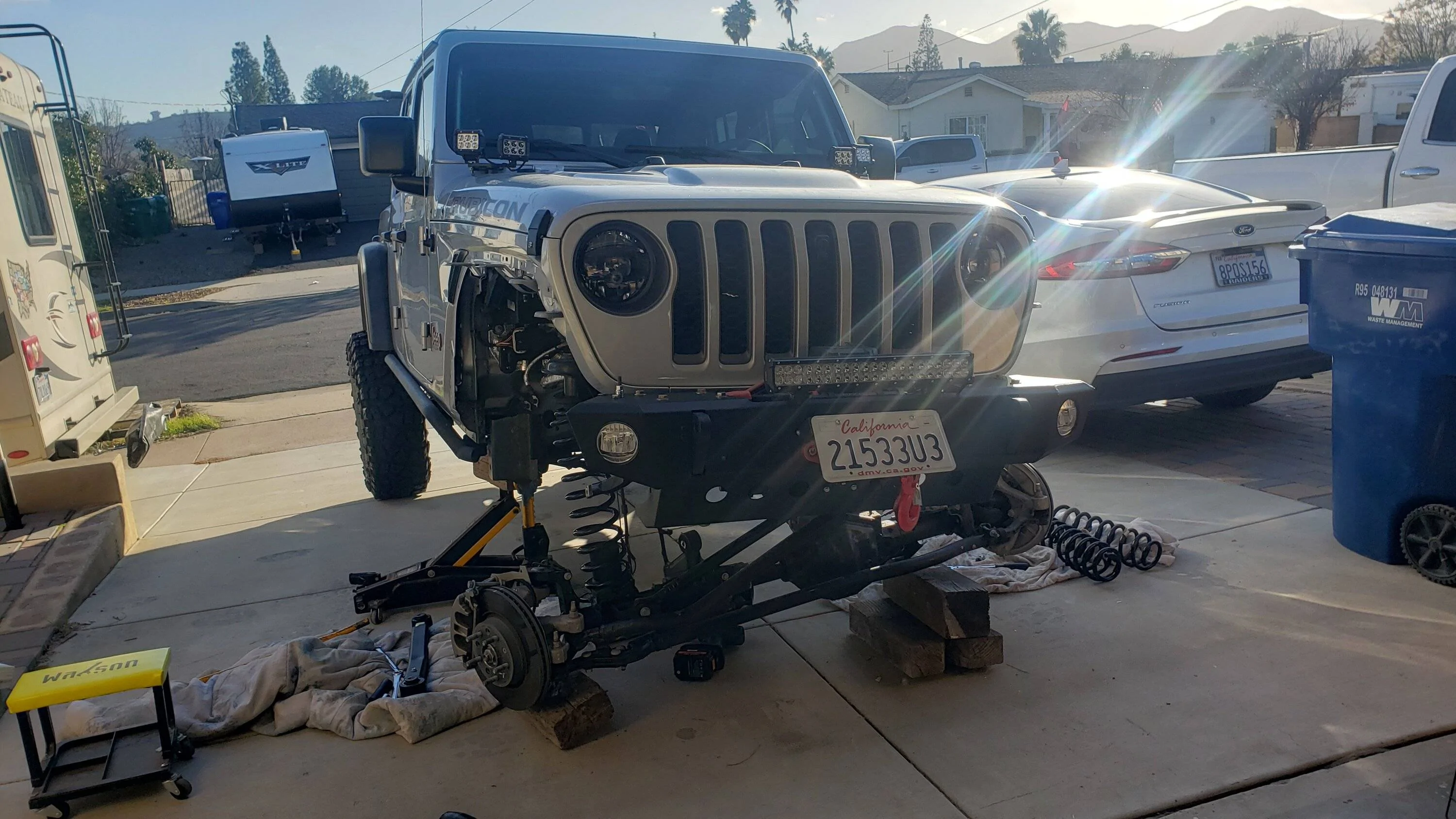

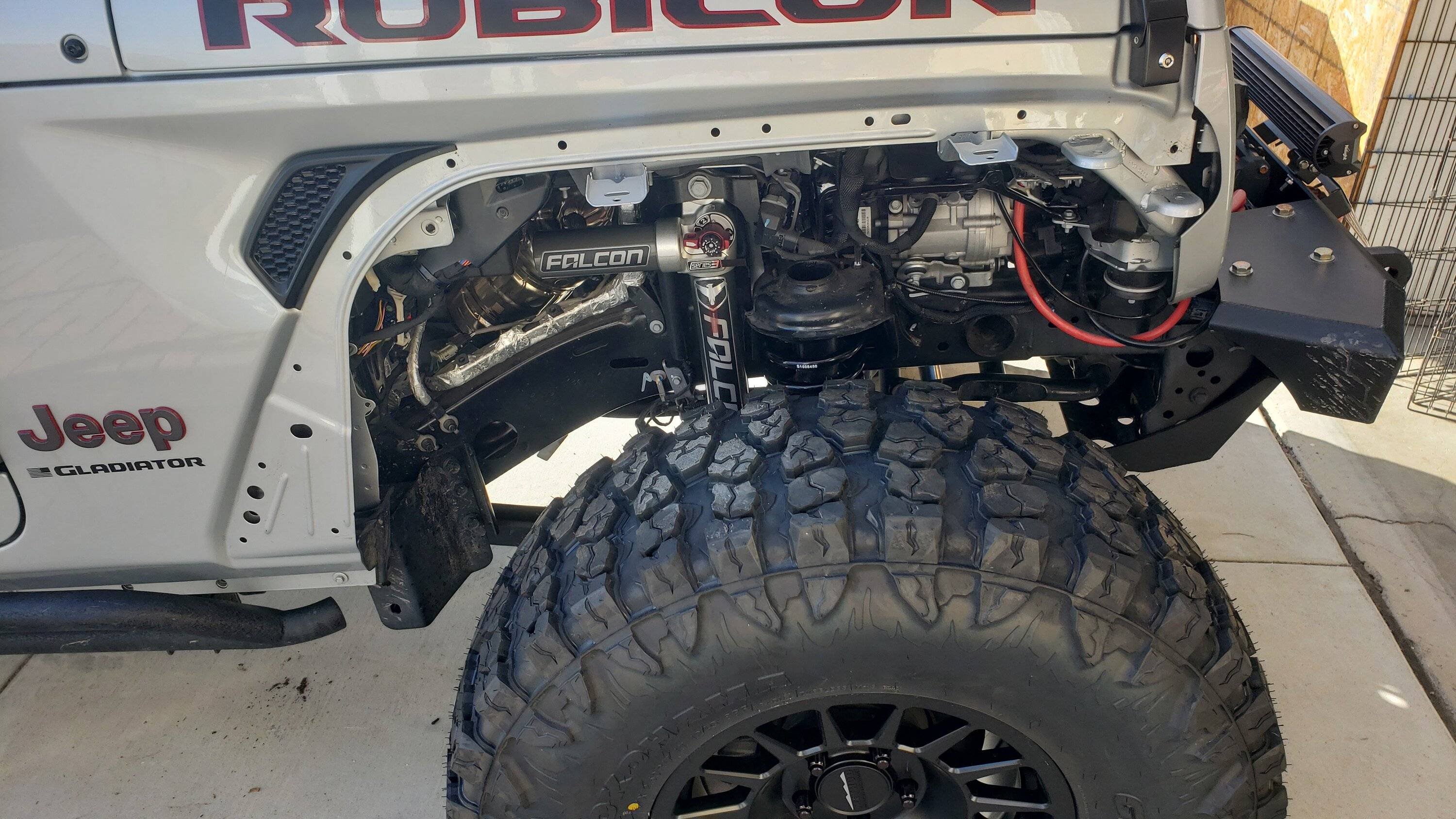

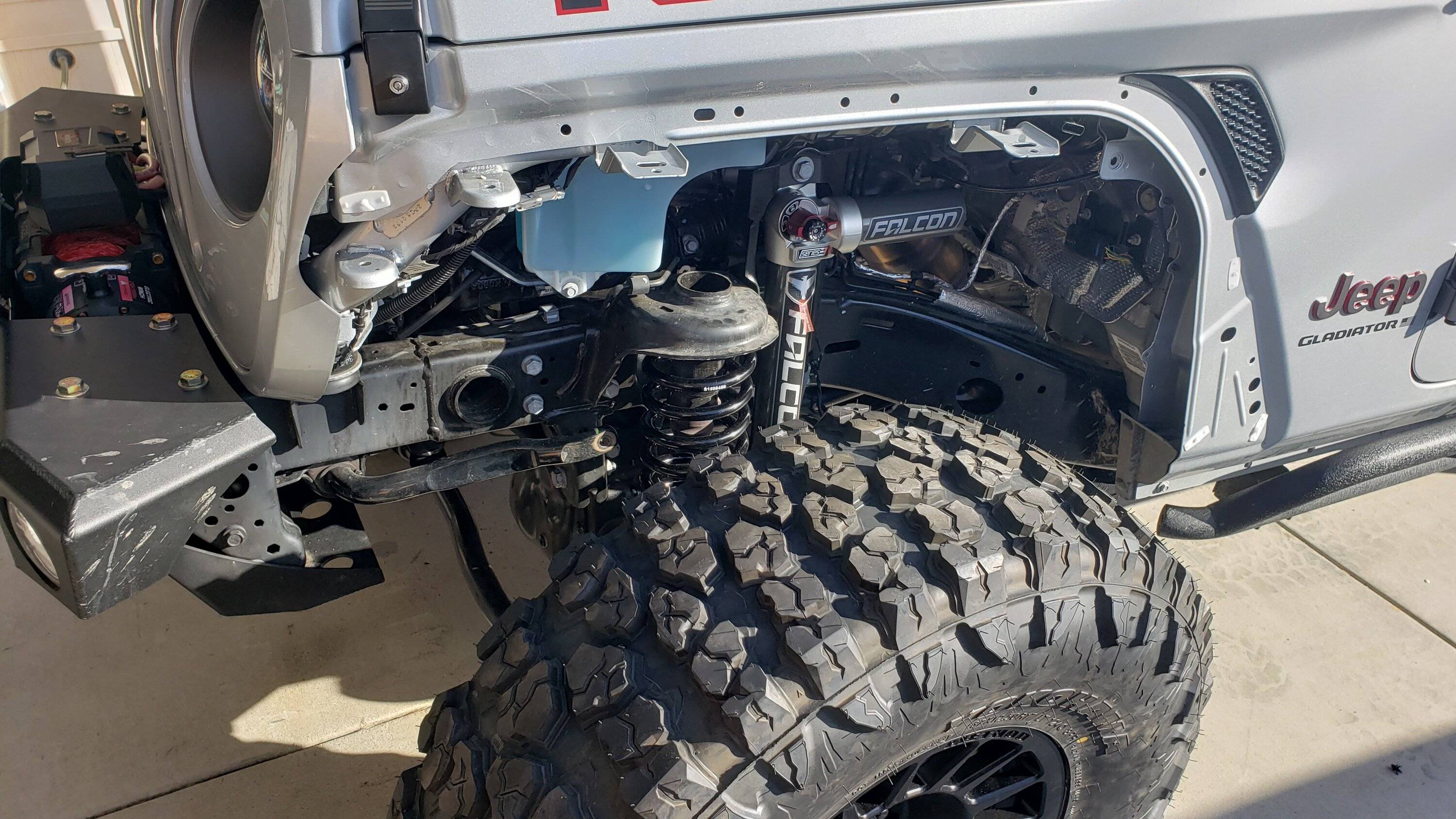

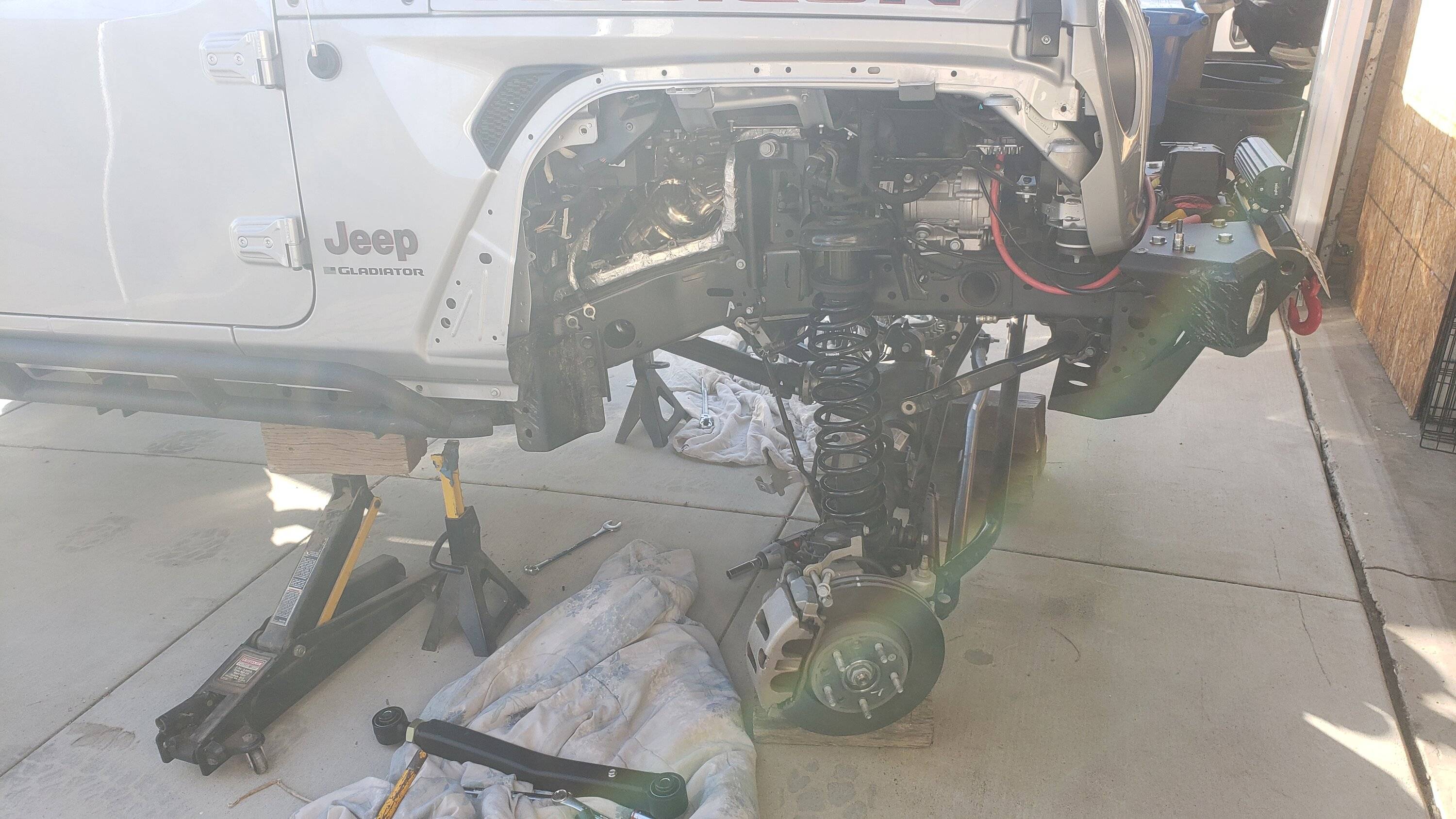

Making progress. Actually tried to tap out but my mechanic is too busy. ??
Fender liners and fenders pulled.
Starting on passenger side. Kicking my own ass....but doing it myself.
Jeep Gladiator Jane, the JTR 20240114_152740
Jeep Gladiator Jane, the JTR 20240114_152756

Thanks! Got stuck before it got dark. Upper Control arm (UCA) wasn't aligning. Double checked measurements... I'm going to try removing the UCA and LCA on the driver side. I think it may be holding it from aligning.

Sure enough. Removed driver side stock CAs and the passenger UCA slid into place.
One thing learned during this install. If something doesn't fit try raising or lowering the jack.
Found an incorrect measurement/typo for the front swaybar links so waiting for a response from @Clayton Off Road. Rear was only cut 1/4" each side of the rod. Front states to cut 3" each side. I'm betting its more like 1.5-2" each side.

Hey Jeff!
Truck looks great! I just wanted to chime in as I don't want you to experience any issues down the road. When trying to get the second upper control arm bolt hole to line up, the best thing to do is to just make a couple of turns on the adjuster in order to get the bolt through, rather than to try and remove anything or to try and shift the axle.
Basically due to the triangulation the front portion of the geometry has from the factory, you don't want to force the second upper into position as this will create a constant twisting force leading to premature bushing ware and suspension bind. The front uppers do not actually have to be the same exact length, as you only have to use one of the uppers to set your caster angle, and then just get the other one in even if it requires a couple of extra turns to the adjuster.
For the most updated version of the lengths and measurements, check out the "Quick Guide" located under the instructions on our kits. The sway bar measurements should be very accurate, but as long as you are able to position the actual sway bar just slightly above parallel you should be good to go!

Thanks! I sent a pm with this information:
Front swaybar end links say to cut 3.031" off each end for an overall length of 9.063".
The bar is 13". Cut each end 3.031 = 6.062 off of a 13" bar = 6.938".
