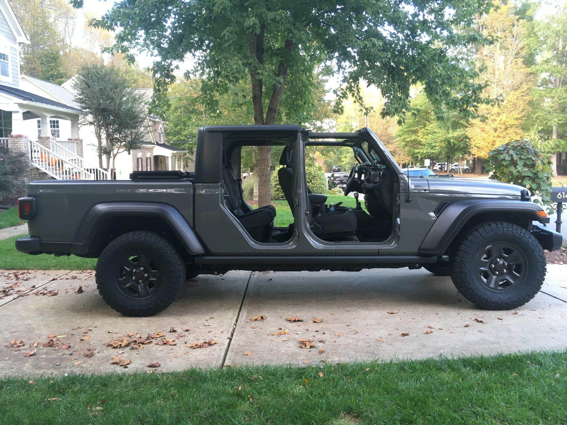

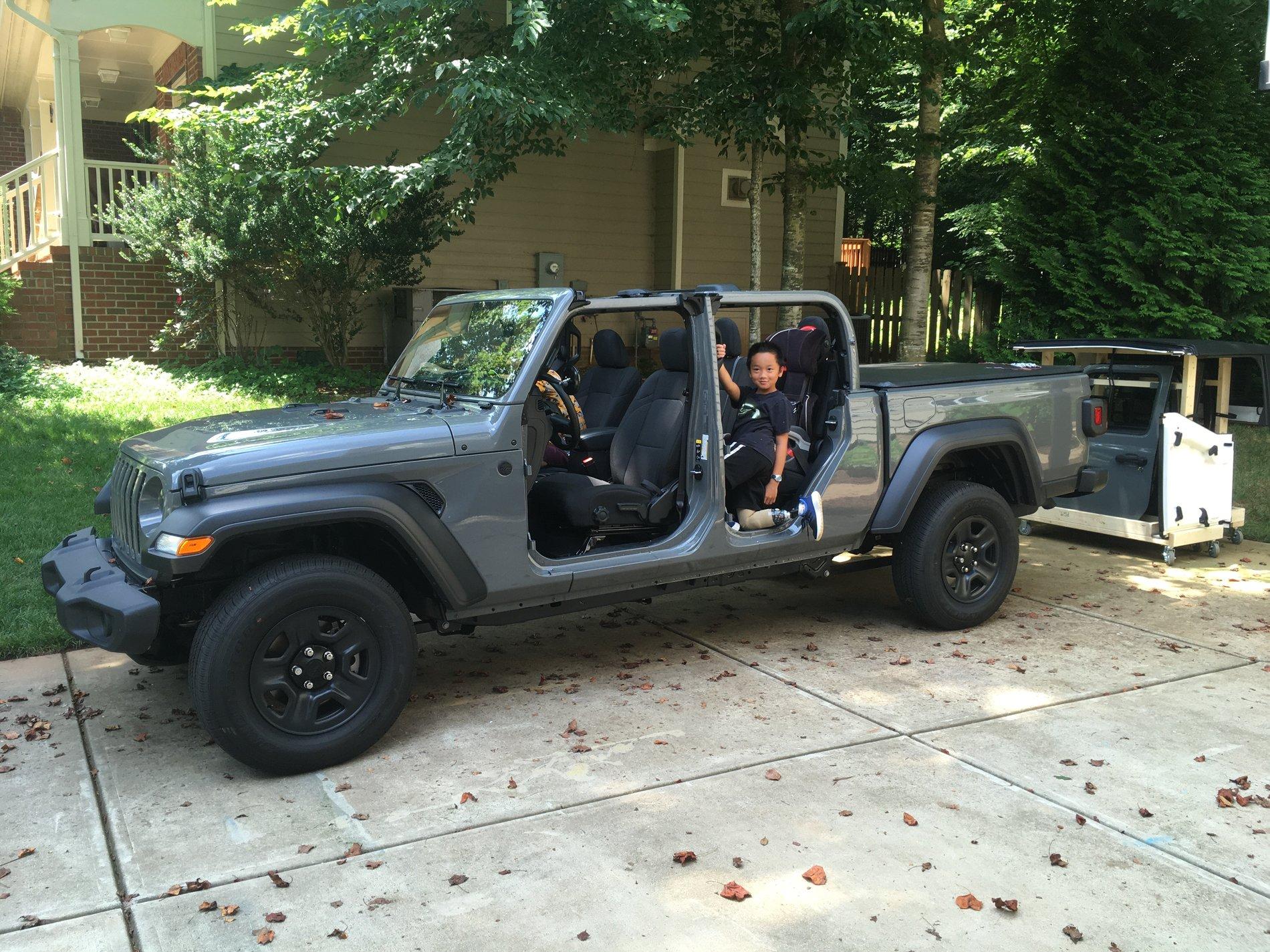

And since the weather has finally turned to full spring and summer mode, it was time to get the soft top on the truck this past weekend. In the process of removing the hard top, the kids said we should go do errands with no roof on - didn't have to ask me twice!

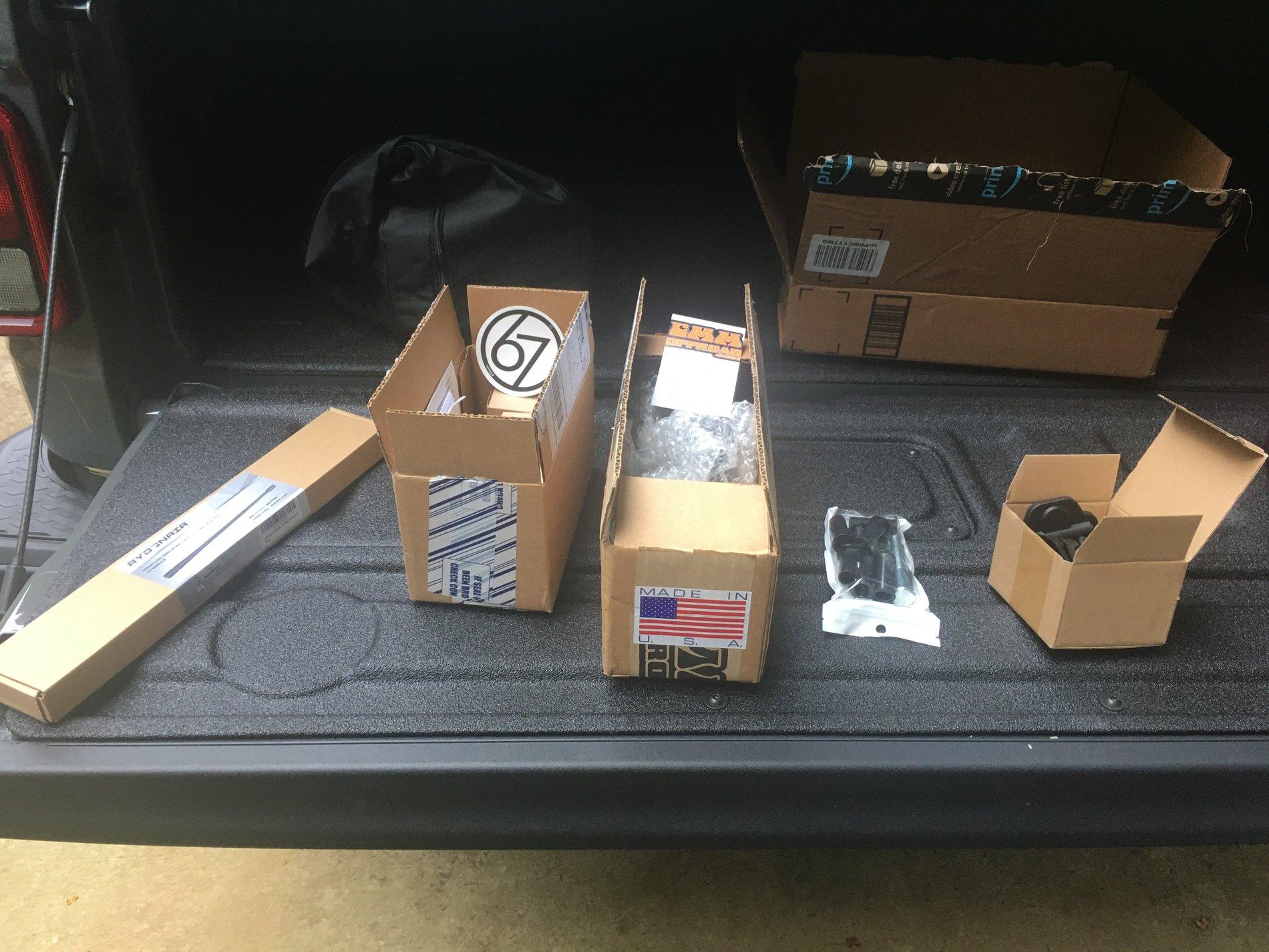

Oops. Looks like I forgot the 3 way manifold on the list above but did manage to remember it on the Amazon list. :whew:
Jeep Gladiator Plain Jane, the family truckster airup-parts
Once all the parts arrived it was a pretty straight forward assembly. Cut the 50' hose to start making 2 of each needed section:
  • rear wheel to T fitting (using the factory fitting on one end)
  • stub hose from T to front wheel
  • T to manifold w/ the gauge and input valve
I ended up with a 2 foot section left over that I may turn into an extension on the input later.
For the manifold/guage I removed all the quick connect fittings and have the hoses going straight into the manifold. I may add those back in later if it's hard to wrap and store it all connected. So far it's not bad since it's 1/4" and not 3/8" and since all the junctions swivel.
The Flexzilla hosing and fittings were great to work with. Not cheap but they went together really well and feel like they'll last.
The only other thing I did was to remove the stem core from the Schrader valve so that I can air down as well as air up.
Overall I'm pretty happy with it...

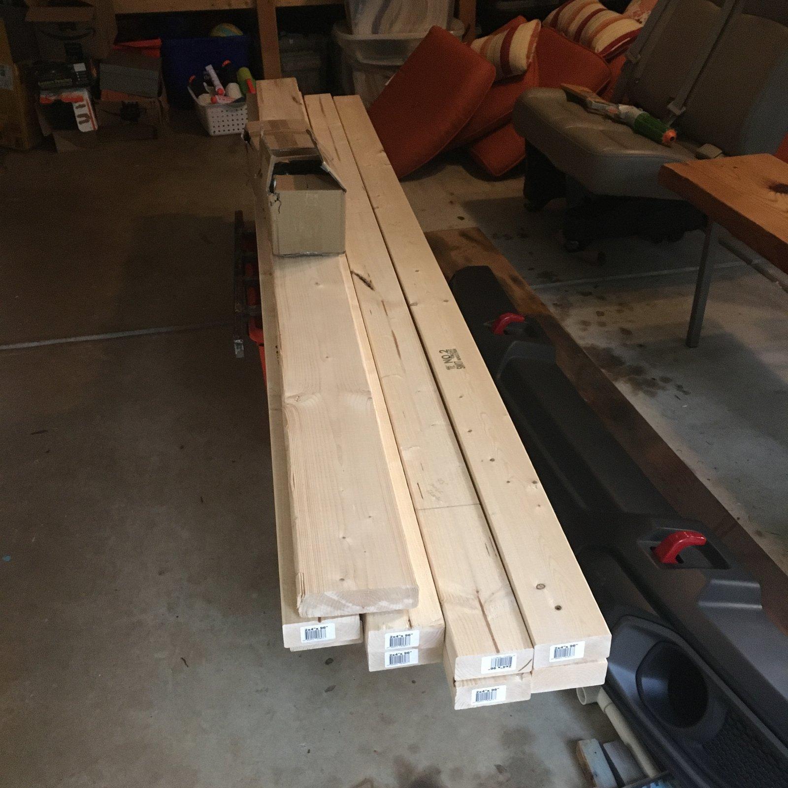

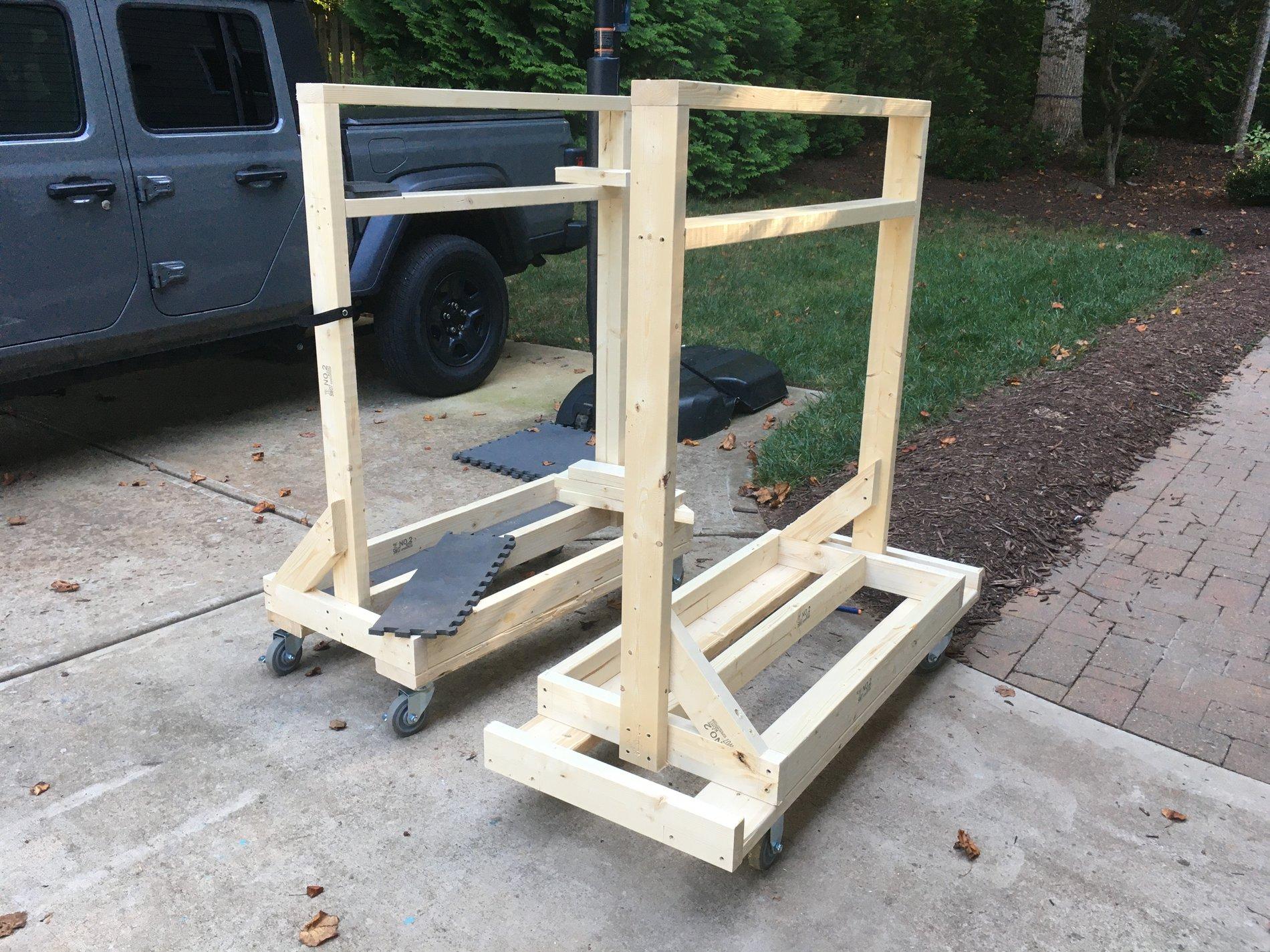

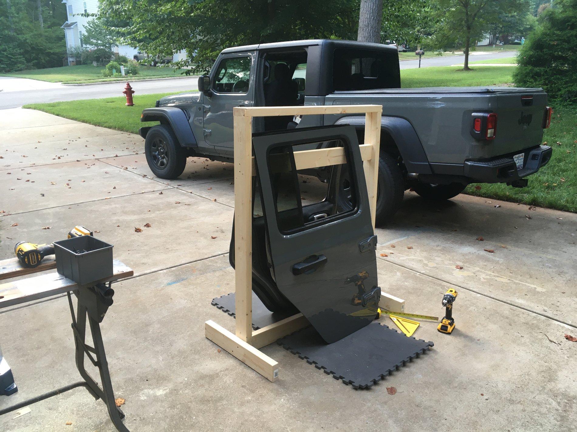

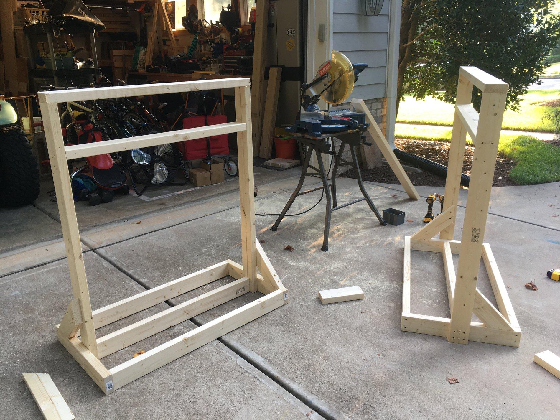

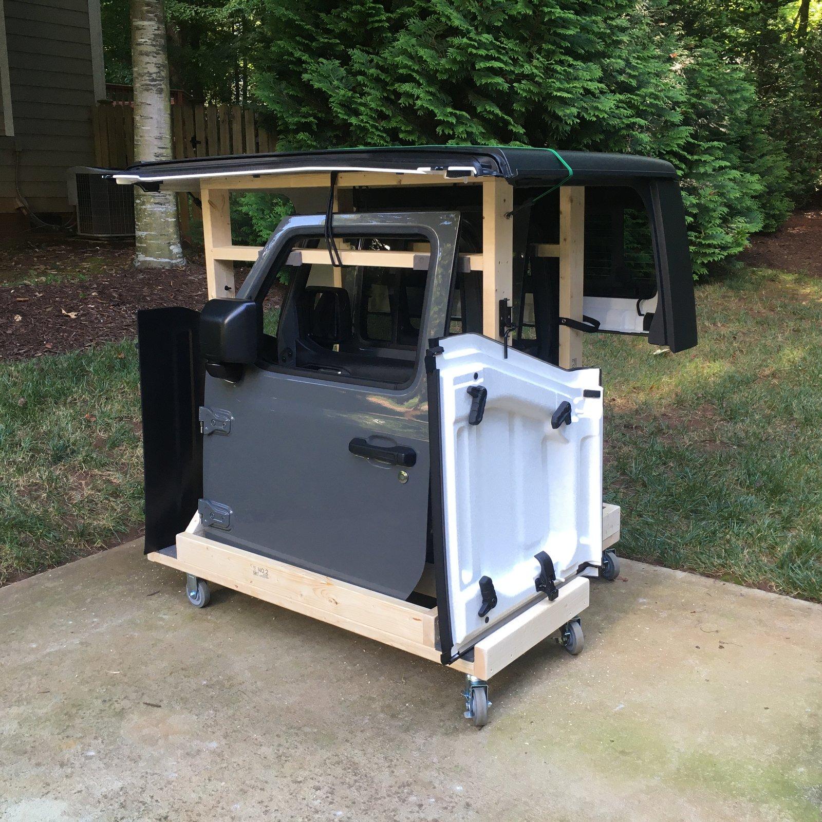

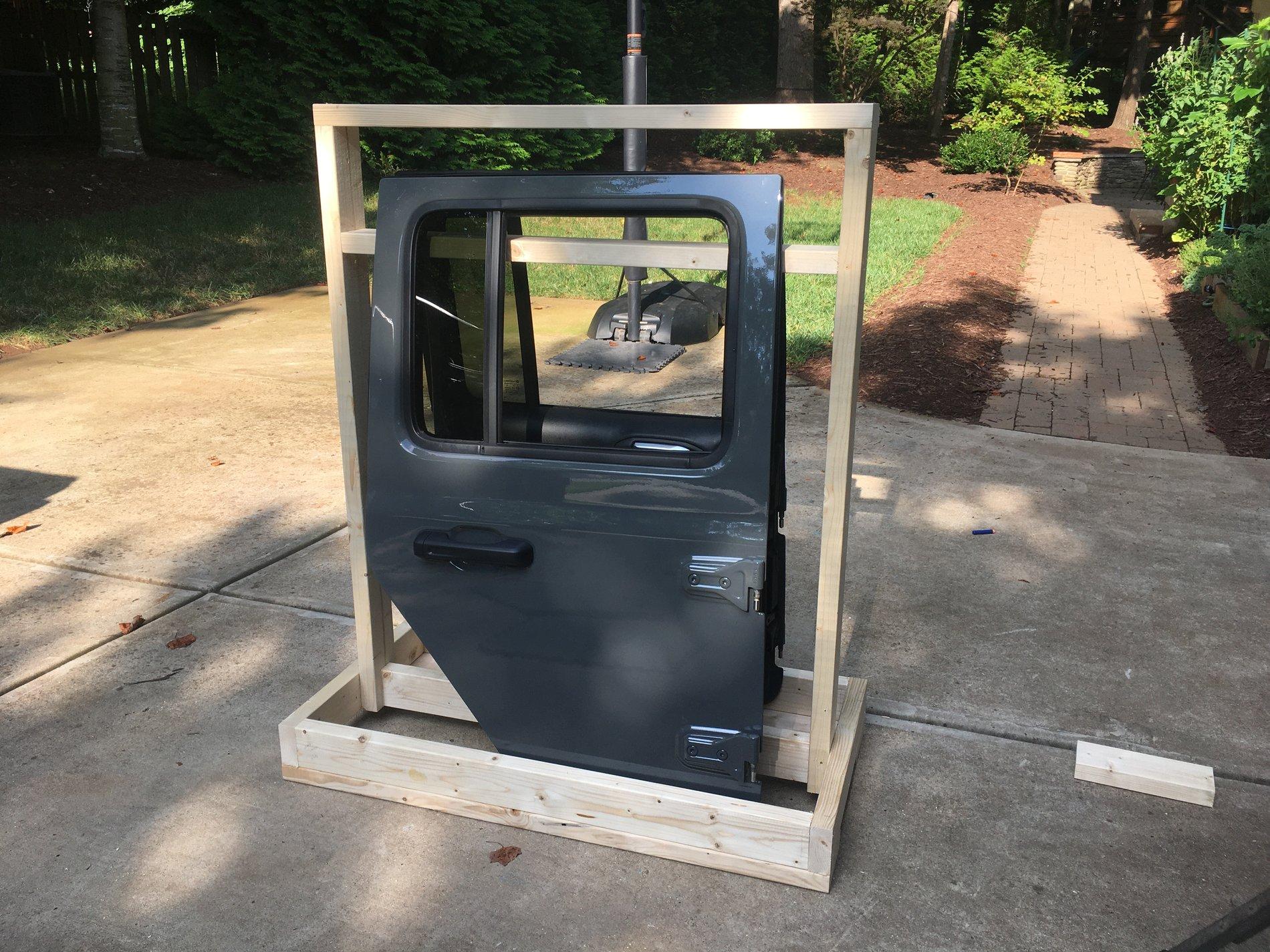

Finally got time to work on a door cart. Overall I wanted it to support 3 configurations:
- Front doors only with or without Freedom Panels
- All doors with or without Freedom Panels
- All doors and roof with or without Freedom Panels
And it had to fit in a narrow spot in the garage. After researching a bunch of current options I made some plans and got started.
At first I seriously considered steel, but decided on lumber due to cost.
Did some testing of the design and found I needed a bit more space between the doors on the cart. I was also happy that the width was stable enough to hold a door without the other one on the cart.

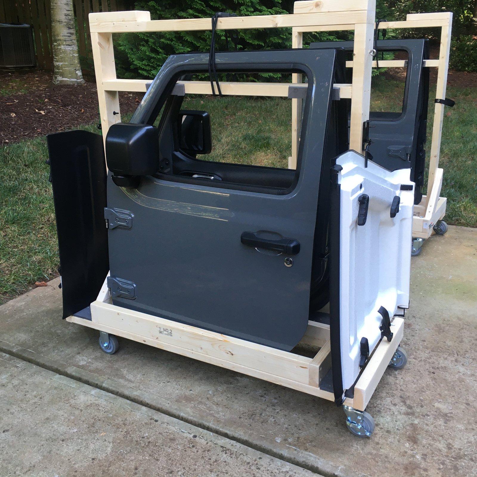

My plan was to have a cart for the front doors and cart for the back.
I added some foam, casters and additional bracing. The front door cart has additional spot for the Freedom Panels.
They hold the doors quite well and are easy to roll in and out of the garage.
And finally the carts can be latched together to move all the doors together AND can store the roof on top.
When it's loaded up I can leave it at the back of the drive or roll it into the garage. Pretty happy with the way it came together.
OK. This is actually kind of brilliant! Great idea!
