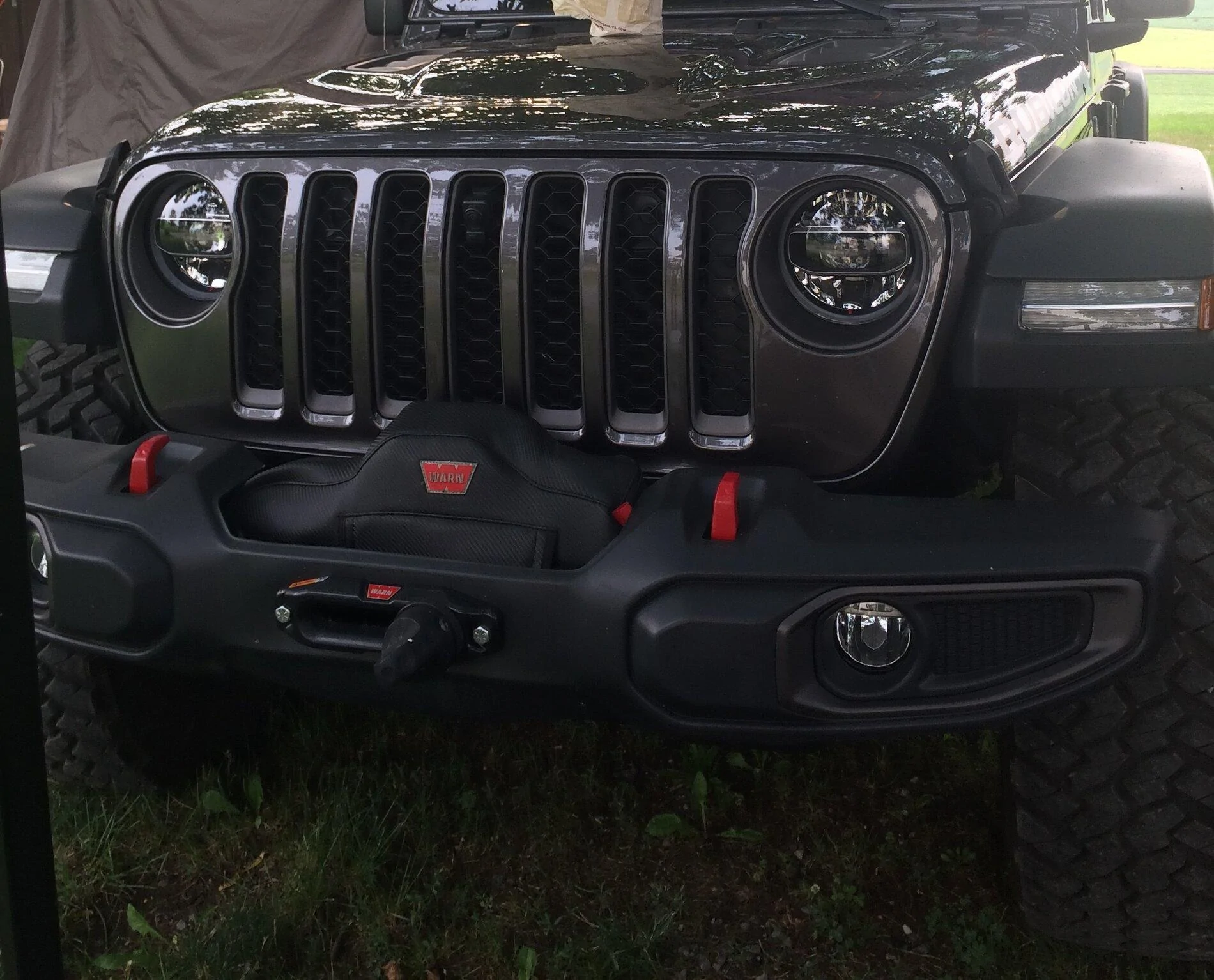

Its kind of winch ready in that the bumper itself is "winch ready" but there is no plate between the frame rails for the winch to sit on. Go warn or maximus 3 for the winch plate and it will sit nicely inside the bumper and install fairly easily.
