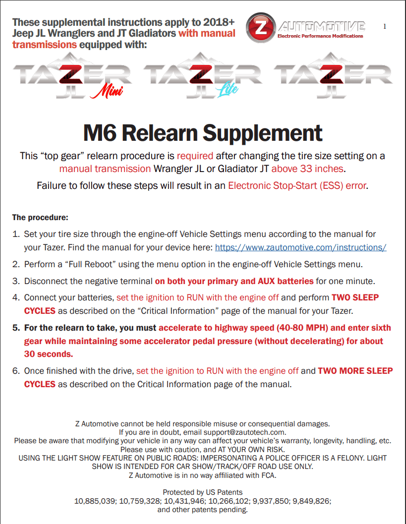

Update. Dealership was able to confirm nothing mechanical. Was able to clear service Tran’s warning, rest eeprom - back to square one! ?
I did learn that via forum there is a step that I did not do / needed to do because my truck is a M6. Pretty sure I am partly at fault for what happened.
In any event. Going to return tazer snd opt for JScan. Seems a little more simple and easy to use. Cheaper, and I think will be more than enough for my needs.
Thanks again for comments / feedback. Hopefully this post will help others in the future considering Tazer.
my advice is to watch videos AND carefullly read the 15-16 pages of instructions paying attention to ALL steps before installing. If you have a m6, pay special attention to supplement material.

Did you do the REQUIRED 6th gear relearn?
Jeep Gladiator JL Mini Issue! 1715682370006-v6
IamPro2A
Apr 25, 2021
1,107
1,577
New Hampshire - Live Free Or Die!
'95 YJ, '07 Ram, '25 JTR, '26 JLU (sold '16 JK, '21 JT, '25 JLU)
Retired-ish
He implied in his last post he did not.
So once again, like 99.999% of the time, it was user error and not the fault of the Tazer.
