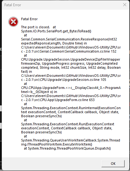

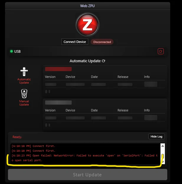

Hey everyone -
Really need your help here, I'm on my 3rd JL Tazer Mini. So far, i'm doing everything correct (correct cable etc), but my PC doesn't seem to pick up the Tazer when connected to the software...
The Tazer blinks green etc
Would really apprecaite any help from anyone..
Jeep Gladiator On my 3rd Tazer JL Mini.... Please help 1778879333064-80
Jeep Gladiator On my 3rd Tazer JL Mini.... Please help 1778879359476-1q

Jeep Gladiator On my 3rd Tazer JL Mini.... Please help 1778883239867-1d
Jeep Gladiator On my 3rd Tazer JL Mini.... Please help 1778883815523-sg

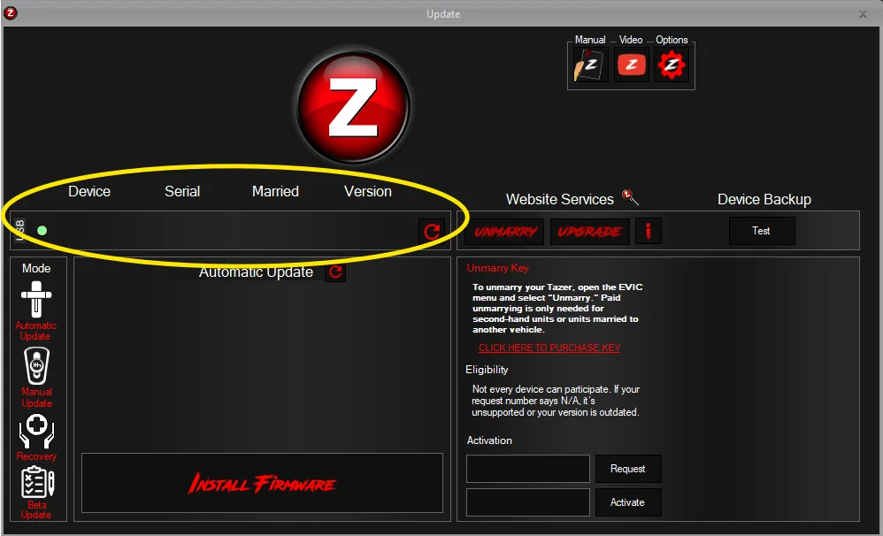

Jeep Gladiator On my 3rd Tazer JL Mini.... Please help 1778883529007-w3
Jeep Gladiator On my 3rd Tazer JL Mini.... Please help 1778884129281-fx

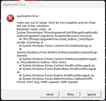

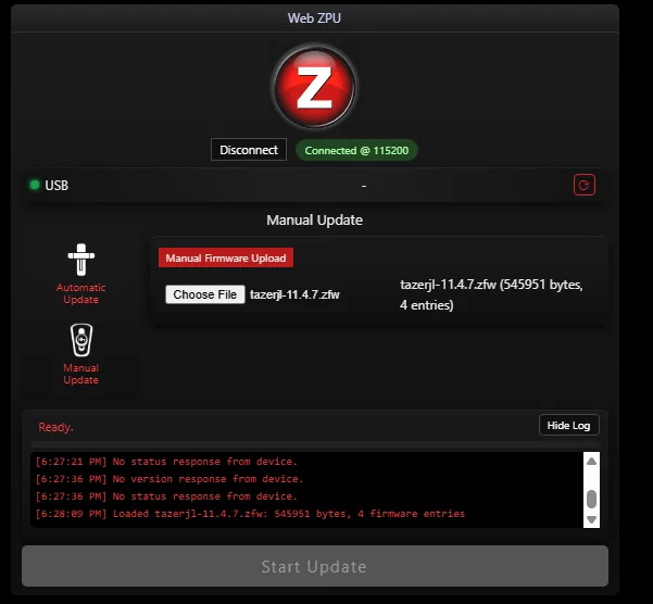

When I tried to do a manual update with the downloaded file:
Jeep Gladiator On my 3rd Tazer JL Mini.... Please help 1778884646923-2w
