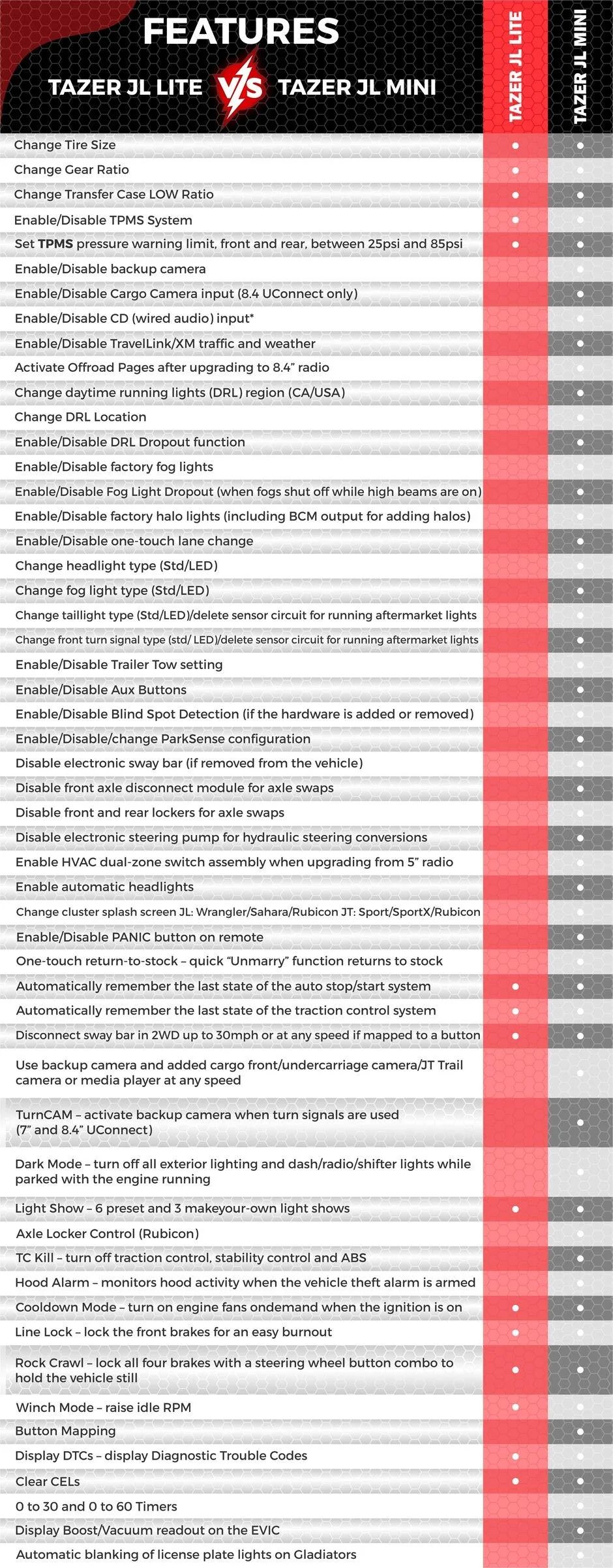

Looking for a quick and dirty spreadsheet or list.
Kind of like this but with another column for JSCAN

Jscan is passive, it turns off and on options that already exist in the computer. It is disconnected after the changes are made. In that regard, they are essentially the same, with Jscan possibly having access to more options to change. The Tazer, if left connected, is an active device that adds features that are not part of the truck computers programming.

Yes, I'm really looking for a comparison with the understanding that we are not talking about functions that require the Tazer to remain plugged in.

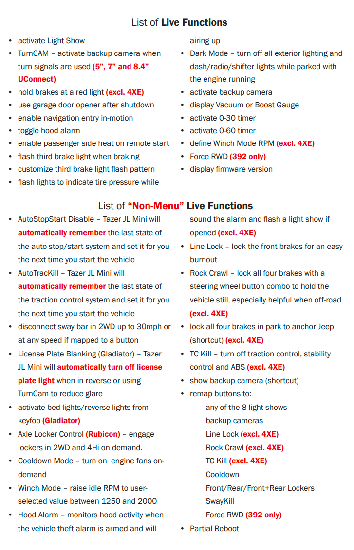

As long as we're only talking about functions that do not require the Tazer to remain plugged in, Jscan is probably more complete, though less intuitive. And off the top of my head, I can't think of a setting most people would want to change that isn't covered by the Tazer. And you specifically excluded Tazer's live (plugged in) features, but those are things that are impossible to get with Jscan, and why people buy the Tazer. If ALL you want to do is change tire size or keep the fogs on with the highbeams, by all means save a few bucks and get Jscan and everything needed to make it work. But if you want anything off the list below, get the Tazer.

Lemme just add this:
One of the Tazer features I never knew I needed and now wouldn't want to do without is the ability to turn on the bed/reverse lights from the fob. I use that ALL the time. IDK why that doesn't get more mention, because it's really useful, especially this time of year when it gets dark out at 4pm and stays that way until after 7am.

Is that a live feature?

Looking through this list of live features I'm now realizeing that i want the most expensive option. Ha.

I've got one question re "Activate Offroad pages" after upgrading to 8.4 radio.
I have read that your jeep regularly phones home to see if you have the "rights" to use offroad pages.
If this enables ORP without the need to confirm if you have the rights to it, this would be useful to me since I plan to disconnect or cover the antenna to disable telematics.
Does this function enable ORP without confirming whether or not you have the "rights" to that page?
