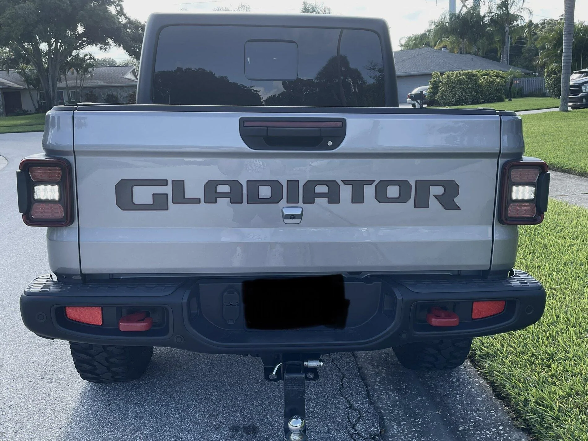

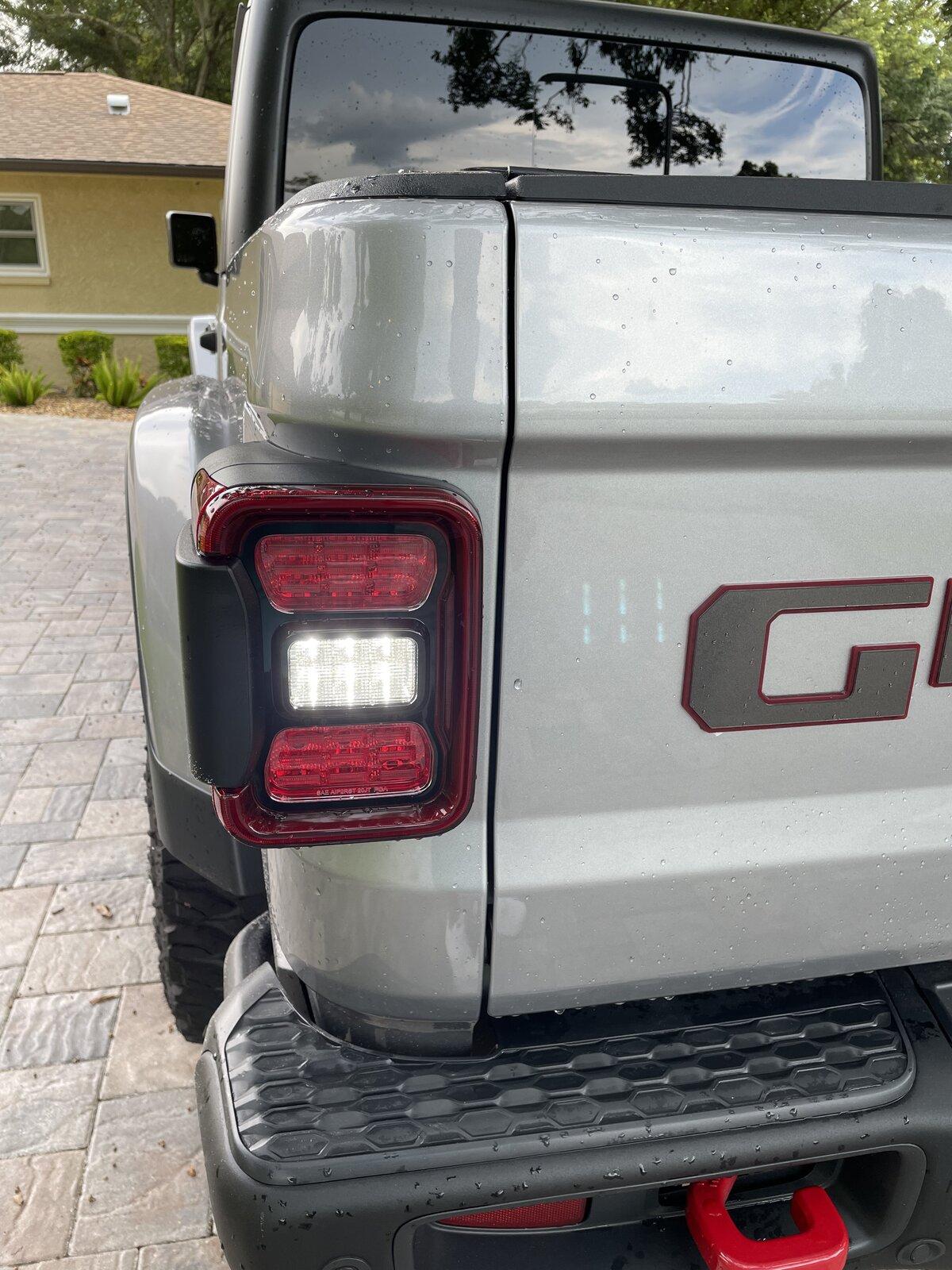

did you ever find a fix for this. Realized I’m having the same issue. Got the tazer about 3 weeks ago but I don’t drive my JT a lot so I could have been having it since. But got flagged down on it today. Only the left side reverse light on. In reverse both come on. And oddly enough the lights at the license plate don’t come on in reverse.
top pic is in drive . Bottom is in reverse.

Software was already up to date but checked for that anyways. Doing a full reboot currently after unmarrying it and 2 full sleep cycles. We will see. I’ll let you know.

So far the one reverse light on in any gear issue looks to have been rectified. Don’t have another person available to confirm if both come on in reverse. I assume it’s good though.
However I’m wondering if the lights next to the license plate are supposed to come on in reverse. I’ve only have my JT for a few months so I can’t remember if they are supposed to be on in reverse or if they’re supposed to be off. I think they’re supposed to be on in reverse because I’ve seen people on here complaint about how they shine in the back up camera. Plus I think I may remember seeing mine on before backing up when looking in the back up camera. Maybe you can confirm. In any case, those lights are off in reverse. But the random reverse light in the tail seems to be fixed (as of now).

The tazer turns them off when in reverse to reduce glare… I believe if you go to their site and read manual it mentions that.

Ok that makes sense. I didn’t know it did that automatically though. I was racking my brain trying to think if I had really changed that setting considering I didn’t even get into the lighting section at all. So if I had I would have been inadvertently.
So you’re saying it does it automatically? If so that’s fine I Just didn’t see it in the Manual although I could have over looked that.
UPDATE: found this in their website:
“-Automatically blanks license plate lights when in Reverse on Gladiators, to remove glare on the backup camera at night.”
