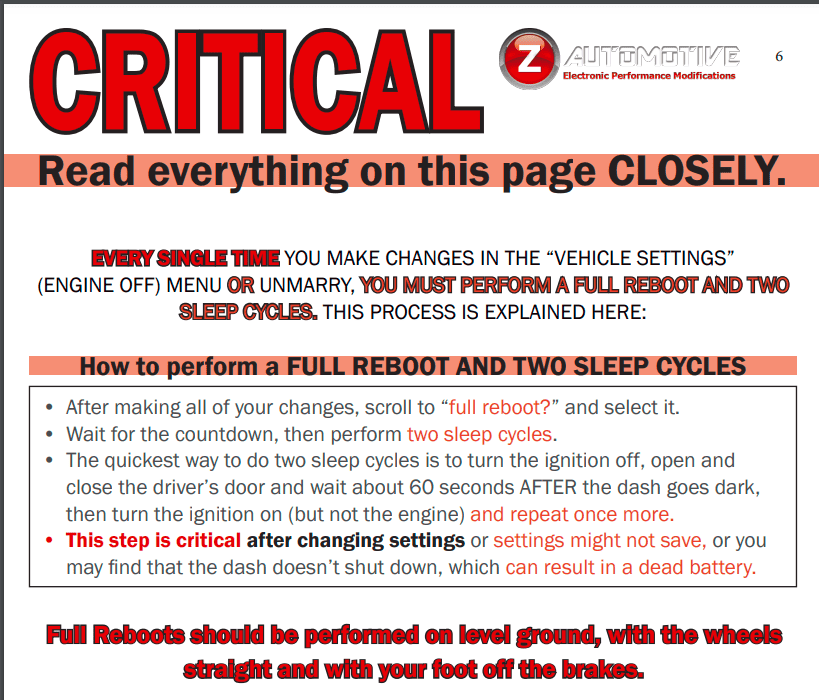

1: Did you update the Tazer to the latest firmware before installing?
2: Did follow the Tazer instructions EXACTLY in regards to doing the reboots and sleep cycles after you installed the Tazer and made programming changes?
The vast majority of issues people have with the Tazer can be fixed simply by following all the instructions instead of "figuring it out".

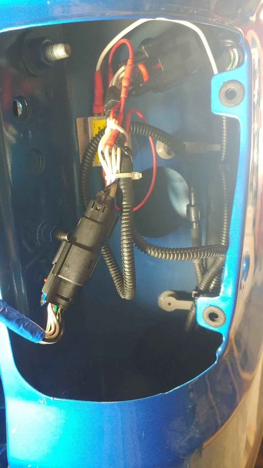

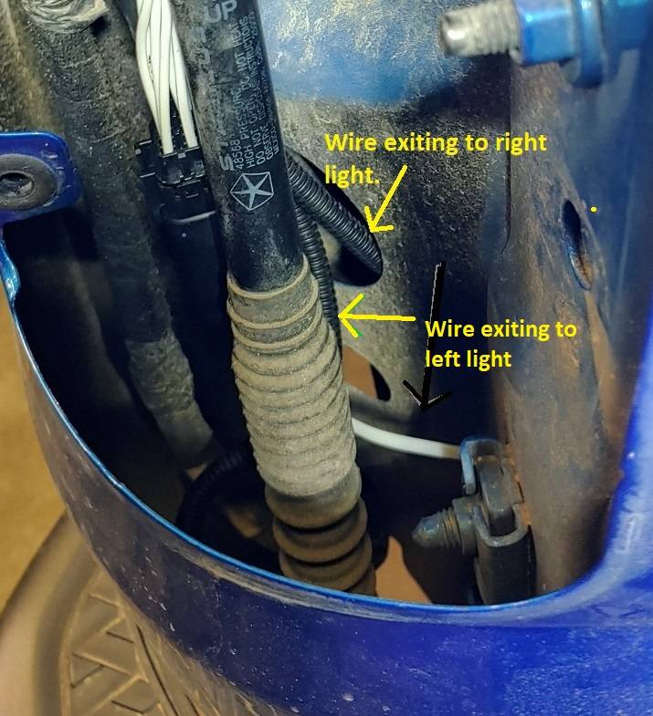

They'll feed off either side - most install using the left but it doesn't really matter. I connected mine to the left on my 2020, and to the right on my 2022 because I also added a wire to power them with an aux switch and it was more easily done behind the right tail light.
The only way to know which side these were powered from by the installing person, is to look under the truck to see which directions the wires come from.
This was my 2020, the light in the right end of the bumper - the wire coming from the left side of the truck-
Jeep Gladiator Tazer Mini + Oracle Tail lights and reverse lights = a problem? 20210702_122550

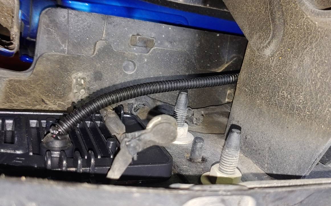

My first install on the 2020 -
Jeep Gladiator Tazer Mini + Oracle Tail lights and reverse lights = a problem? 20210702_122350_HDR
Second install on my current JT -
Jeep Gladiator Tazer Mini + Oracle Tail lights and reverse lights = a problem? 20220728_152905

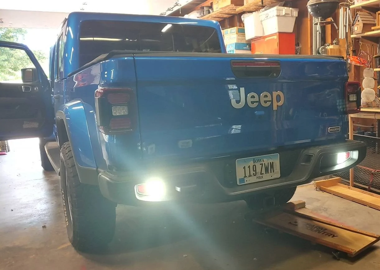

Truck is off, engine not running, aux switch on - handy for hooking up trailer, loading and strapping my cars onto trailer in the dark, etc. ->
Jeep Gladiator Tazer Mini + Oracle Tail lights and reverse lights = a problem? 20220728_153407_HDR
