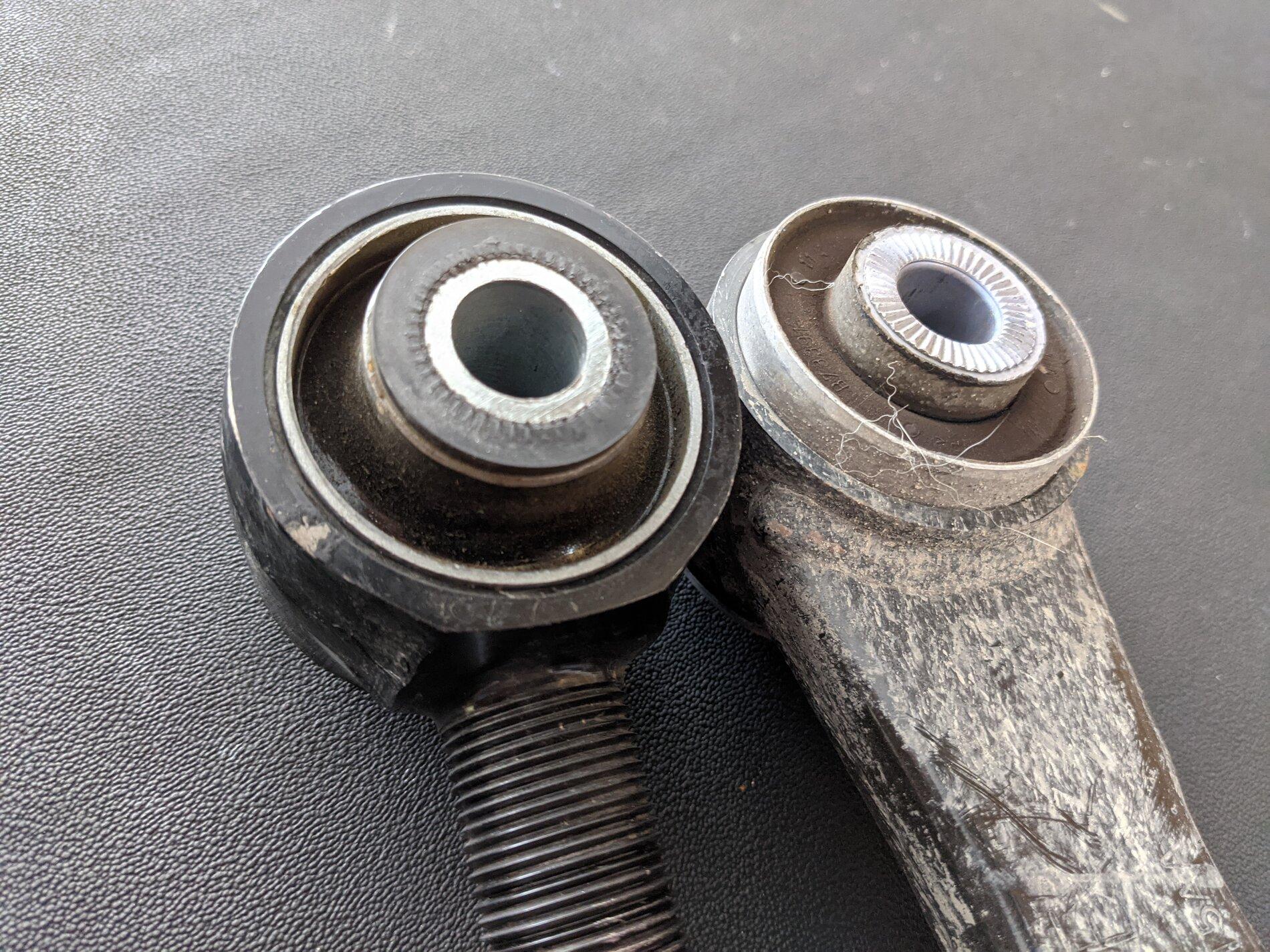

Ok getting into it. First pic is stock poly vs Clayton Giro. I did not really notice any difference in on-road performance from the bushings but it definitely helped with axle positioning to have adjustable.
It is easy to see the Giro will articulate more than the stock poly based on its design. But ride quality was indiscernible between the two.

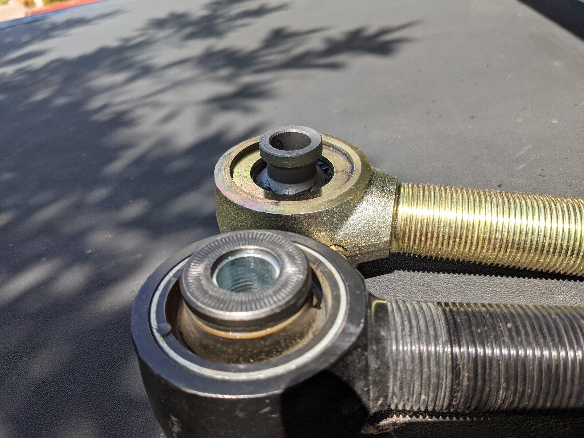

Now to Johnny versus Giro. There's a lot of forum posts and videos about Johnny joints being more susceptible to NVH and reduced ride quality. So now that I went from all Giro to Johnny how's it ride?
Much better imo. Noticably better. The discussion of NVH that the Johnny can transmit I understand and maybe if you have something like a hot rod or a Johnny on both ends that could happen but you still have a Giro axle side to dampen, and the Johnny lets the axle move much easier. The truck feels more planted, like it's adjusting to the road better. The NVH I was expecting seems to have just disappeared by the fact that the axle can just move freely to begin with.
Jeep Gladiator Joints.  Stock vs Giro vs Johnny in Clayton arms. PXL_20210709_220337230
