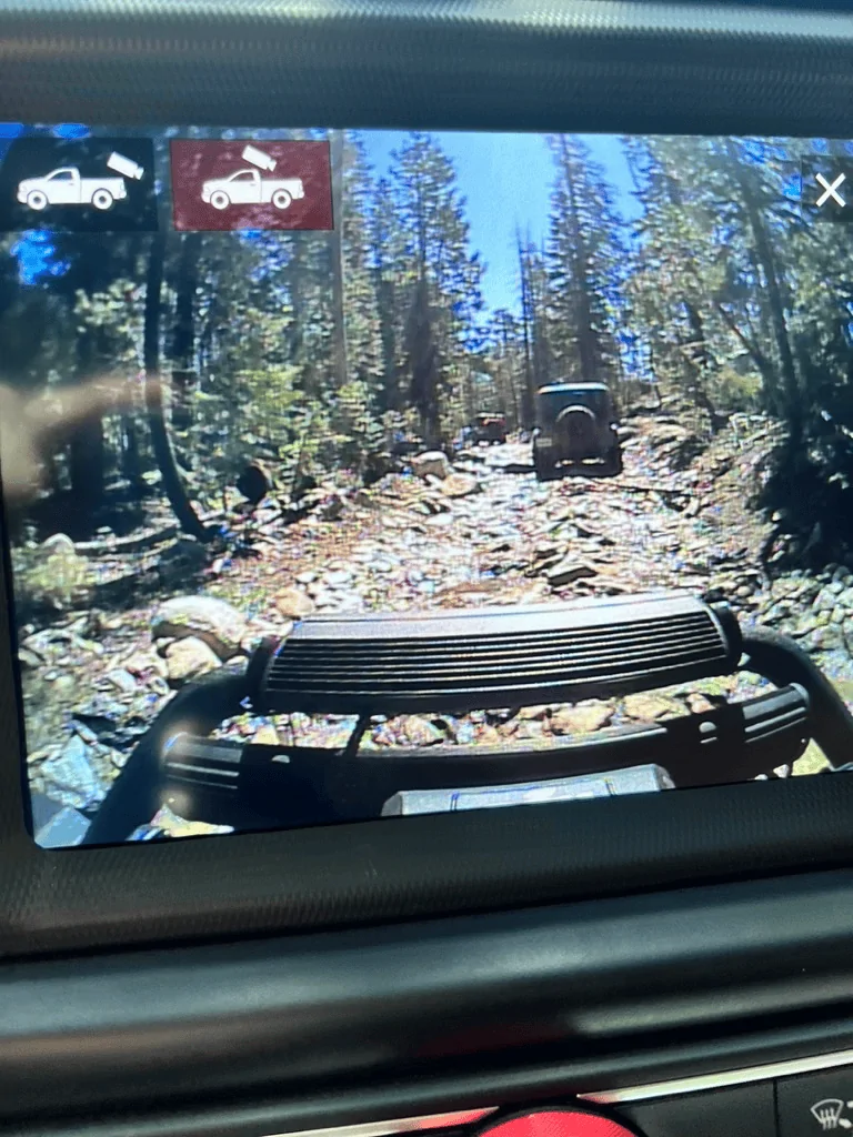

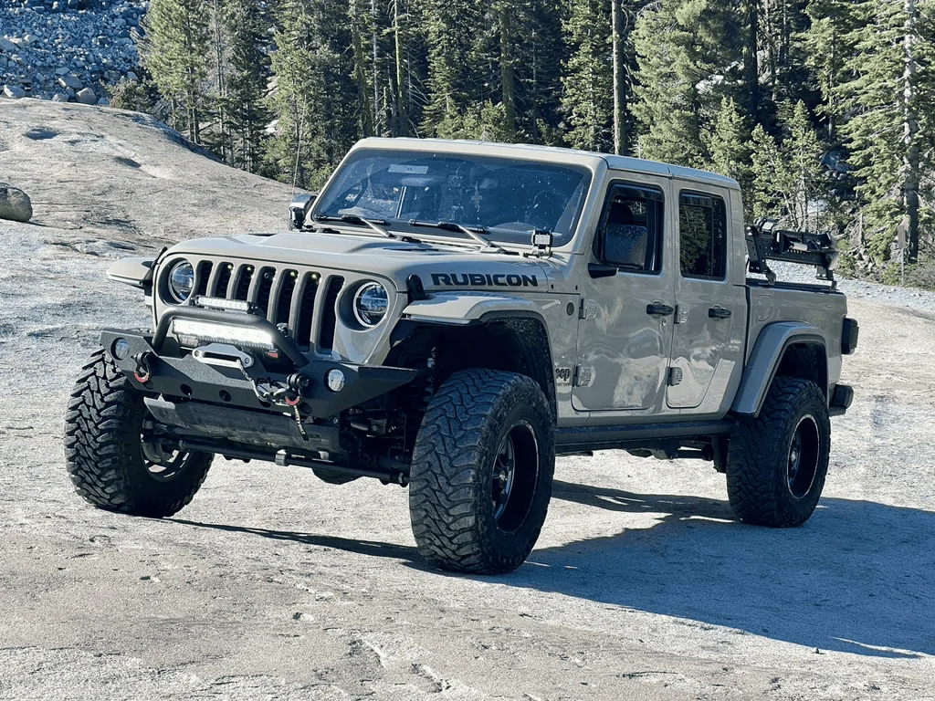

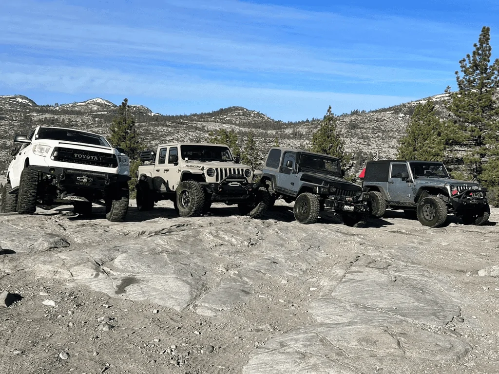

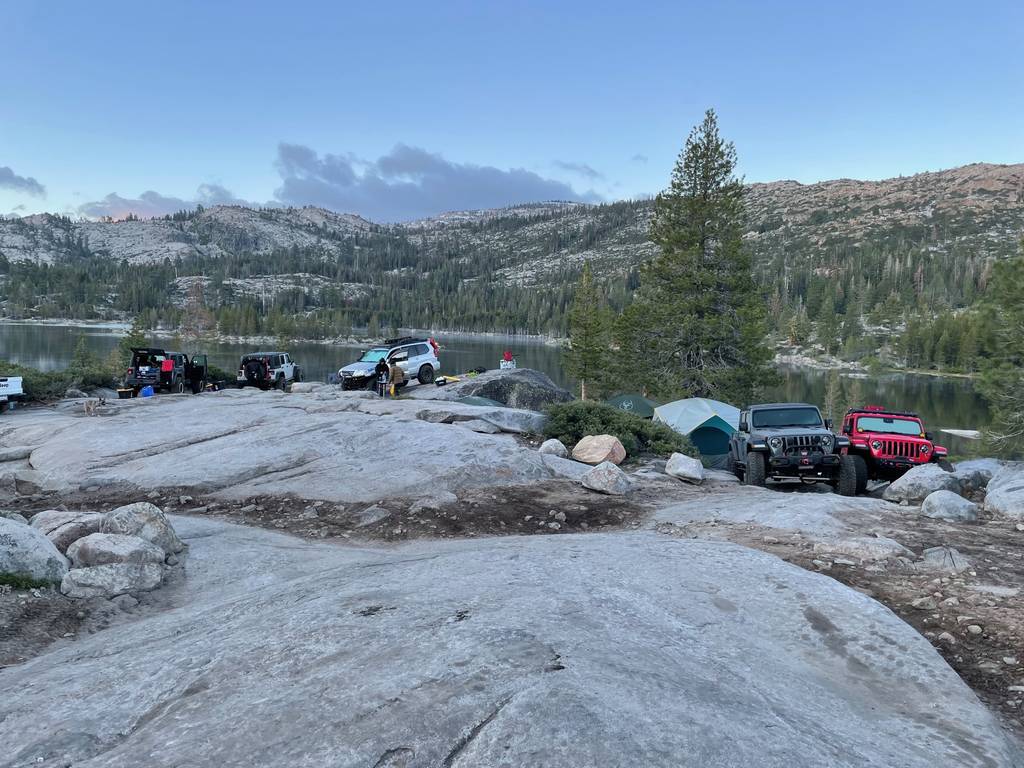

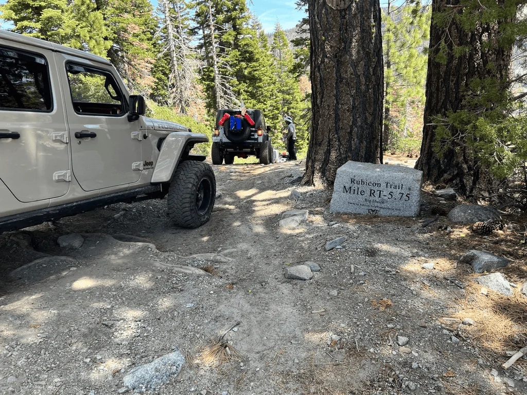

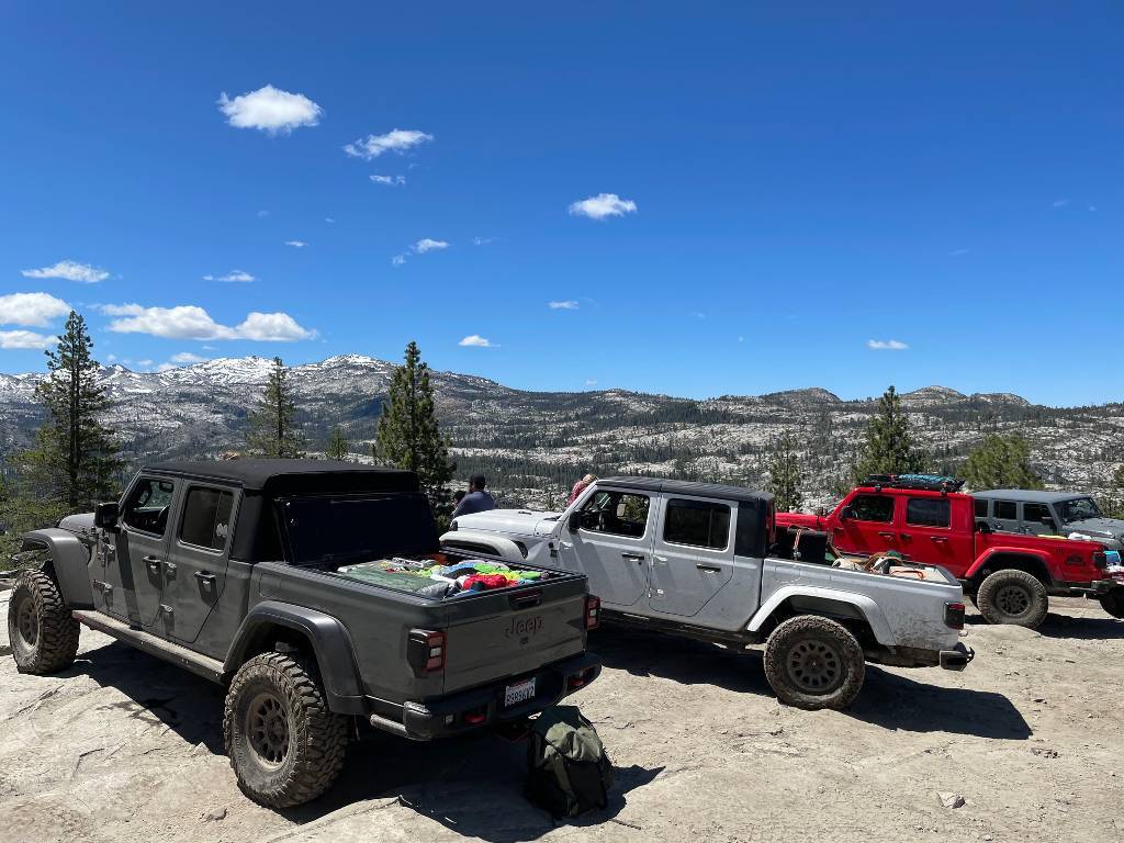

I agree with Summitdan. We did "The Rubicon Trail" last year, and one guy in our group had a max tow with 35 inch tires and I believe a Mopar lift, or maybe no lift, and no winch. I must have winched him 15+ times in 3 days. He kept getting hung up on the boulders and the higher geared transfer case in the max tow was no help -- spin city. He was also a "send it" type guy, so, he made it through many obstacles with that attitude that was impressive. He had no additional protection underneath and he made it through the trail without breakage, but, all that work winching did hurt our progress and the "fun factor" for some other guys in our group. My view is that you need 37s, 3.5 inch lift, all skids underneath, Rubicon Transfer case (optional, but, easier), Lockers (optional but, easier), & a Winch to run "The Rubicon Trail". Without Lockers, you will have to winch at some point in time, guarenteed - so, it is best to have your own winch, or, you will have to have somebody behind you to pull you backwards for another try. Note: You are in 1st gear 4low the whole way climbing boulders with lots of tight turns.
That being said, "The Rubicon Trail" was the funnest, most technical, most challenging trail I have ever done. I cannot wait to run it again.
Note2: If you can only invest limited funds, and insist on running the trail, your best investment will be to buy a winch and a have a buddy infront of you that has a "Rubicon trail" capable rig where you can hook up and winch forward.
Note 3: You can bring an extra u-joint with you in case you break one, but, with 35" tires, I do not think you will break anything. It is possible to tear up the boot and rip off the weights on your rear driveshaft, but, that will not effect your capability to drive the trail.
Jeep Gladiator Rubicon Trail vs Drive Shaft & U-Joints SQu6xb
Jeep Gladiator Rubicon Trail vs Drive Shaft & U-Joints Tx1VN9
Jeep Gladiator Rubicon Trail vs Drive Shaft & U-Joints 7lJyg1
Jeep Gladiator Rubicon Trail vs Drive Shaft & U-Joints CjwvCL

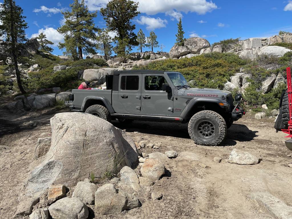

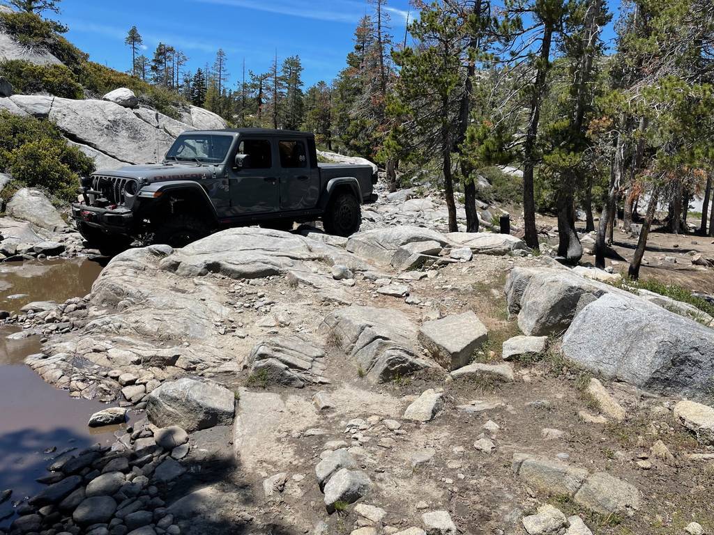

I made it through last summer on a Mopar lift and 35s. Just use good judgment on which obstacles to try. You'll make it through and create some awesome memories.
Jeep Gladiator Rubicon Trail vs Drive Shaft & U-Joints 1686331167424
Jeep Gladiator Rubicon Trail vs Drive Shaft & U-Joints 1686331223586
Jeep Gladiator Rubicon Trail vs Drive Shaft & U-Joints 1686331300476
Jeep Gladiator Rubicon Trail vs Drive Shaft & U-Joints 1686331345232
