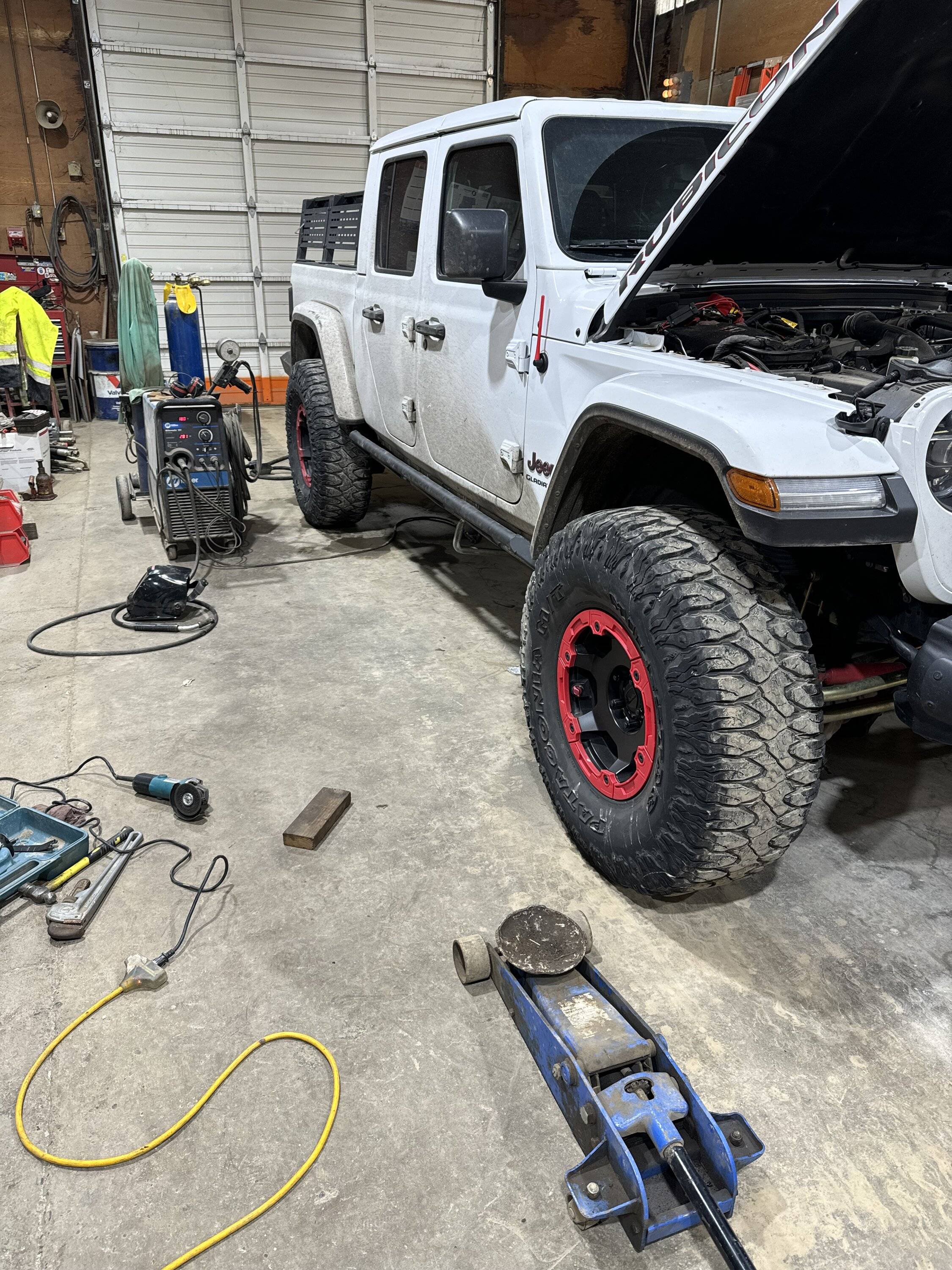

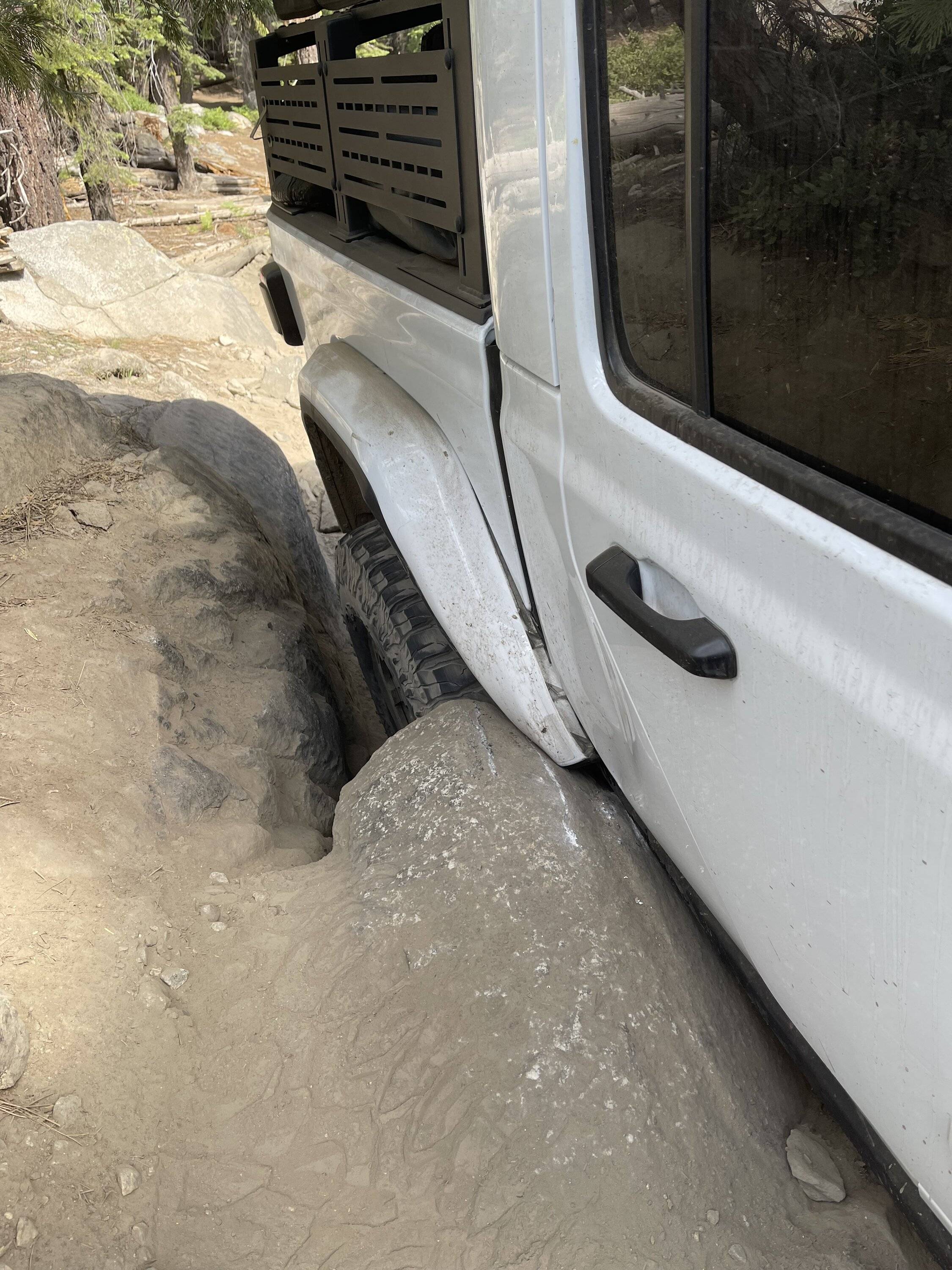

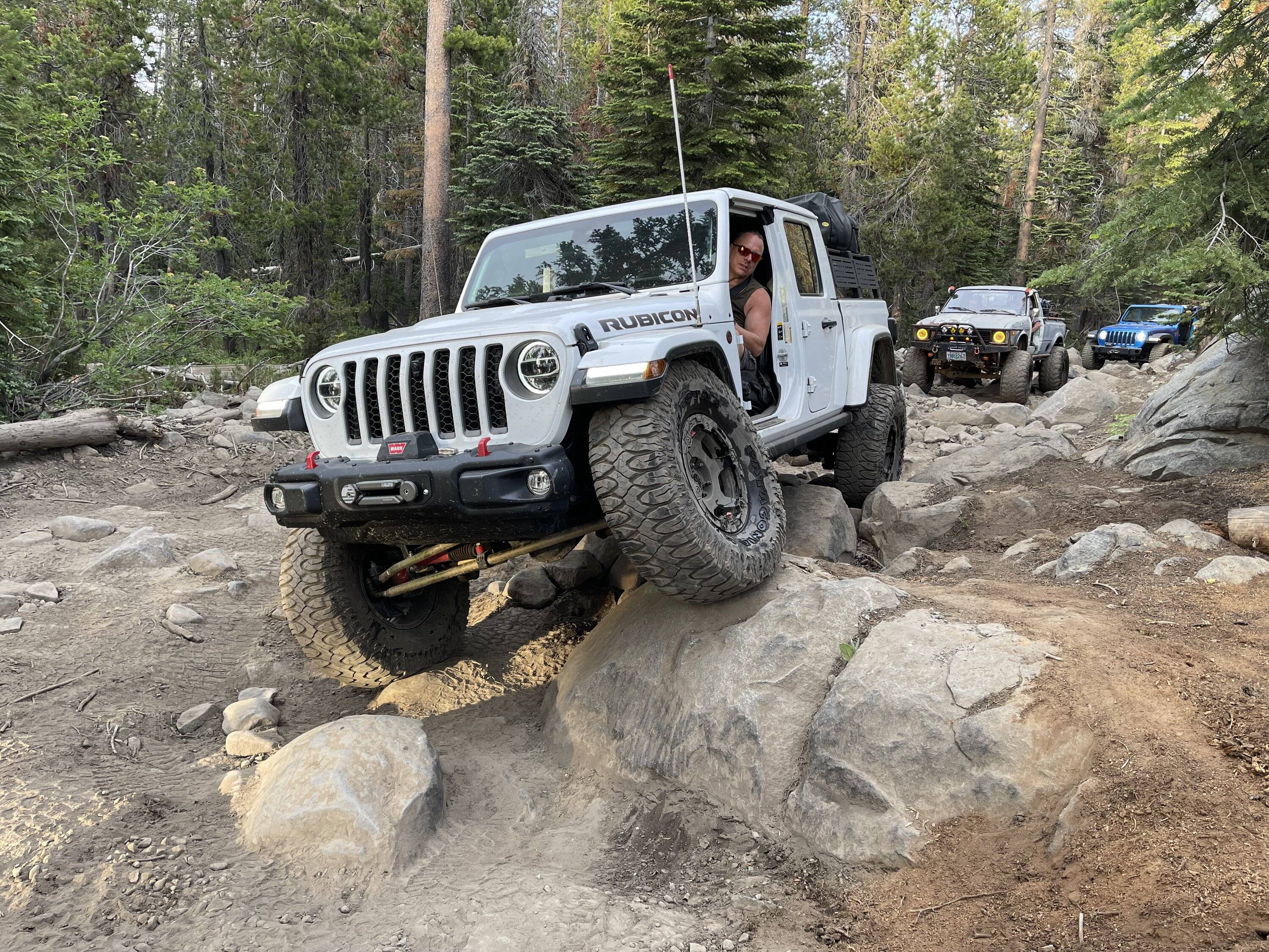

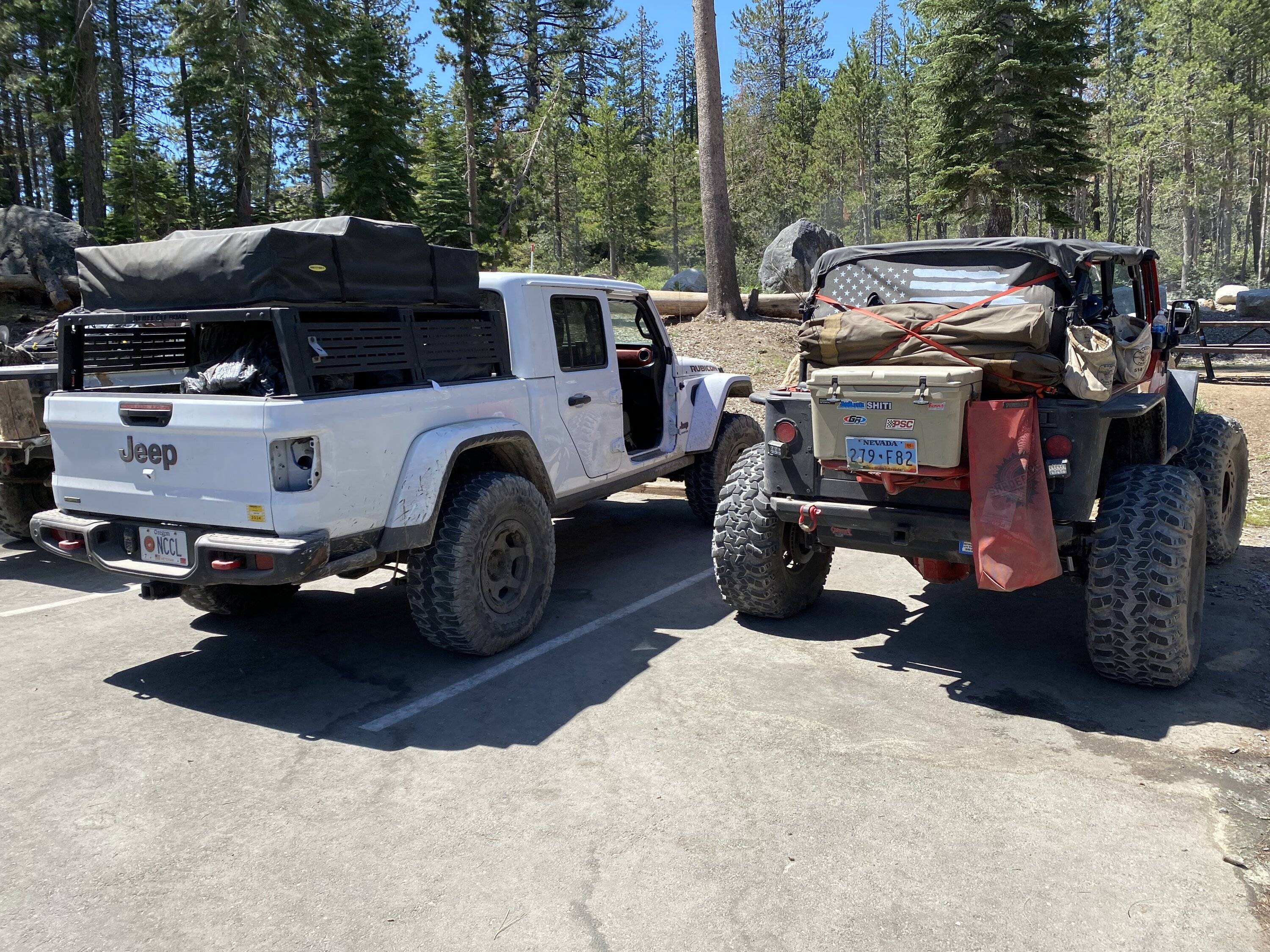

I ran it last June, we went both ways. The factory skids are junk, the one on the passenger side bent and damaged the body a little. Rear bumper was bent up. Flares took a beating too but are still in good shape. If you have a diesel you NEED to put a skid under the fuel filter housing. Was a good time, 4 nights on the trail. I tagged a taillight so I removed them for the rest of the trail. I replaced the rear bumper and sliders so far with Motobilt.
running metalcloak game changer 3.5
38 milestars
