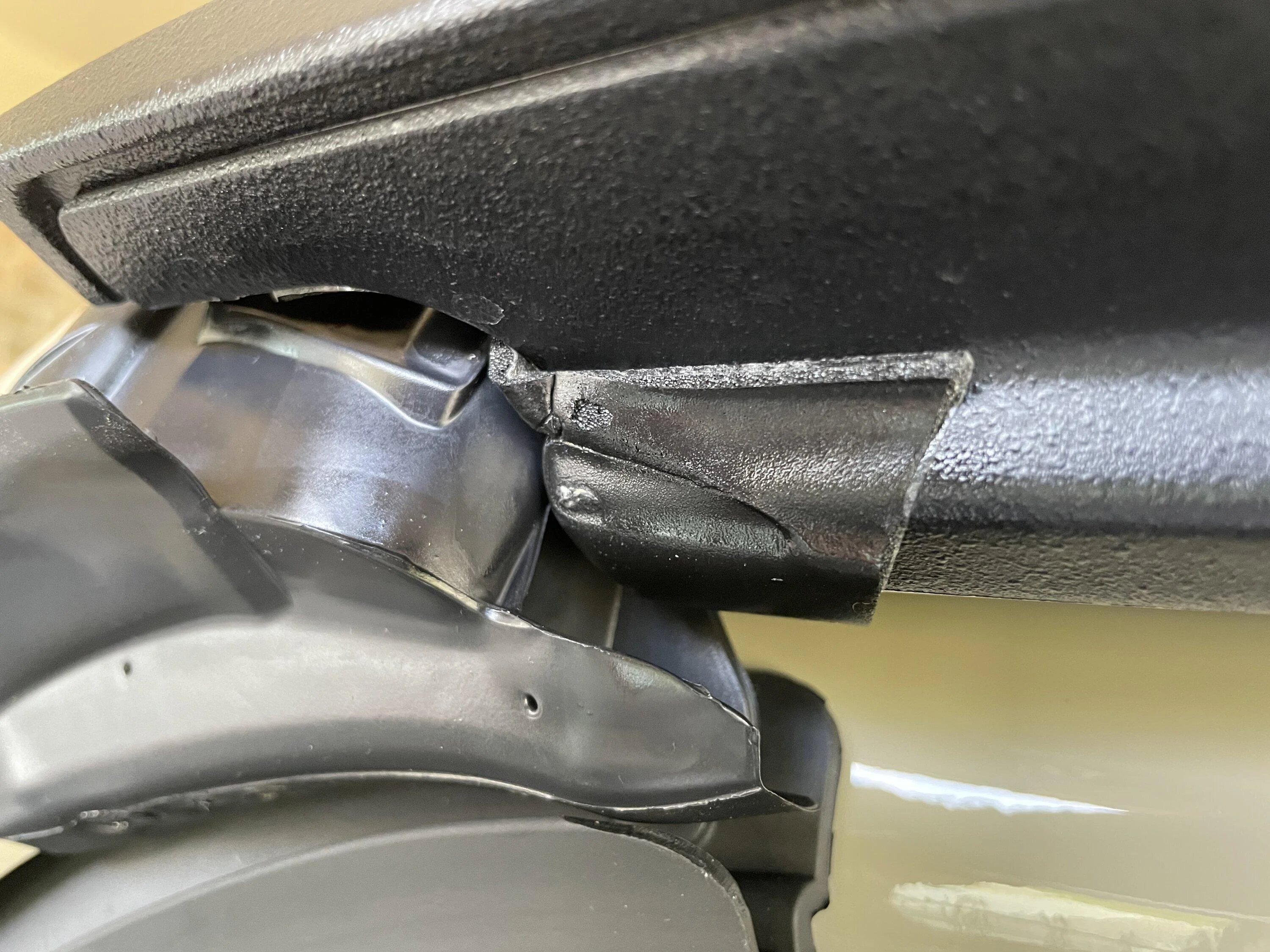

Does it seem like the rattling is coming from the very front left corner of the driver side panel?
Mine started rattling a week after I picked it up and if I only closed the door to the first click of the latch it would not rattle. I determined the rubber seal on the panel was making the rattling sound (really a loud clicking of the two dry rubber surfaces) so I put some silicone grease in the flap and it went away. This was the front outer flap on the panel seal only, I didn't put grease on the door seal. My latches were all perfectly tight so no adjustment was needed there. I can probably get a picture of the area if I didn't describe it well enough.

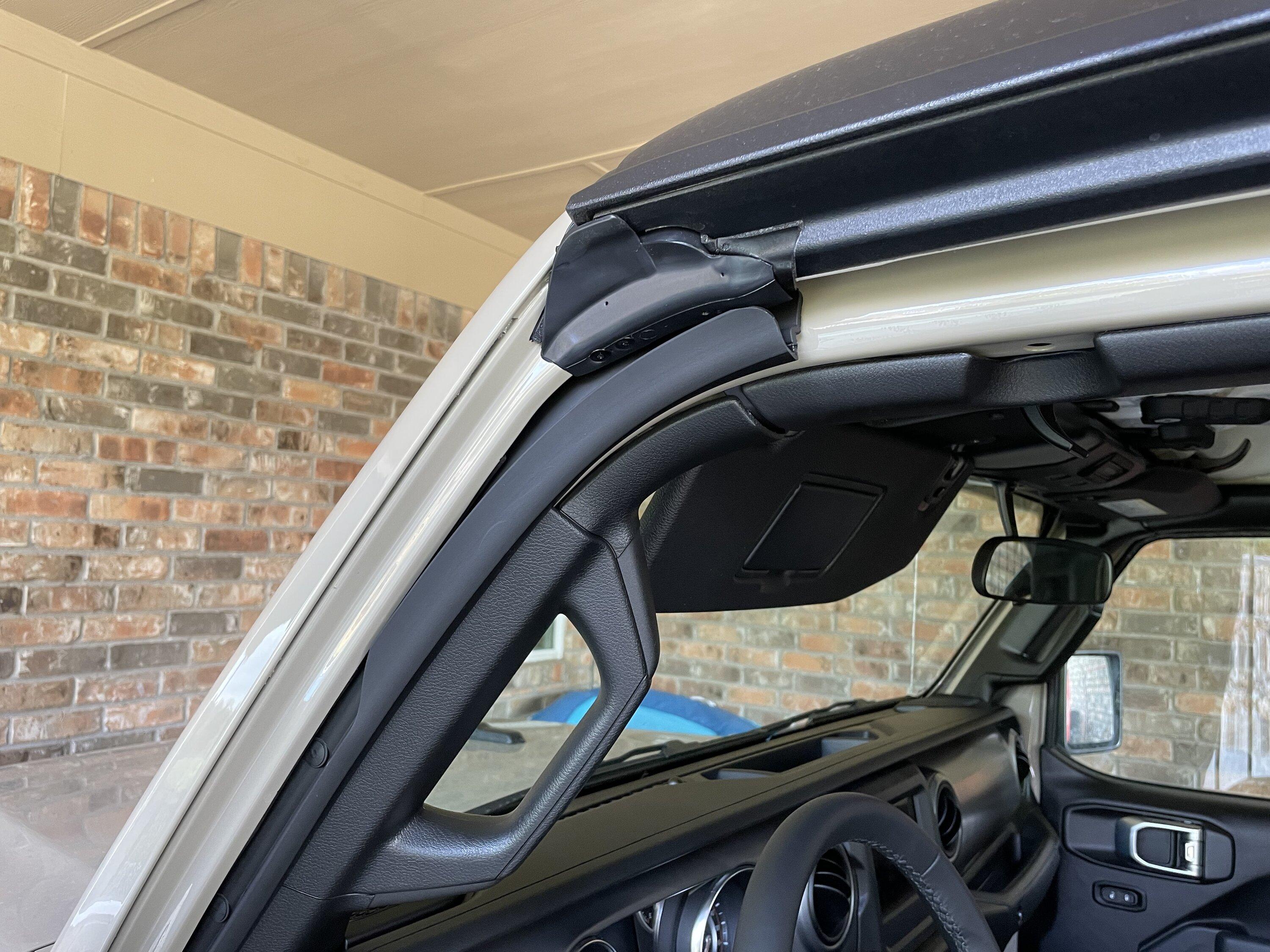

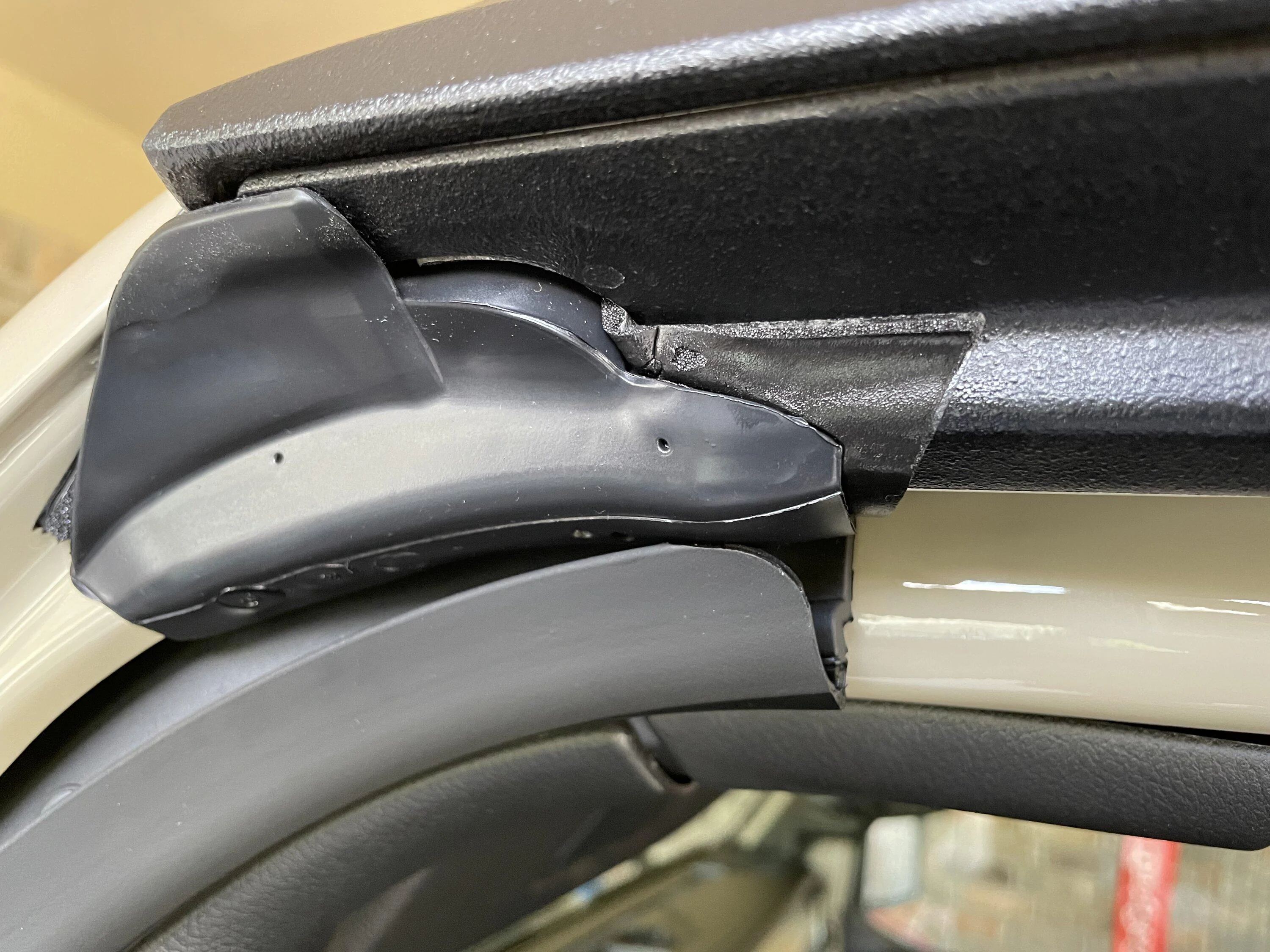

Sorry for the delay, rain and a late baseball practice took priority. In the photos you can see with the freedom panel lifted there is an area on the lower corner that is rubbed, that is where I applied the silicone grease. It is pretty much lined up with the tiny rearward manufacturing hole in the outer rubber seal. That area contacts the door seal when the door is closed so there are three seals being compressed and with them being extra clean and dry they made noise. Note that I only applied the grease to the panel corner. I did not grease anywhere on the outside of the panel where the door seal makes contact, so far no more rattling/tapping noise from it.
Jeep Gladiator JT Hardtop Roof Rattle Seal Area Panel Lifted
Jeep Gladiator JT Hardtop Roof Rattle Seal Area Panel Locked
Jeep Gladiator JT Hardtop Roof Rattle Seal Area General Location
