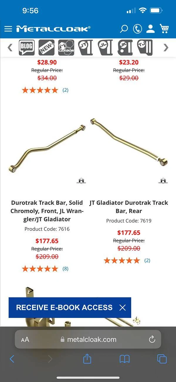

Looking at the Mopar 2 inch lift, and I was wondering if its suggested to install adjustable trac bars both front and rear?
DailyMoparGuy
Gone
Mar 6, 2021
1,547
3,094
Gone
None
Ghost Rider
Definitely. Good deals at Metal Cloak rn. Hell I may grab another rear one since mine doesn’t have the bend. I’m tired of having my spare in the bed lol

Thanks for the tip. I here its a good kit, but not a complete kit. Looking at what other components to get in order to make it complete. Any other suggestions? I'll take them.. Thanks.
DailyMoparGuy
Gone
Mar 6, 2021
1,547
3,094
Gone
None
Ghost Rider
None that come to mind outside of replacing all the control arms. Probably overkill though. I don’t have the Mopar lift kit, so I’m just going off what I’ve read from other owners. As is, I’ve only read good things about it, especially when replacing the track bars.
Edit: If you’re adding a bunch of weight or towing heavy then maybe research more. I’m not sure how the springs handle loads.
