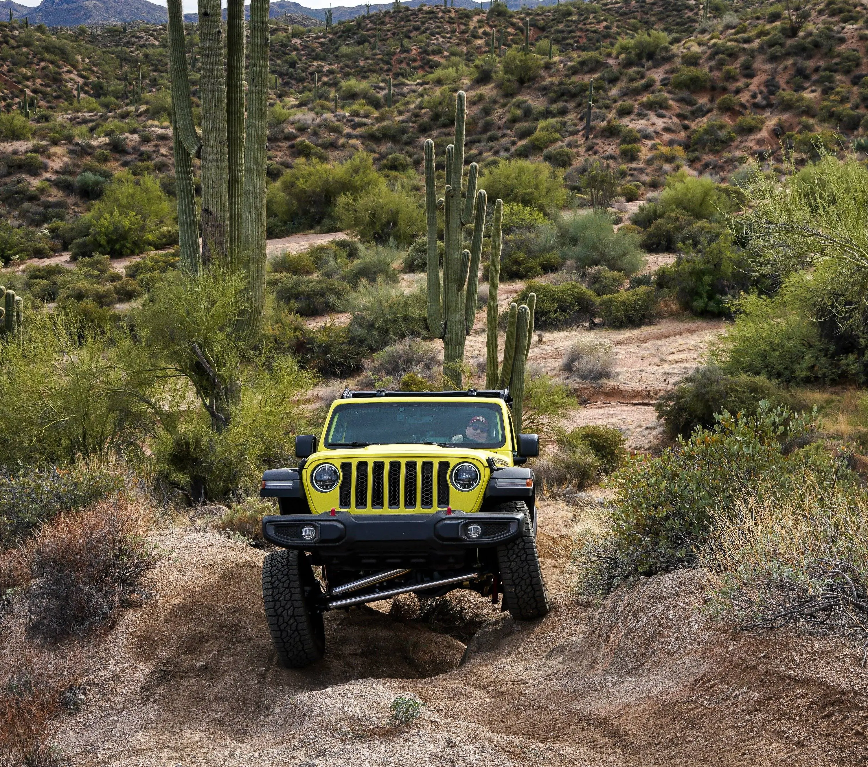

Just went to 37's with 2.5" MetalCloak Gamechanger, still gets around 17mpg on my daily commute. This picture was taken with the factory 33's on it still.

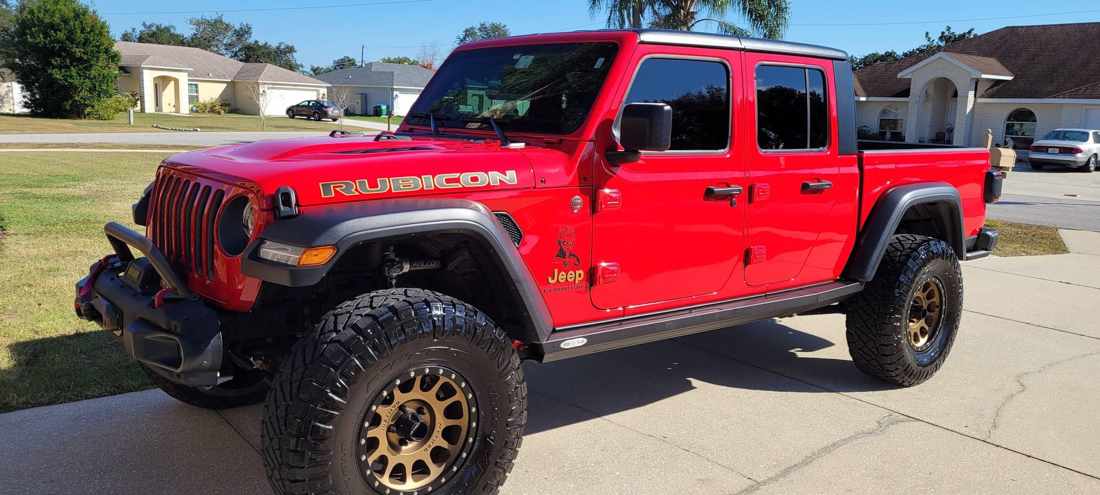

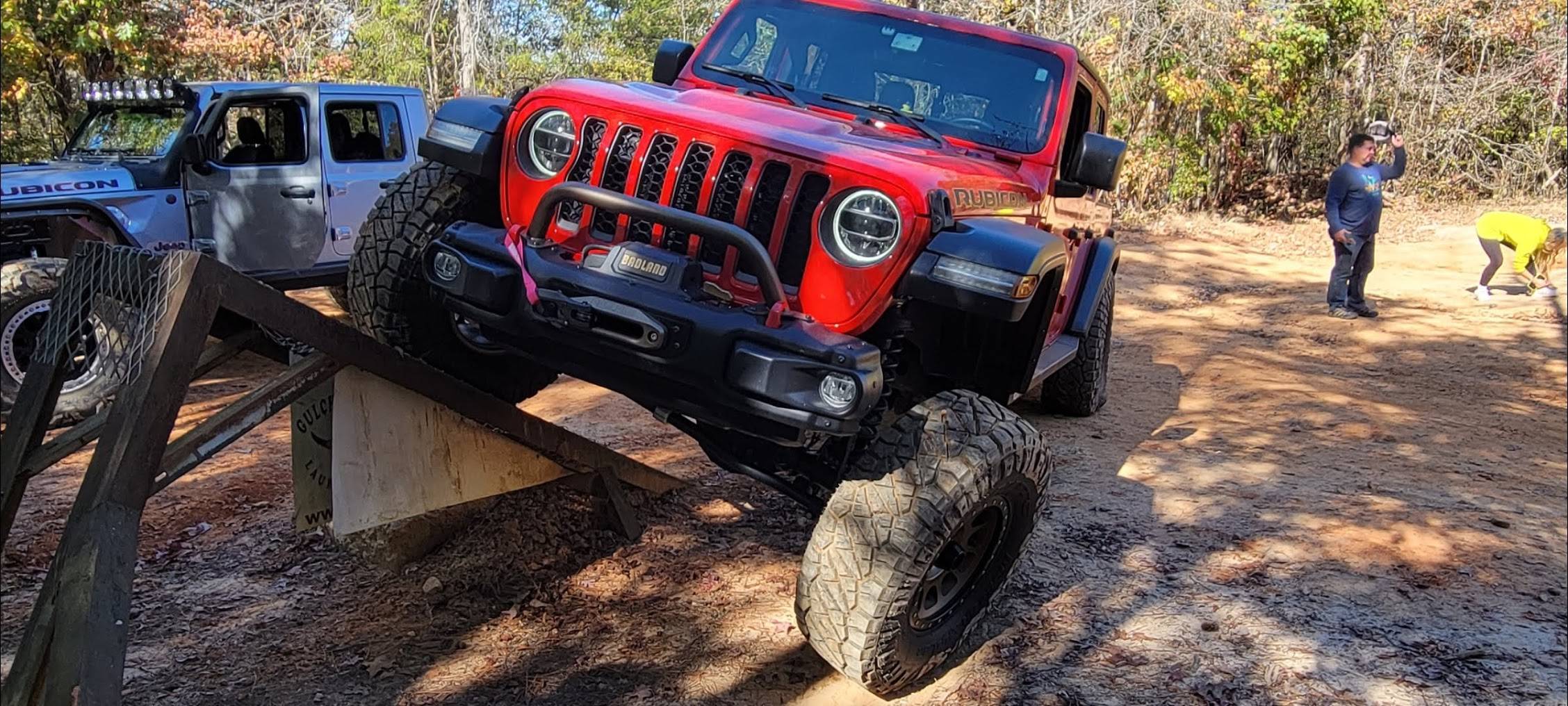

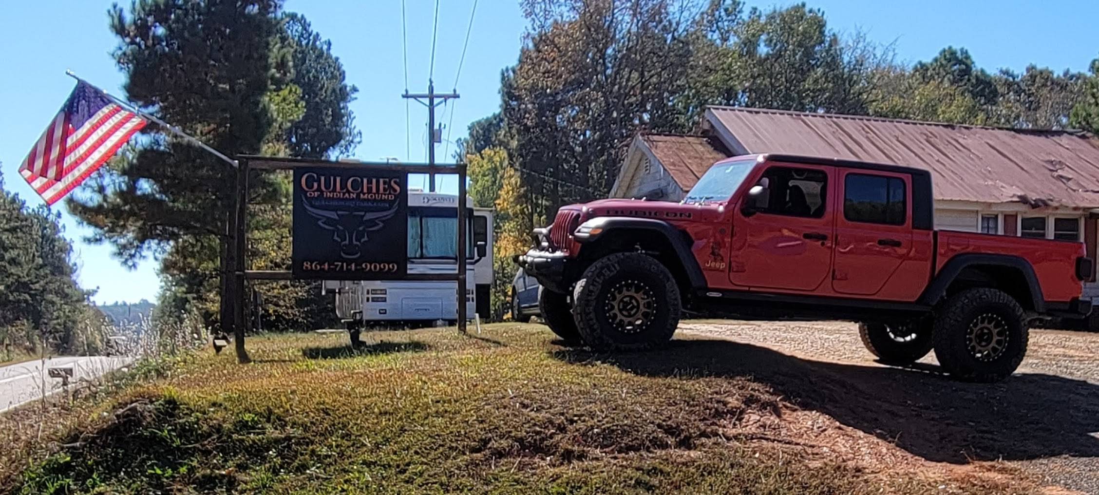

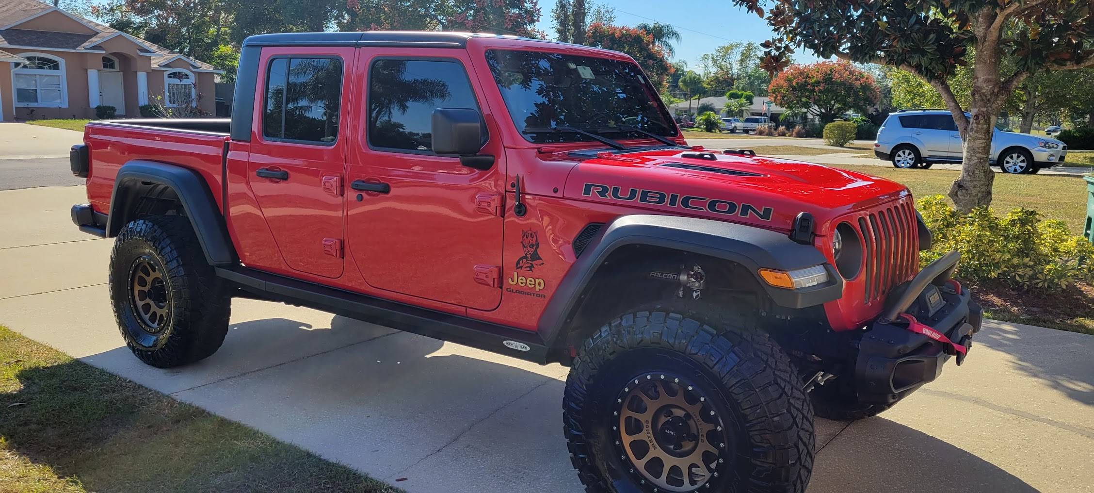

I've got a 2020 Rubicon rolling on 38" tires, 17" rims with 4:88 gears. 3" Rock Krawler mid-arm lift with the 4 link in the rear ( 3.0" Adventure - X PRO "No-Limits" Mid-Arm System - Rock Krawler Suspension ). Combined with the 2.5 DSC Fox Shocks this thing rides better than stock. I put steer smarts HD yeti in the front and PSC hydraulic steering. The only thing it needs is a hemi or maybe the new twin turbo they are putting in the grand wagoneers.
I just got back from a trip to Gatlinburg, TN. From driveway to driveway I got 15.6mpg. That's idling at traffic lights, mountain roads, stops / starts / stuck in traffic and the whole nine.
If you put 37s with 4:88 gears you will fair a little better as I think with a 38" tire I need 5:13's.
Hopefully this will give you and some others some ideas. I can say the RK lift will absolutely flex offroad!
