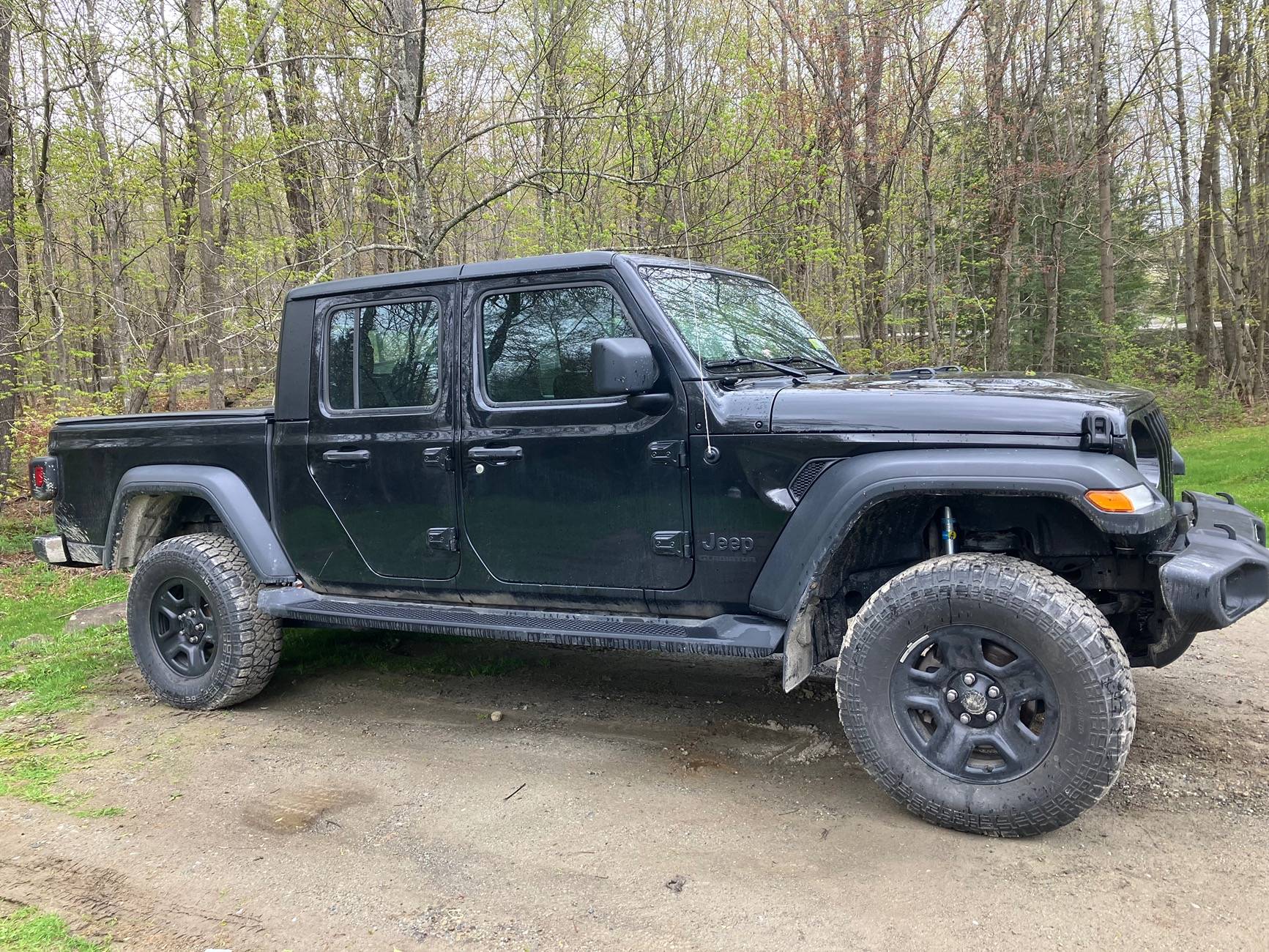

I did synergy 2” front springs and 1” rear springs. Combined with bilstein 5100 lift shocks and the mopar 2” lift front lower control arms. It rides amazing on road, on dirt roads and class 4.

It maintains the rake with the bed empty, but I think it looks good. Here’s a pick on 33’s. Had them on with just a front level kit, but I didn’t like the ride. I may go ‘35’s next but it’s a manual with 3.73’s.

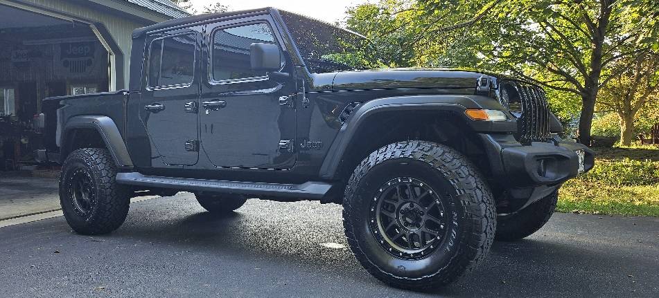

Mopar lift here (was on it when I bought it.) Not sure I'd spend that coin if I were doing it, but it rides very nice. Running 35x12.5r17 Grabbers, just had to trim the front air dam. The 3.73 with auto seems fine for now. I don't see 8th gear on my commute to work but do on a flat highway. If I were to re-gear I'd be moving to 37s.
