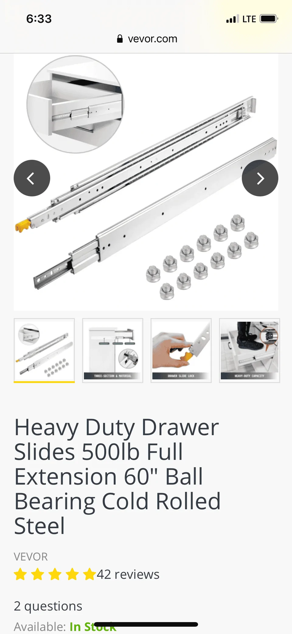

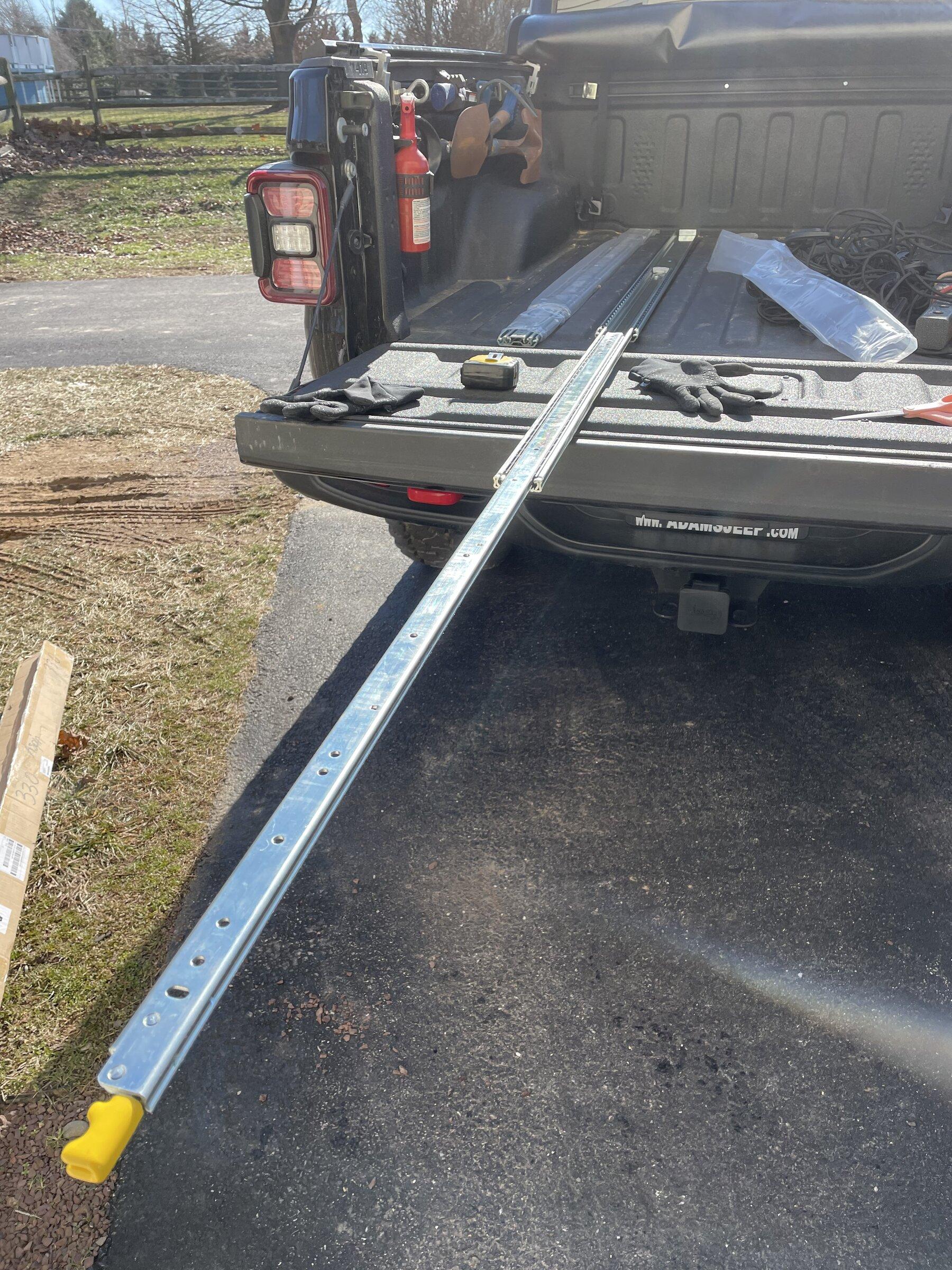

Just ordered extending drawer slides for a DIY slide out type of solution. Thinking more like Bedslide or Cargoglide vs a drawer like decked. The open “tray” seems more versatile. I wanna make it easily removable. Not fully formed yet but I think I can make this work with some wood I have lying around and probably pick up some angle steel or aluminum. Can probably do this for $250-$300 vs paying $1500 for a bought solution.

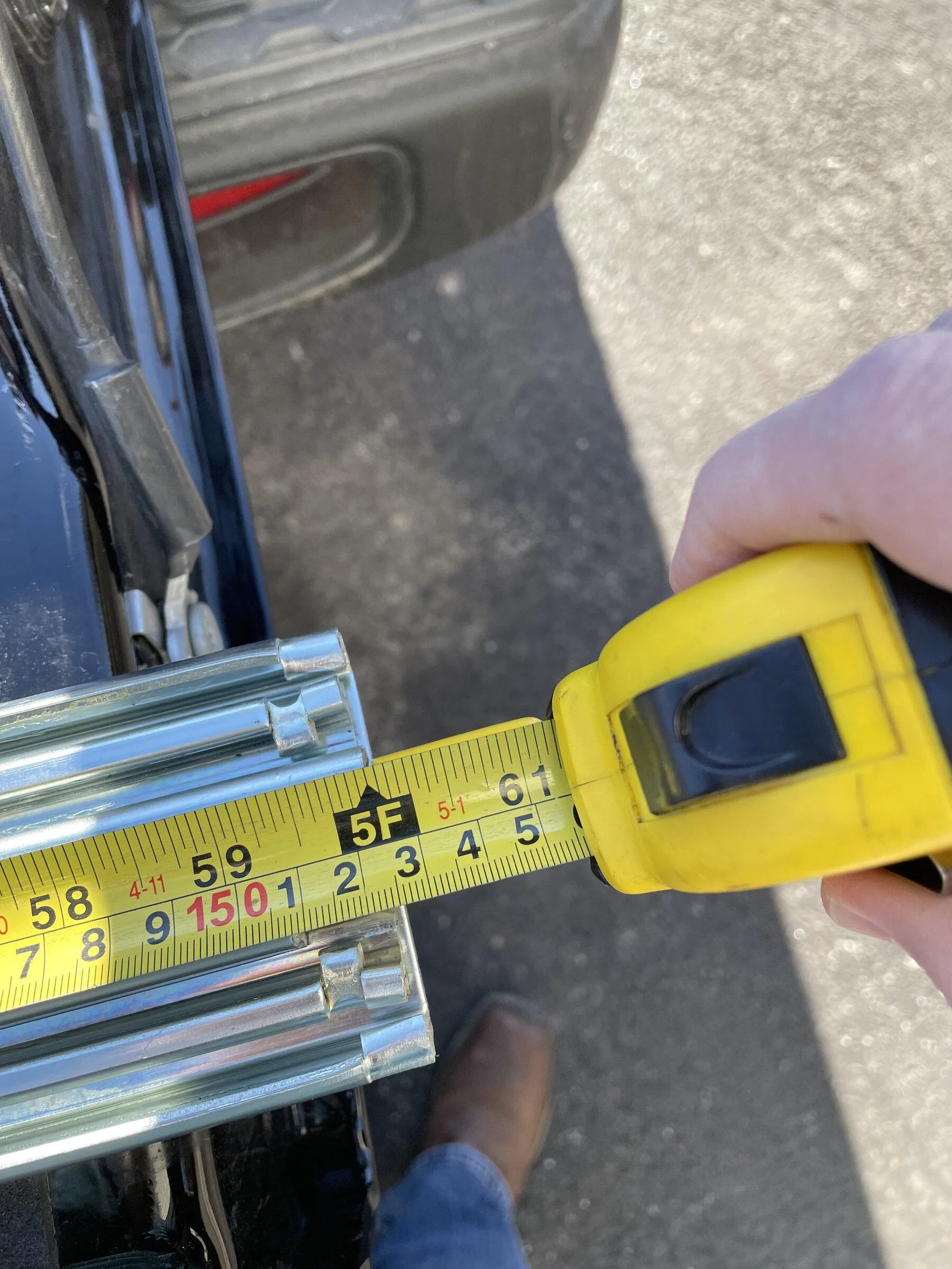

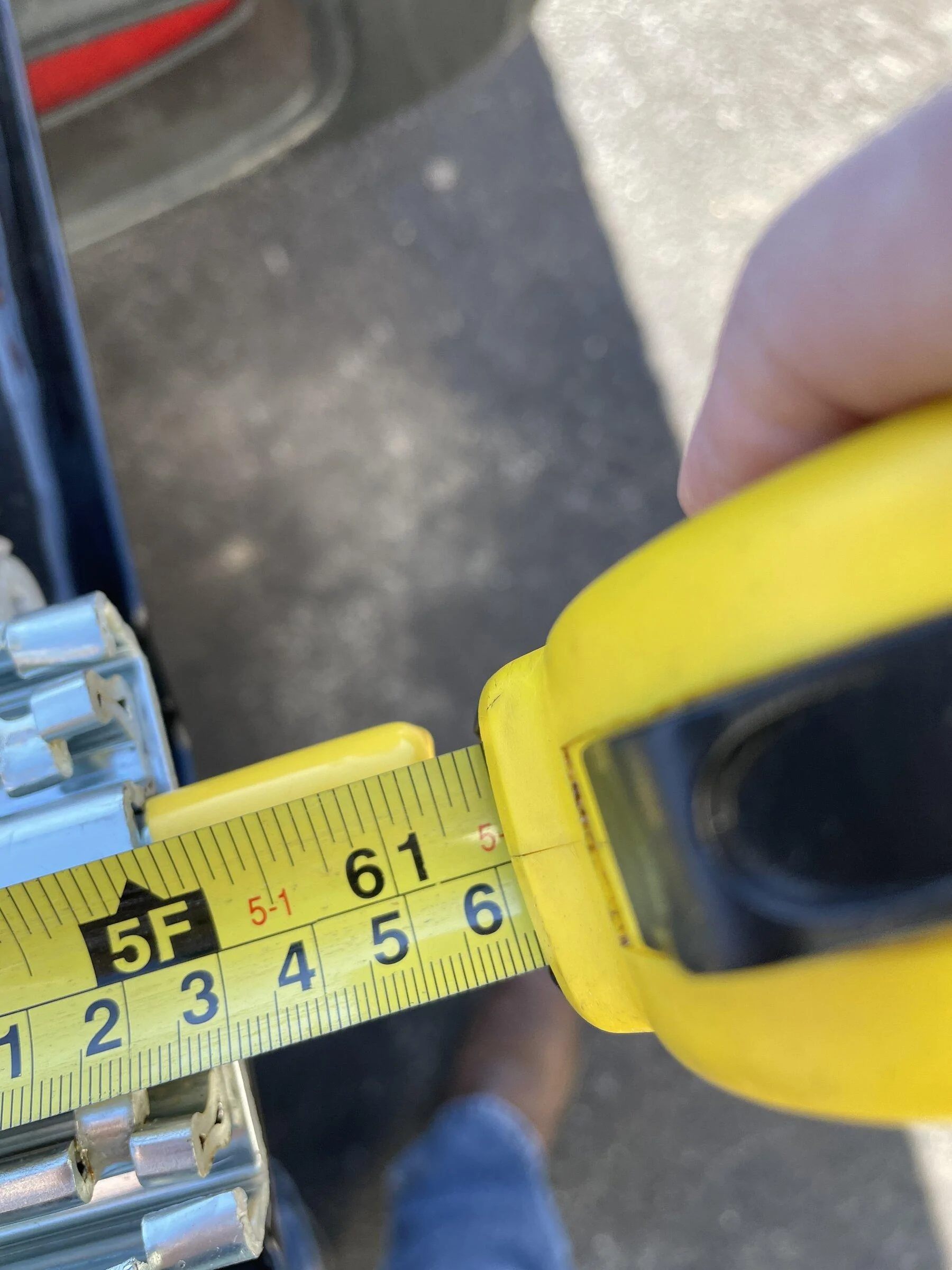

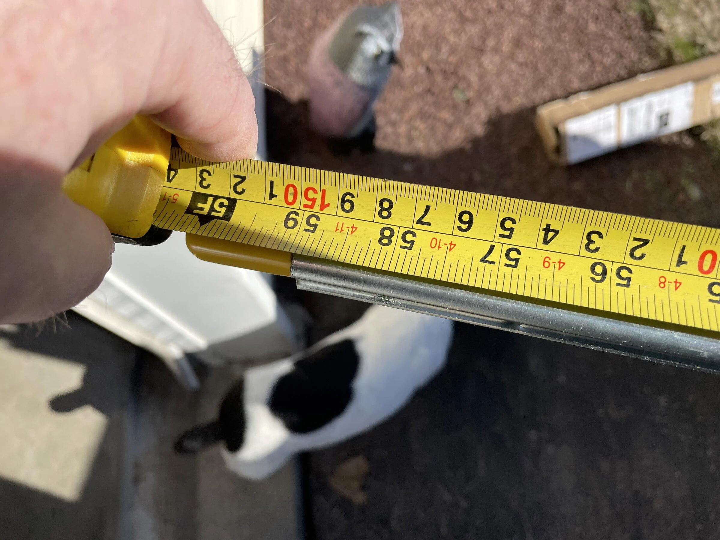

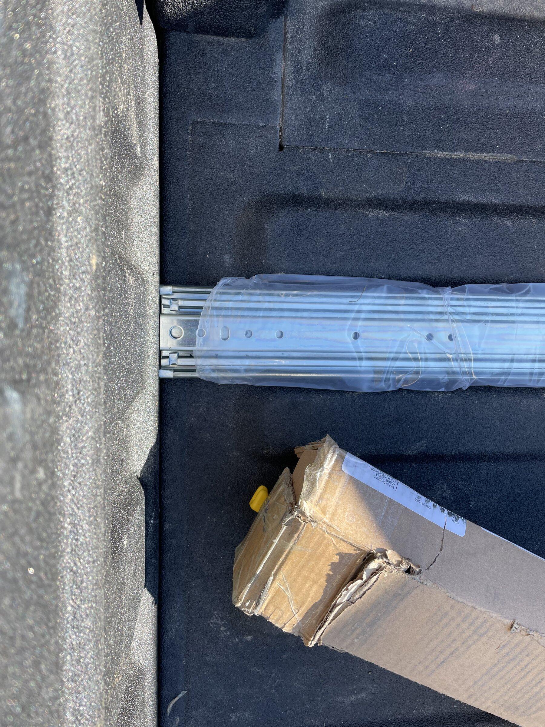

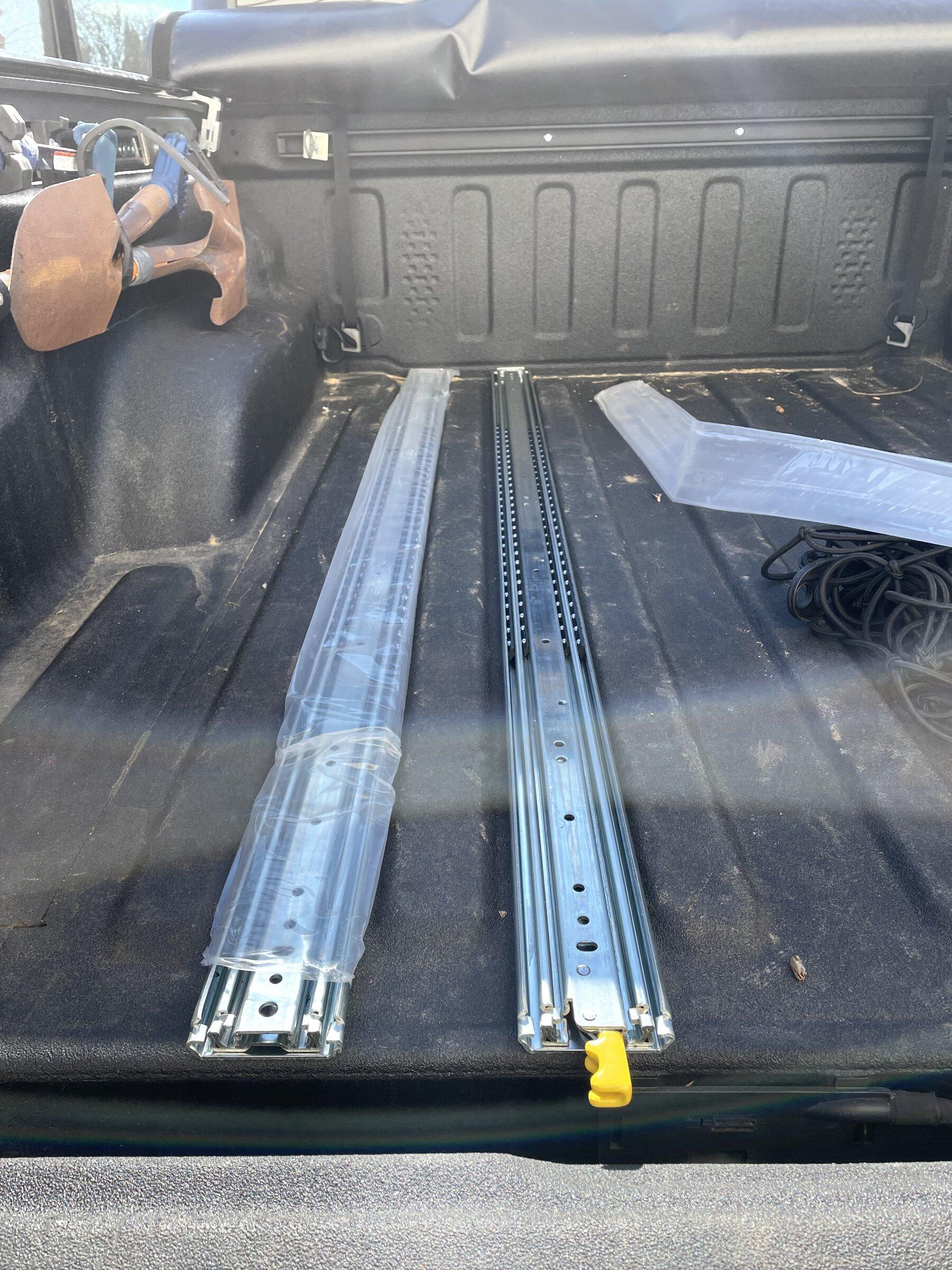

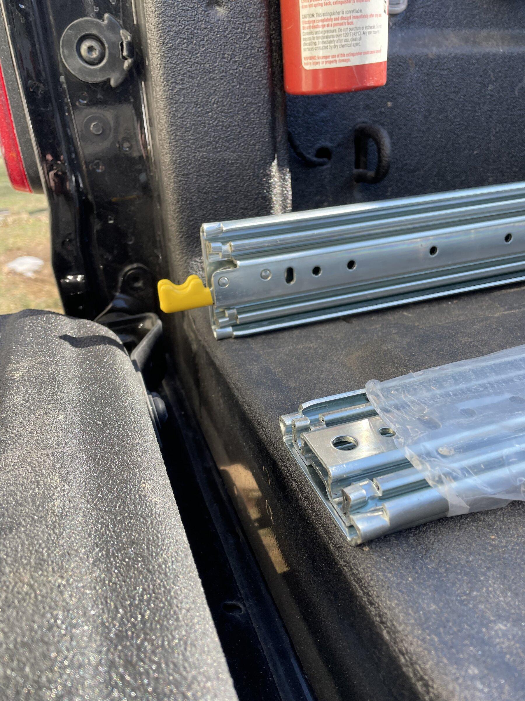

Just got these delivered today. They seem pretty good. They extend out a full 59” or nearly 100%.
Already ran into an issue. I misinterpreted the dimensions. The handle makes it longer than the bed. I’ll need to cut it and make it work a different way so I can close the tailgate. I’ll need to include this in my design - maybe a lifting handle under it in the tray? Not sure.

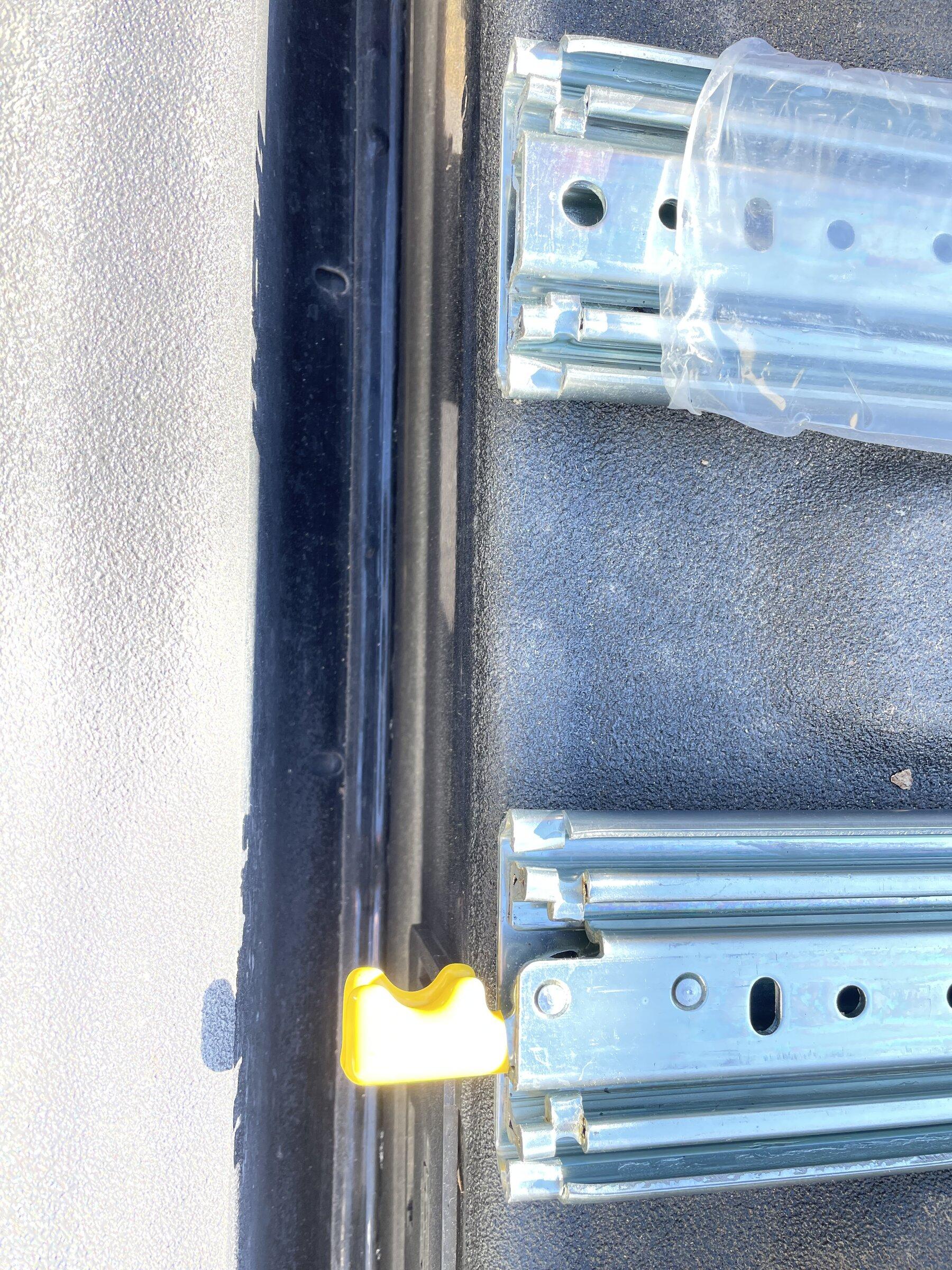

Very close fit for the non locking slide. Probably 1/32” or so.

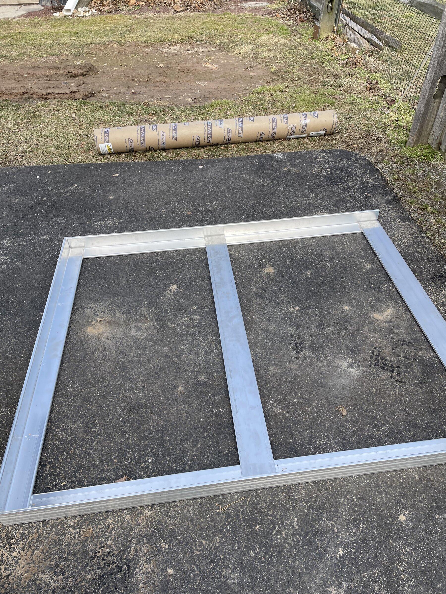

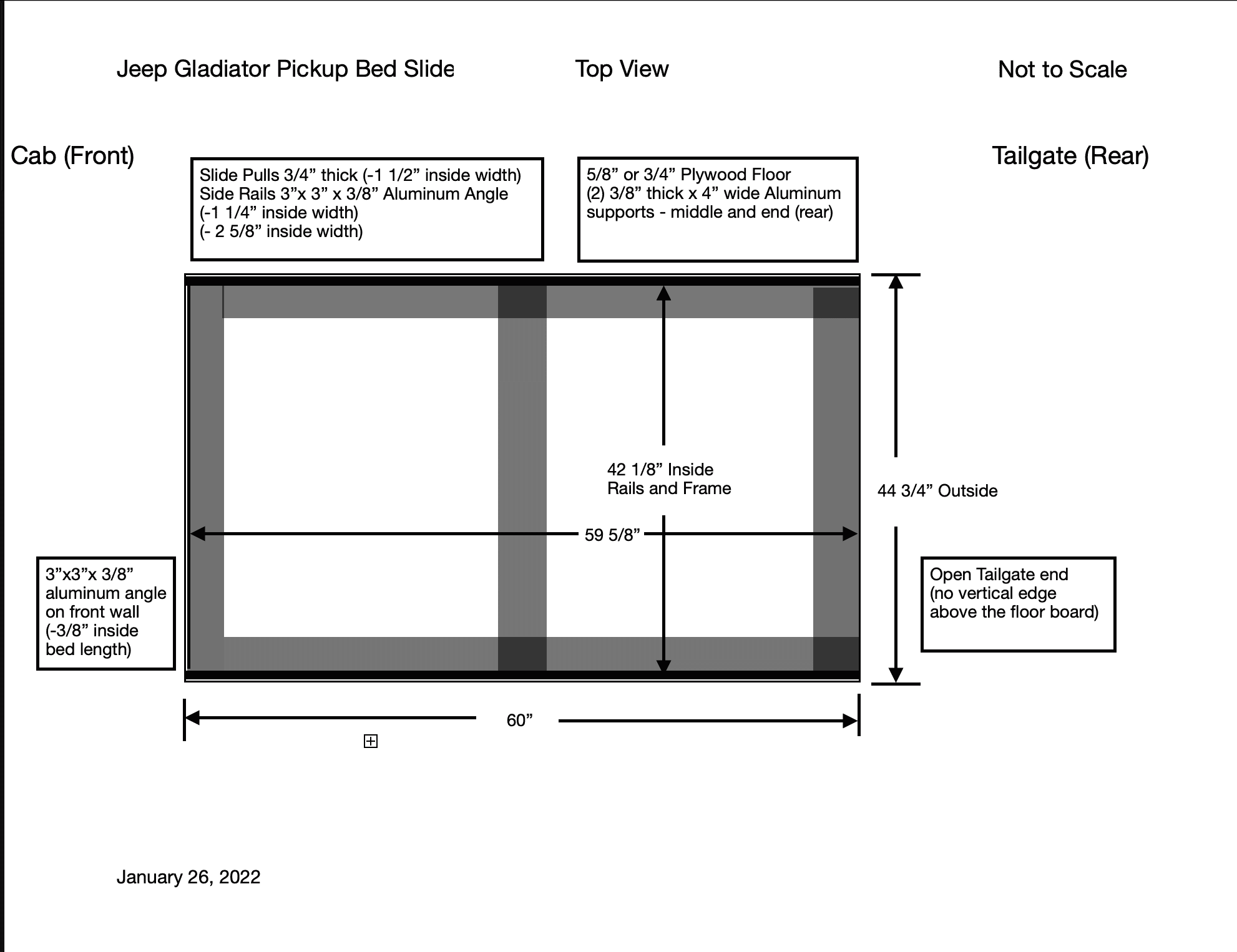

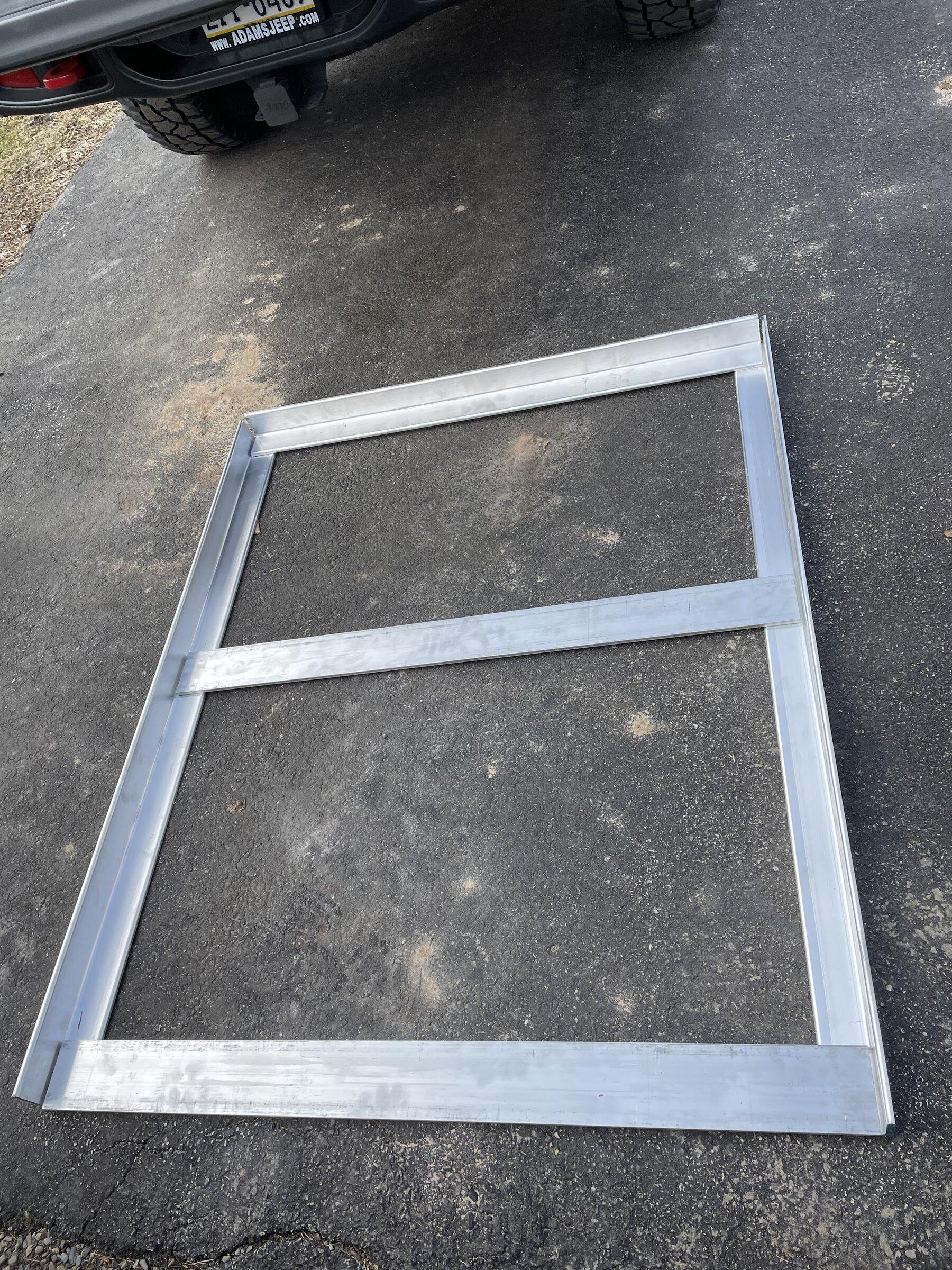

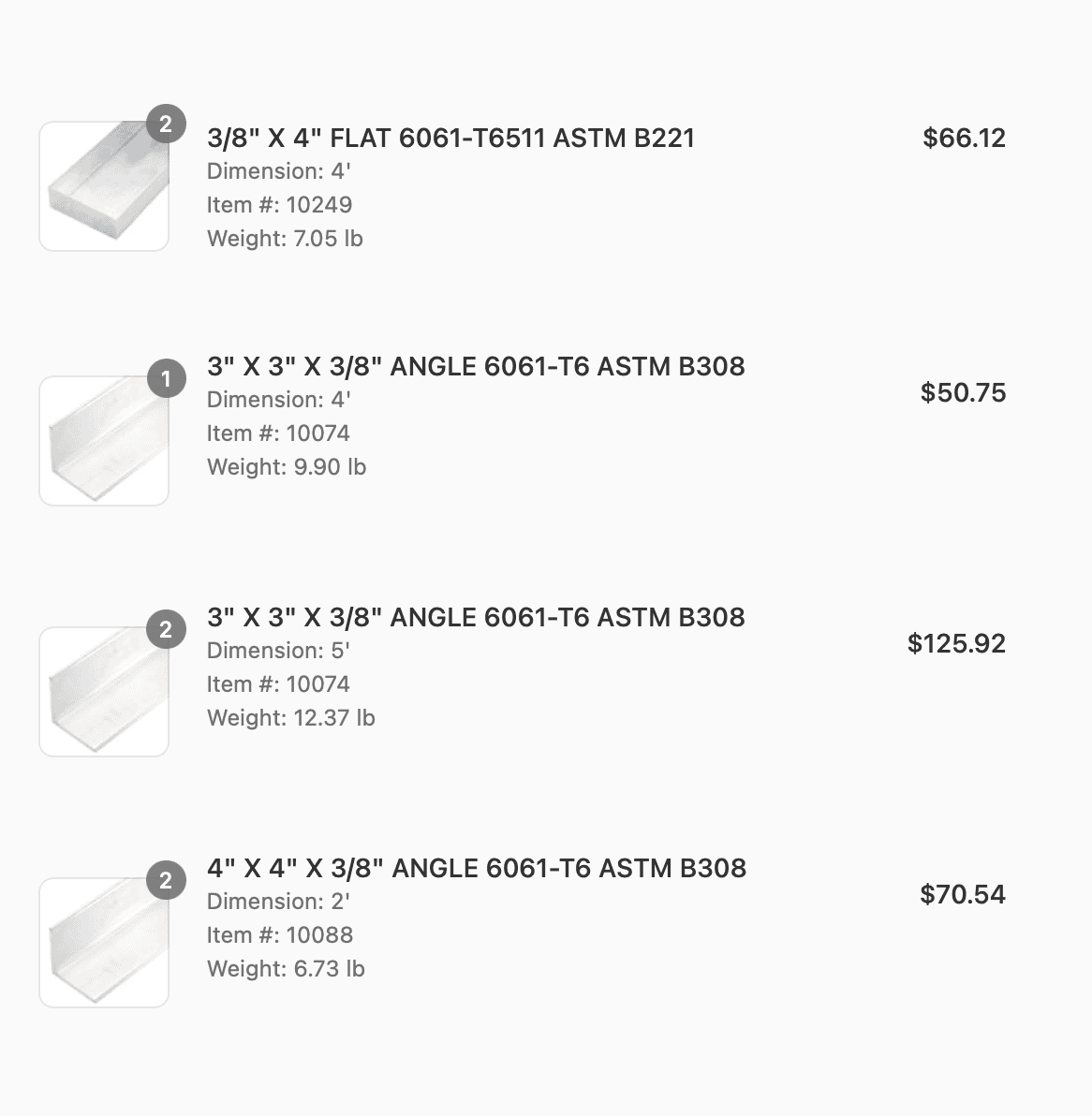

plans coming together. I decided to go with aluminum after my 1st build list weight for the steel was nearly 200lbs for just the frame. The 3/8" thick Aluminum is about 62 lbs. It should be here soon. Now need to determine if I'm using 5/8" or 3/4" plywood. Probably do 3/4" and add some roller bearings to the bottom to roll in case of sag.

Cut the handle off and attach a nylon strap to pull it out.
Thanks. That’s what I’ve been thinking too - simple and cheap.

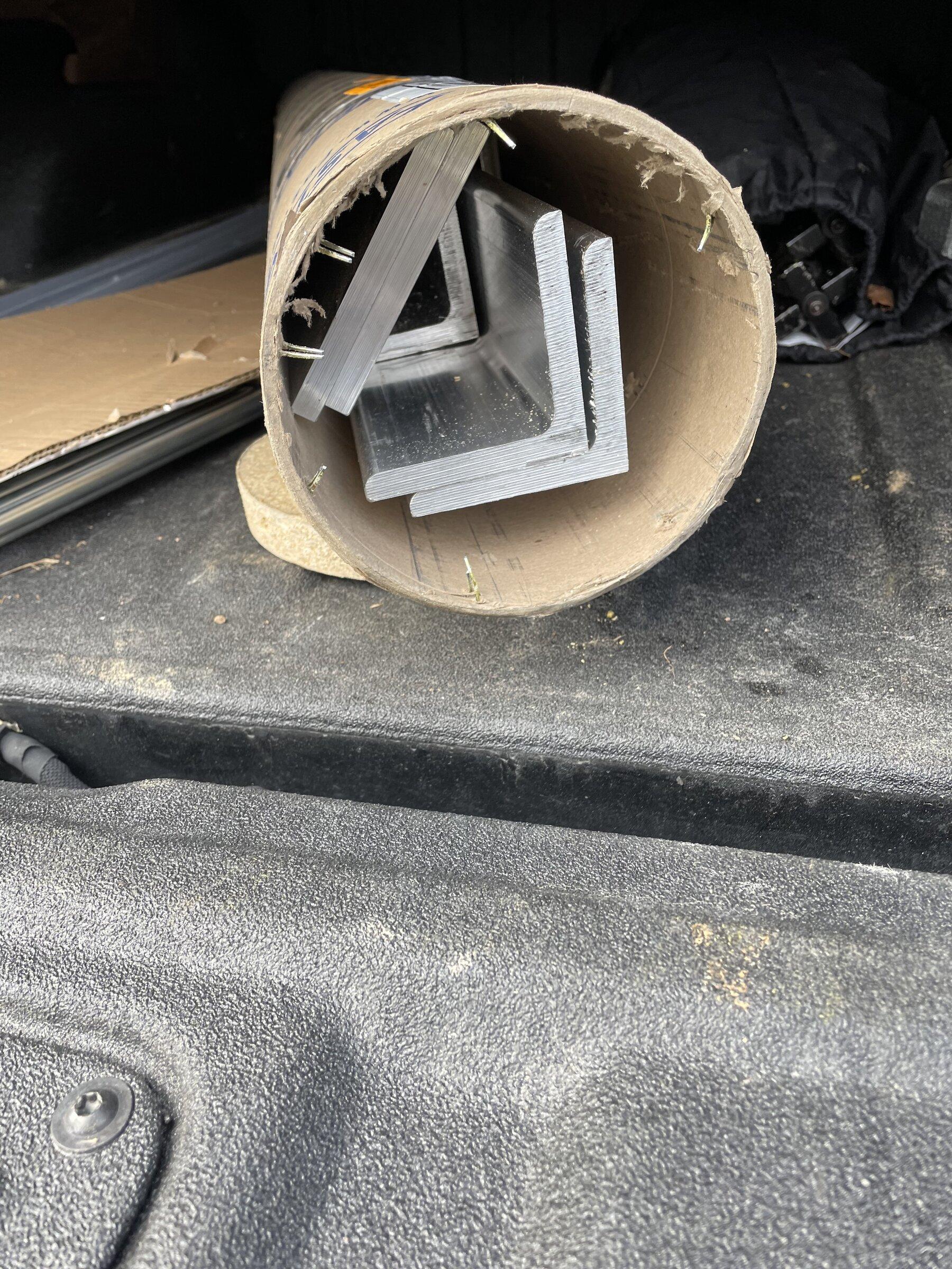

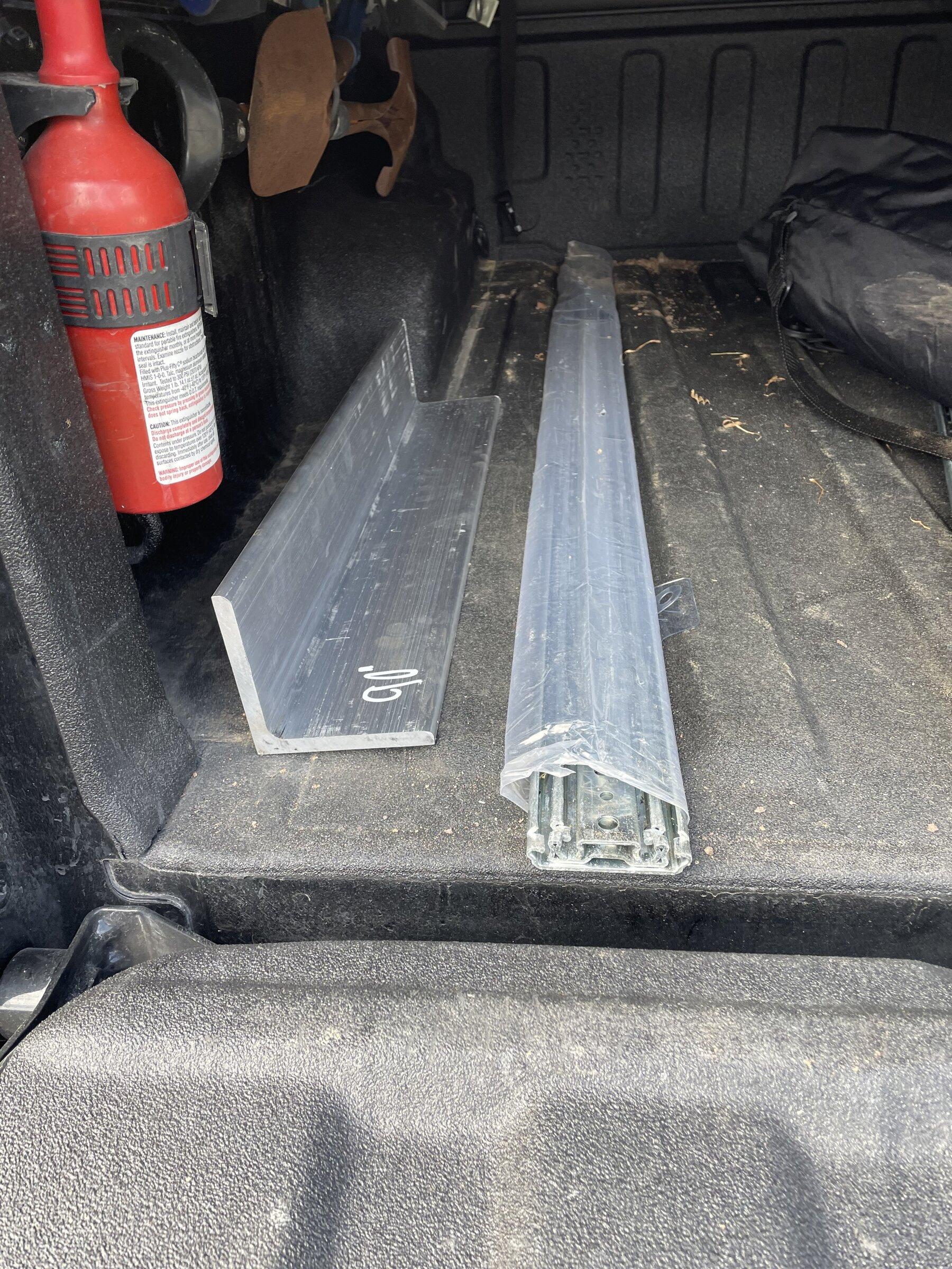

Got my Aluminum in for my bed pull out. Gotta find some time to measure, mock up, cut and braze (no TIG welder). Maybe this weekend? I’ll share more on YouTube too.
