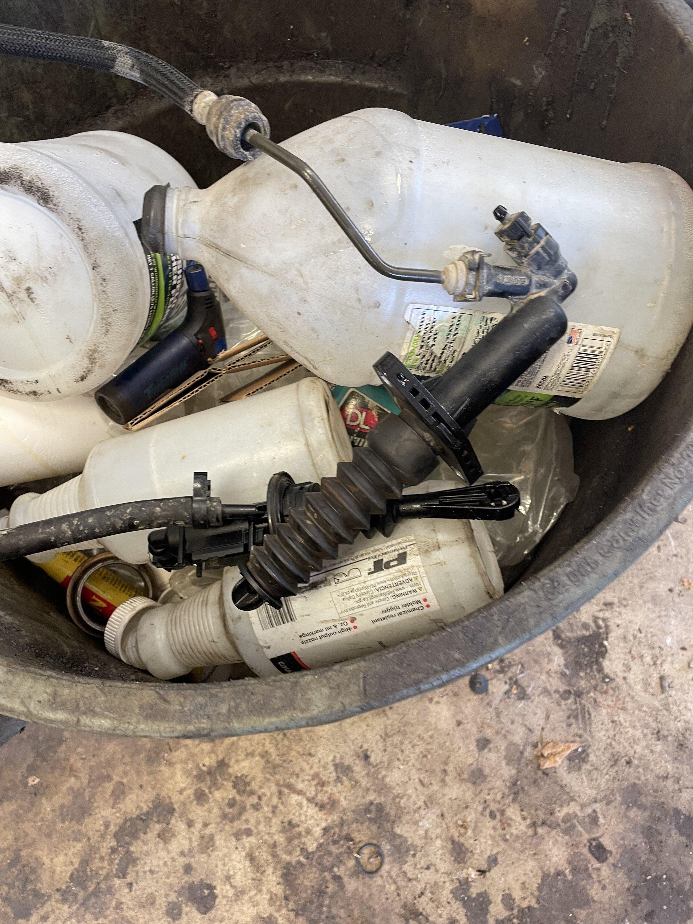

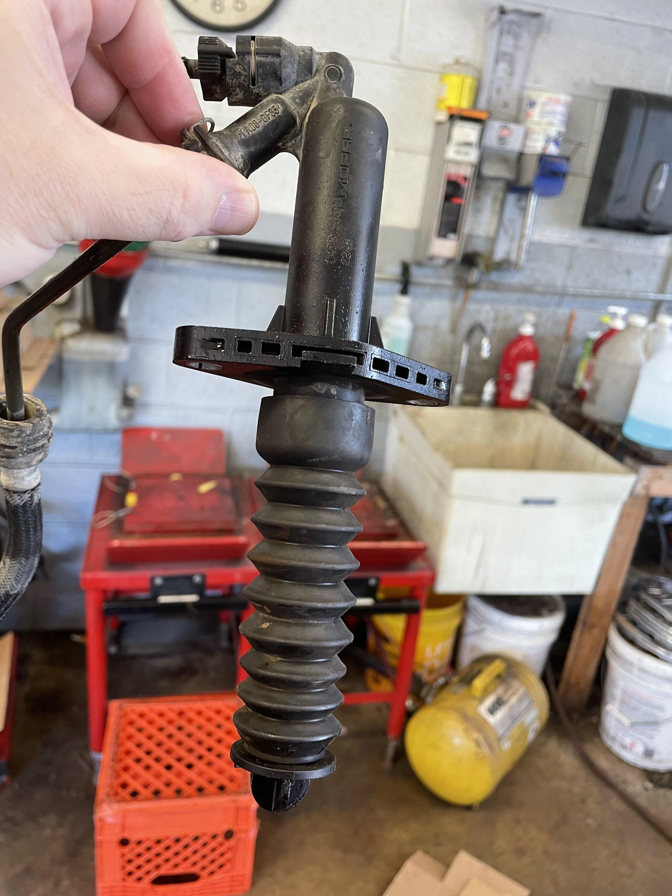

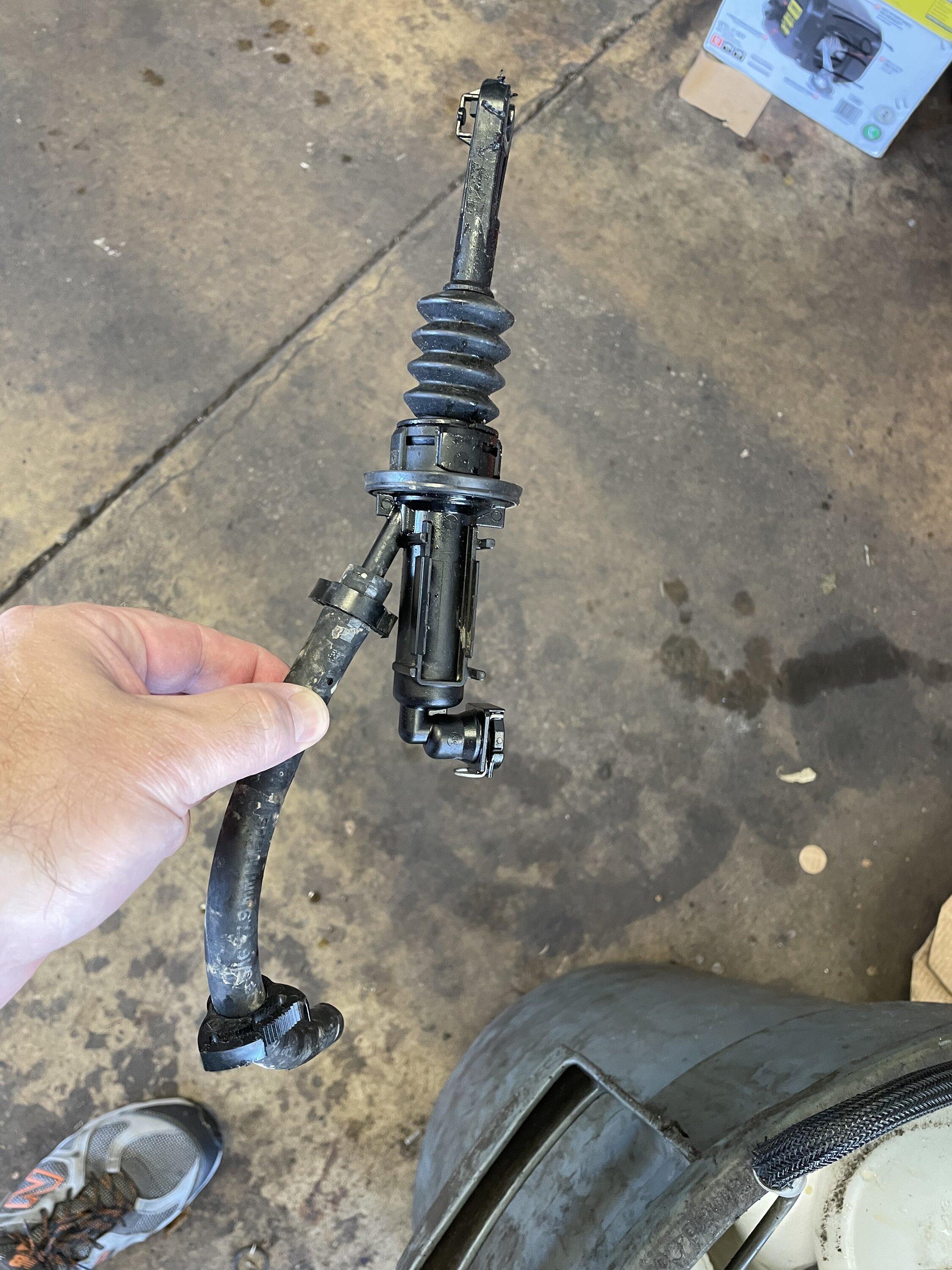

Got my Centerforce hydraulics installed. Only drive 5 miles or so. Feels slightly springier and a little more positive engagement/disengagement (the clutch and flywheel took away most of the stock clutch vagueness - this took away the rest). Can really tell in reverse and at the release point in 1st from a stop. No real difference in the rest of the gears so far.
Quick video and pics of the stock stuff in the trash. Install took a shop about an hour. Bleeding the clutch was a PIA but he got it done.

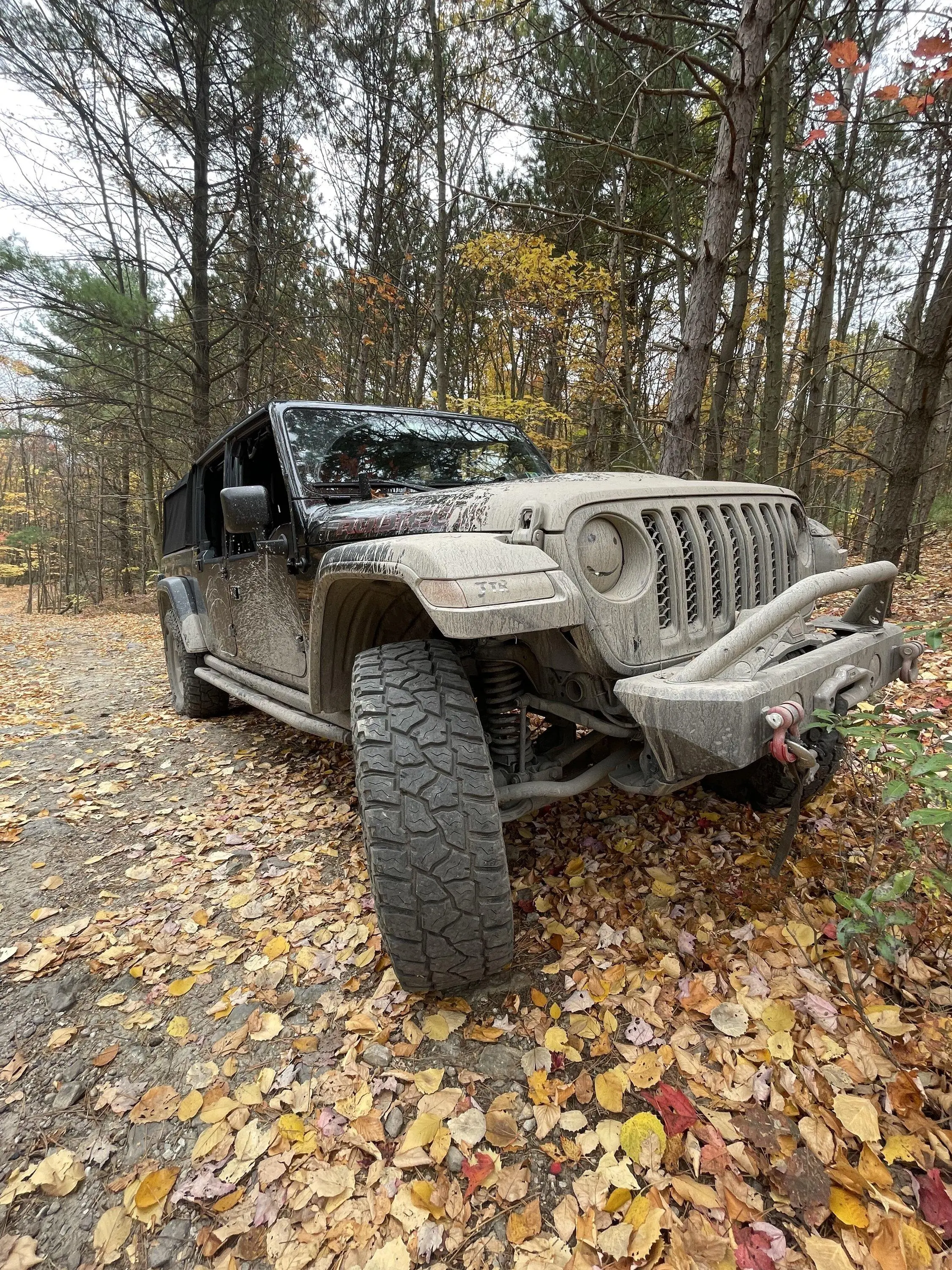

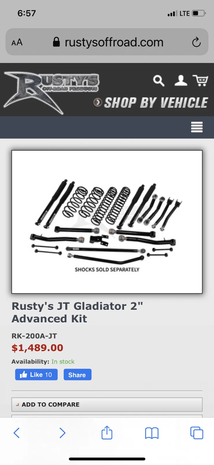

How is Rusty’s lift kit working out?
Great. Can’t beat the value. I can drive 85mph with a smooth, straight track and off road with good flex and comfort. Just got back from AnthraciteOutdoor Adventure Area off roading. As usual it performed well. I drove 5,600 miles this summer to Yellowstone and had zero issues.
