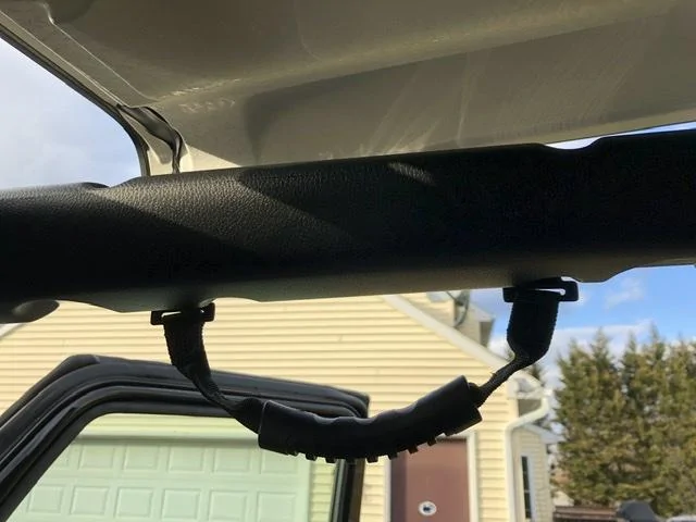

Installed the Quadratec rear grab bars. The front ones will require me to remove the roof panels. Wasn't ready to do that at lunch time today so it will have to wait. Pretty easy quick install and looks useful. Does require a T25 and most of my Torx stuff had a T20 and a T27 but I did find a T25. One note for the back seats - the first instruction should be to sit in the Jeep. Minor but it took me a few seconds to orient myself to the instructions.
Got the front ones in today. Just needed to prop up the hard top panels to get the ratchet in. Nice to have assist handles on the sport bar.
