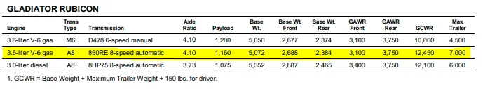

My understanding (from reading somewhere) was that the GVWR includes gas and a 150 lb driver (I'm slightly over that)
Conflicting info on that. Curt and other towing sites, Good Sam, Redarc and others all say NO, the driver is not included in that number.
Jeep specifies that their GCWR (Gross Combined Weight Rating) is the base weight plus max trailer plus 150lbs for driver. That is different from the GVWR (Gross Vehicle Weight Rating), which doesn't look to be stated in the spec sheet, but is printed on a sticker in the door. My Rubicon says it has a GVWR of 6250 lbs.
Jeep's spec sheet (LINK) states that a Gas Rubicon model has a payload of 1160 lbs yet my door sticker says my payload is 1225lbs.

While it's possible that Jeep is using the heaviest configuration for the numbers in the spec sheet, I find that the same discussion we are having about Towing Capacity would apply to Payload as well.

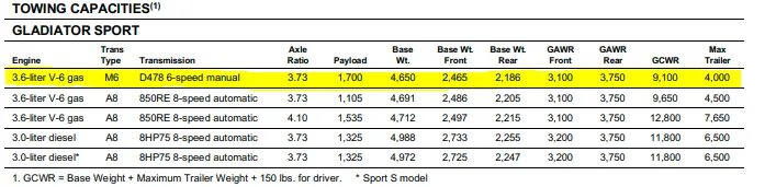

For instance, Jeep Marketing lists that you can get up to a max payload of 1700lbs in a Gladiator. The Jeep spec sheet shows this is for the 3.6L Gas Sport model with a manual transmission.
Jeep Gladiator Just looked my truck up on the mopar site... 1603400664952
Now, there is already a discrepancy between the spec sheet an my door jam sticker noted above for payload. Because this is going to be based on what options each vehicle has installed, it implies that the payload number in the spec sheet is the minimum payload available. It certainly doesn't seem that it could be indicating the max payload capacity because my Rubicon has more. So you could then infer that means a model COULD have more than 1700lbs of payload capacity.
Jeep specifically notes that the GCWR includes 150lbs for the driver but it does not have that same note in regards to the payload number. There's some shenanigans going on with their numbers that don't seem to clear.
WHAT GIVES JEEP!?!? @JeepCares
