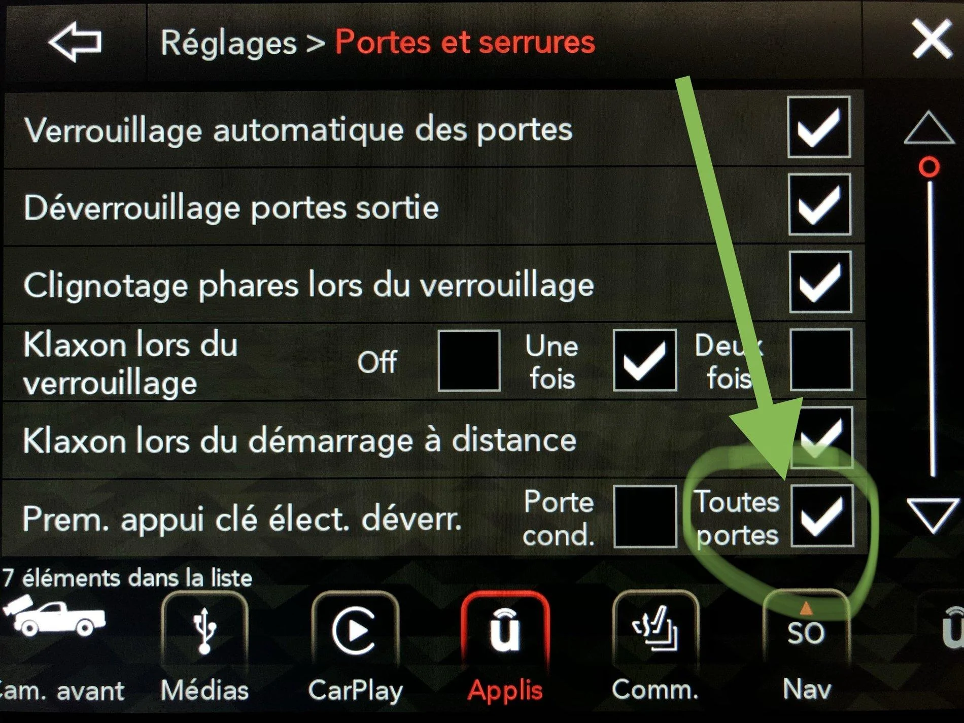

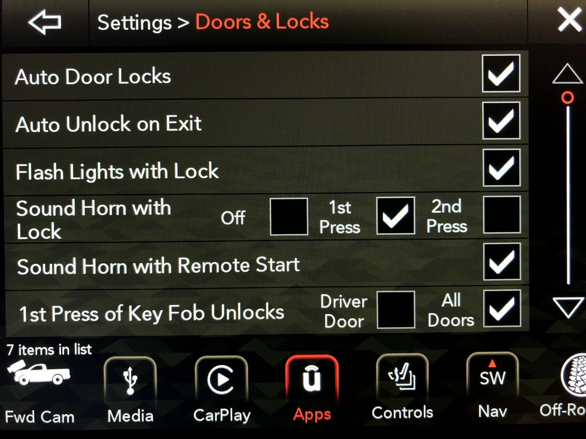

Yes it’s possible... I set it like this on the first day... just go to Settings —> Doors and Locks —> First press of key fob unlocks... all doors
Jeep Gladiator Keyless Enter-N-Go Passive Entry System 1D386917-07CE-484A-A721-3E9C68A57666
(EDIT: got back to the Jeep for another thread and set it to English for the time of the picture:
Jeep Gladiator Keyless Enter-N-Go Passive Entry System F960591F-265F-40B4-82DF-9EE91B48171D

Yeah - in the uconnect lock settings. Most vehicles from Jeep in the last couple of years or more you can set to unlock just the driver door (a SAFETY thing for women traveling alone) or unlock all, etc.
So if you set it that way a bluetooth proximity system could unlock the tailgate - because it could be programmed to unlock all. However, such a system MUST interface with the Jeep's system and so far I've not found such a system.
