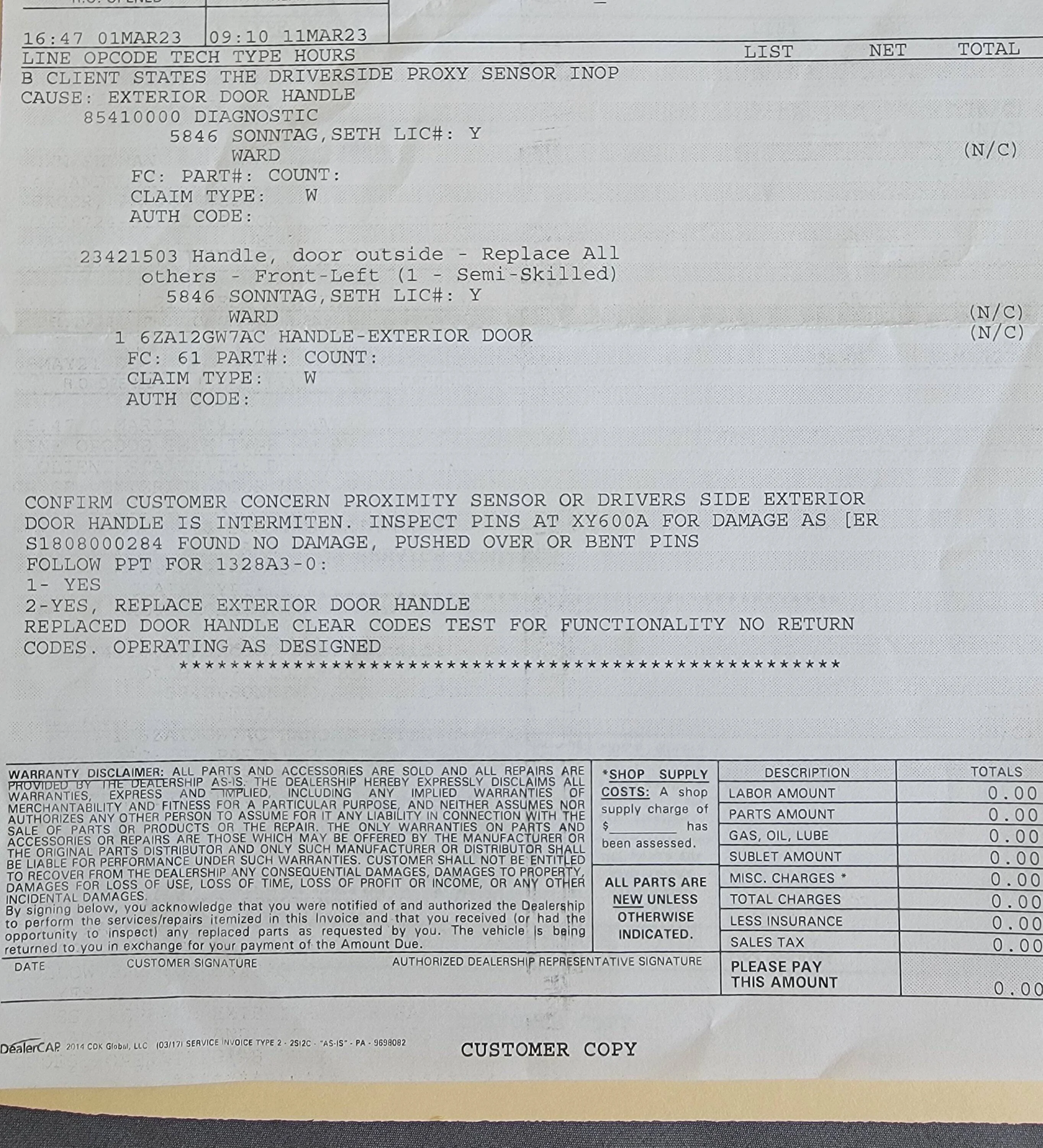

Ankh
Apr 27, 2021
99
230
16066
'21 Gladiator, '10 commander
Steel
Here is the work order. Again, just my driver side wasn't working and my key fob buttons were operating the locks just the passive entry wasn't working.
It shows they checked for bent pins and then replaced door handle. Hope this helps.
