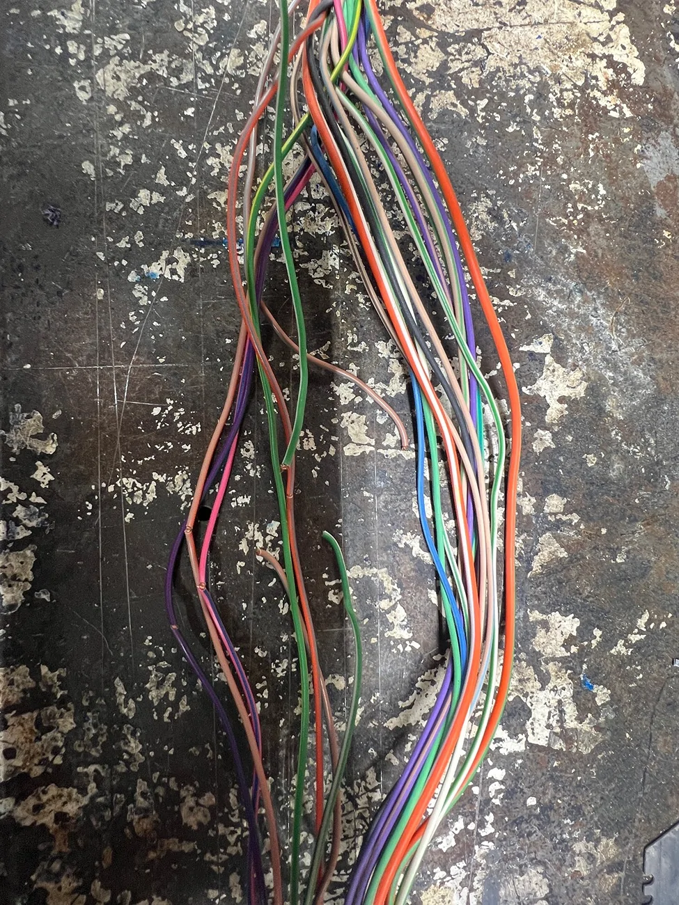

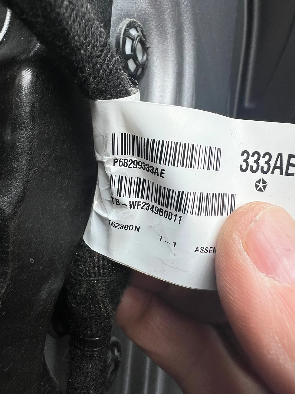

I found two completely broken wires and five others that had cracked insulation, ready to completely break. These are in the door harness inside the webbed door check.
I purchased a new door harness, about $80 shipped.
Thank You for the tip! I'll check it out.

wiring harness is common, just replaced it on my 2020 wrangler.
ALlMoparPart is a vendor sponsor and had the harness to me in 2 days. About an hour/hour and a half to get it replaced. There's a bunch of YT Videos on adding passive entry to the jeep, just watch those and you'll get a good idea on how to replace the harness. Getting the harness in and out around the door handle is a PITA, but it's not complicated just tricky working in a tight space.

After watching a couple videos about removing the door panel it was pretty easy. All of the door components, lock actuator, window regulator and harness etc come out mounted to a “ bracket” as one unit. Possibly the easiest door I’ve worked on.
