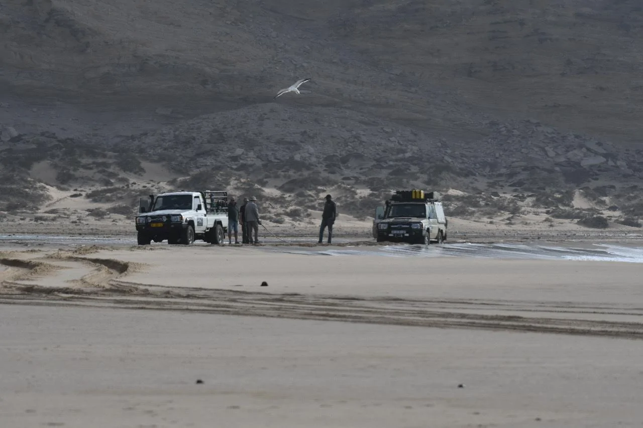

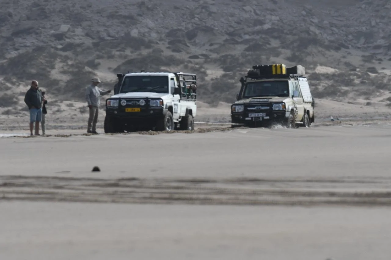

I’m a huge believer in using a kinetic recovery rope as a first option if the situation allows it.
In my expeditions in Africa totaling over 6 weeks all of our trucks (LC 79’s) had winches and kinetic ropes and well as tow straps.
In the dozens of times members of our group got stuck ranging from the mud flats along the ocean to the very soft desert of Namibia we never once had to resort to winching someone out. It is just easier and quicker to use a kinetic rope. Of course most of our drivers were very experienced and were quickly able to realize that they were stuck and did not continue to dig themselves into an impossible hole.
Now if you were mud bogging I can see if winching might be necessary, or if you found yourself on a precarious edge of a cliff or something similar.
As an example here are a couple of pictures where we were driving along the coast trying to find a reported colony of Cape Fur Seals. On the way out things were a little soft but the tide was rising. On the way back we, well most of us, decided to drive higher up on the beach but one of our friends thought it was firm enough...wrong!
