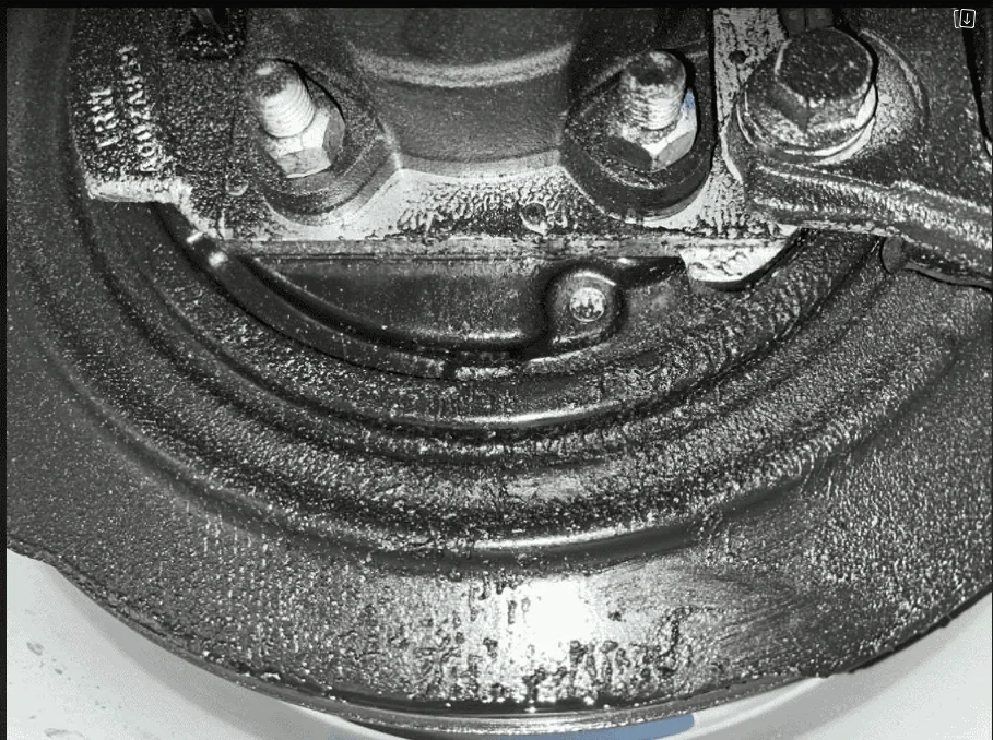

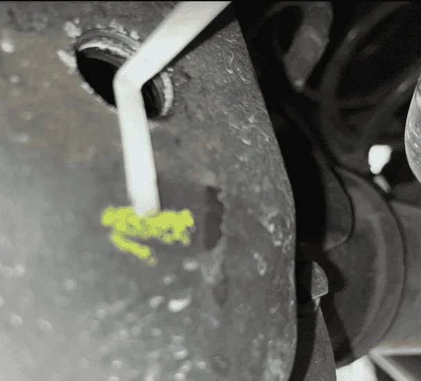

just had wifes Rubicon in for right rear axle replacement ,due to leaking seal discovered at 23k, i measured how low the Diff oil was before repair ,oil was as low as the lowest part of the axkle shaft housing ,hoping this has not damaged the Diff as i believe the truck probably did 4-5 k with low oil. Techs just dont look underneath any more when they change oil and rotate tires, Was under warranty but I think a full axle may be next if it starts howling. No offroad or oversize tires were used. Just failed.
I bet on no damage. Looks like a lot, but then a tablespoon of oil will go a very long ways.
If you could pull the fill plug and put your little finger in the hole and reach the fluid within the first joint, it's ok. In other words, 1" down from the bottom of the fill hole isn't a problem.
The ring gear is what lubricates things by slinging the lube around inside. It's like a big scoop with those teeth and when you drive, it literally tosses the lube to where it needs to go.
In many differentials, there are also channels that catch the oil running down the inside of the differential housing and guide it to the pinion bearings.
Things don't rely on being down in the lube to get protection.
Not totally sure what you mean by this part:
>> ,oil was as low as the lowest part of the axkle shaft housing <<
But if you mean it was level with the axle TUBE, it's ok.
(I wasn't sure because normally "housing" is the differential housing - the cast part in the center, and axle tube often describes the steep, not cast, tube that the axles themselves are inside on their way from the wheel to the differential, which is the center with the cast housing)
I doubt you lost enough lube to do any damage. Your description does not imply "low oil". If you can't reach it with your pinky - it's low. If you can, it needs lube but isn't low enough to do damage.
I've rebuilt and repaired my share of differentials and axles in my career - it takes more than 1" down to do damage
In my experience, techs look at all 4 wheels and I have video proof that they have been because they sometimes send me a video of them looking at the brakes and anything with fluid.
A leak can also happen fast - my front shocks were dry not all that long ago, now they are quite wet.
My wife's Wrangler was totally dry under it when we were in Florida and then shortly after getting back - no problem.
She took it to church and back, about 55 miles round trip, and the rear of the transmission had fluid hanging off all of the rear bolts, the cross member was dripping and it left fluid on the floor. Dry one day, leaving fluid all over the next.
So really, who knows how long it's been leaking.
Could be for a long time, weeks, could be not so long.
A little oil goes a very long ways.
That's a bad leak, and could be a sign of a bad axle bearing as well as just a seal.
Get it in ASAP.

I think there may have been an issue with some of the axles being machine milled below needed diameter hence allowing seals to leak . The main issue with the low fluid is that the outer axle bearing would not have a good amount of oil . When you pull the rear axle half shafts you should have a nice little stream of oil from the diff until it levels out with the lowest part of the axle tube going into the diff.. my level was already that low so the outer bearing was not getting a good oil bath as needed.
