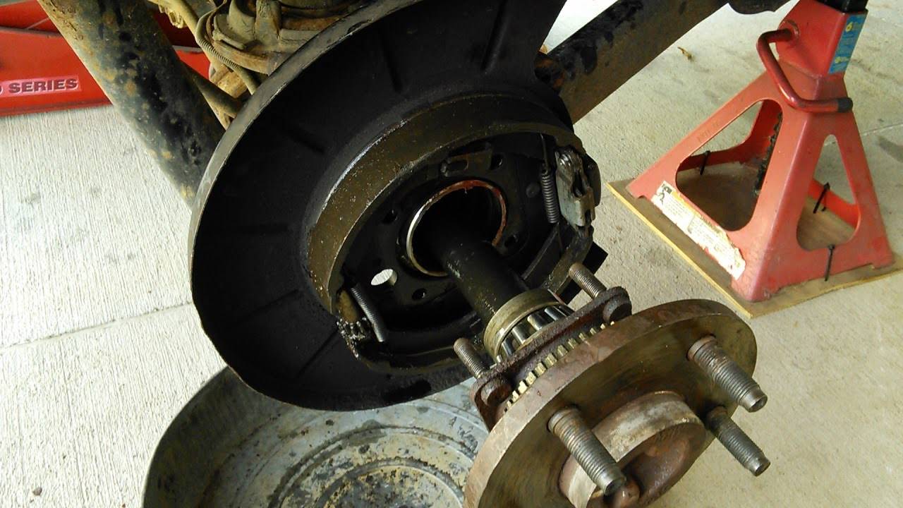

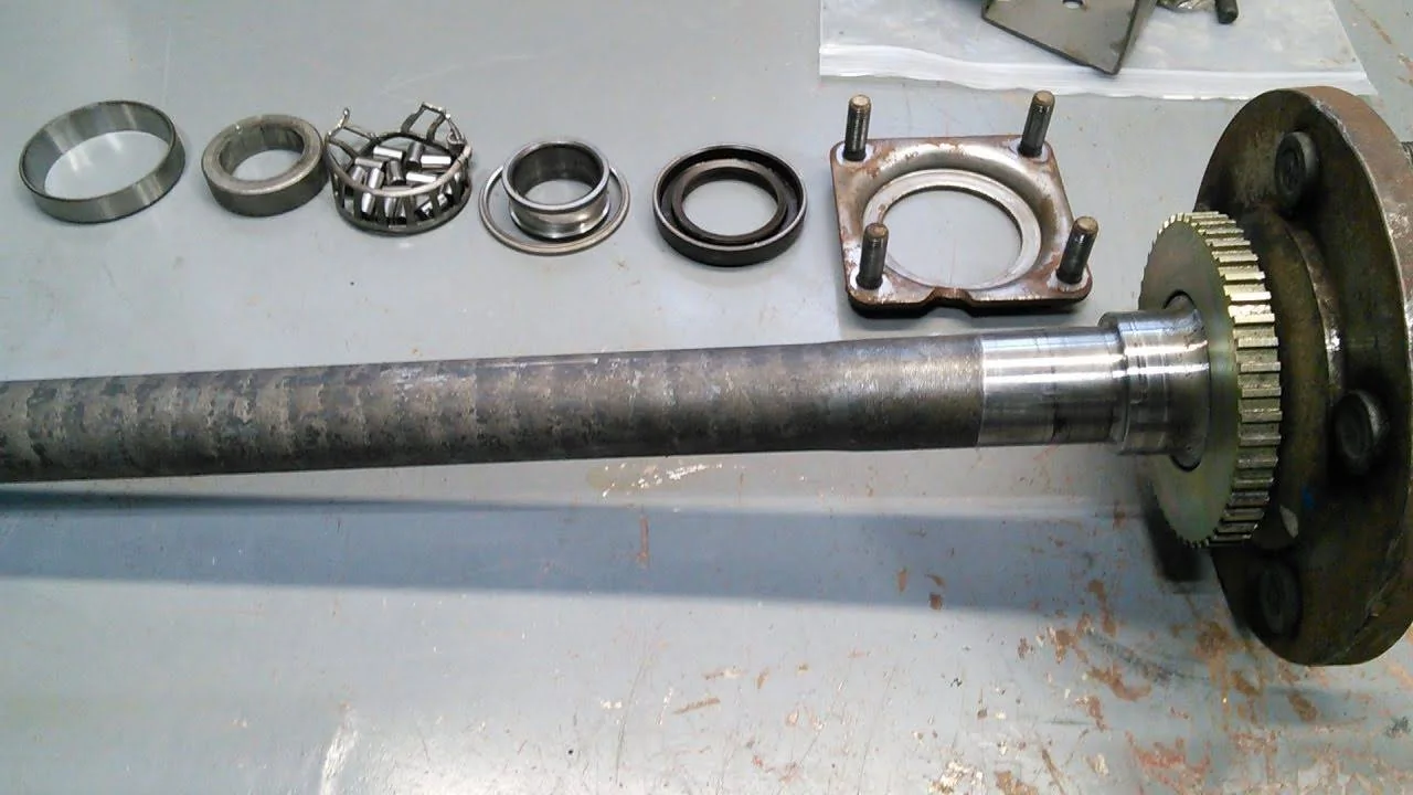

Funnily enough when I had a WJ grand cherokee with the D44 rear end I had to replace the rear axle seals (both passenger and driver) but at different times. Instead of paying a shop to cut off/press on new seals (no garage of my own at that time) i'd go to the local junk yard and find one with less miles than mine and no apparent leaks, pull the whole shaft, swap it out, and be on my way. Did that twice and both were still fine many thousands of miles later ?
40,463
53,908
I did the right one on my 2004 WJ that has 124,000 miles on it. They should easily make it that far. The thing was over 20 years old.
Pretty easy process on those. Biggest thing was all the lube all over things.....

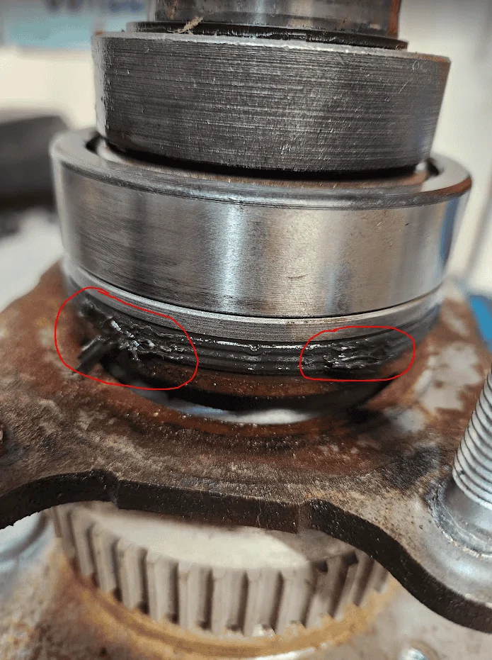

I saved the old axle to hopefully do the cut/press new bearing and seal one day. What I'm being told is that the individual parts are not available for the JT to do this. My shop checked with their supplier about using the JL rear bearing and seal but apparently it's not the same? If anyone has specific part numbers to share please do so as I'd like to try my hand at a rebuild.
FWIW these are the (2) bad spots on my seal...
Yeah, you have to buy the axle with bearing and seal for the JT last I knew. But for the older 44s, you can get almost any part you want - bearing, seal, whatever.

Pull the bearing and seal and take them to a bearing supply house to see if they can cross reference them. The bearing should have some text lasered into it for the bearing house to use. the seal they can measure and find a match.
https://www.skf.com/us/products/industrial-seals/power-transmission-seals/radial-shaft-seals

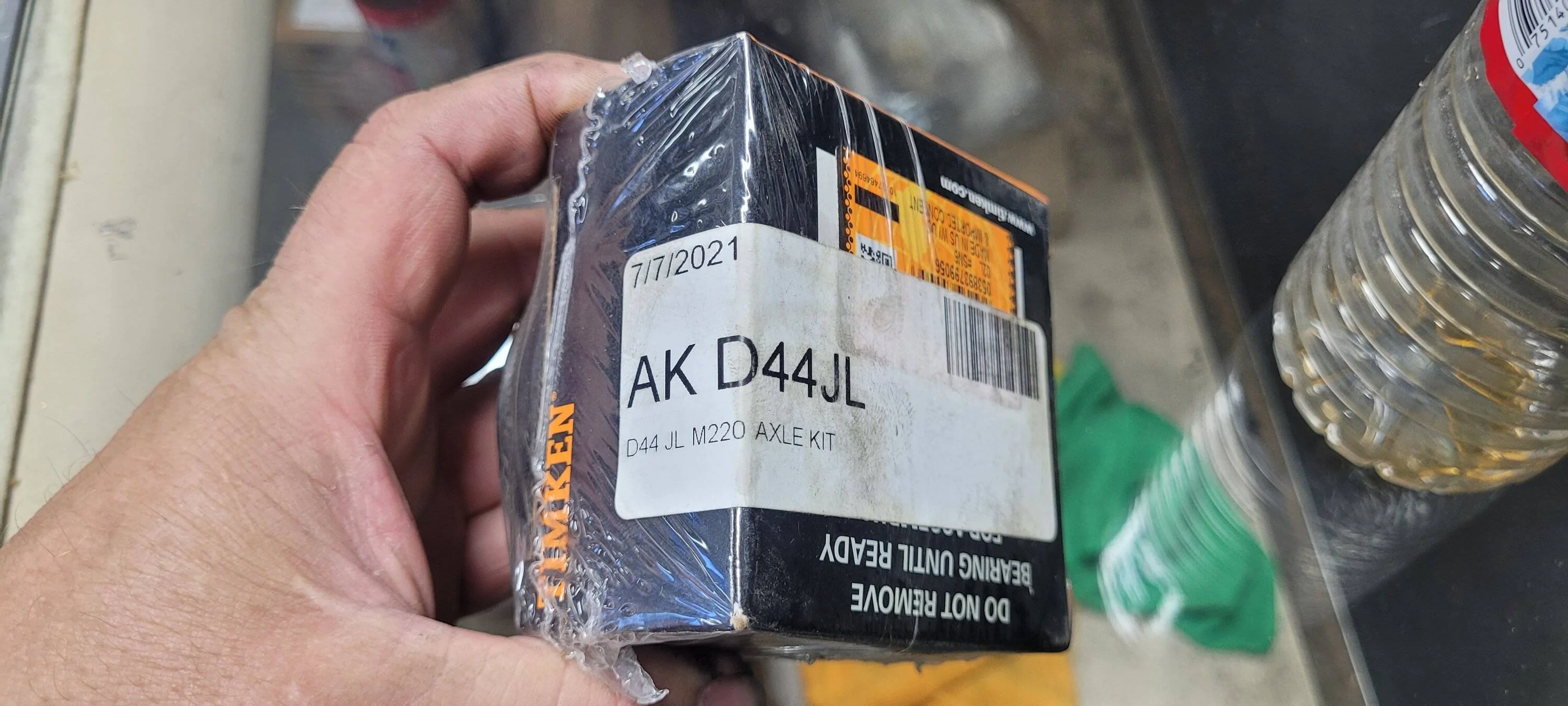

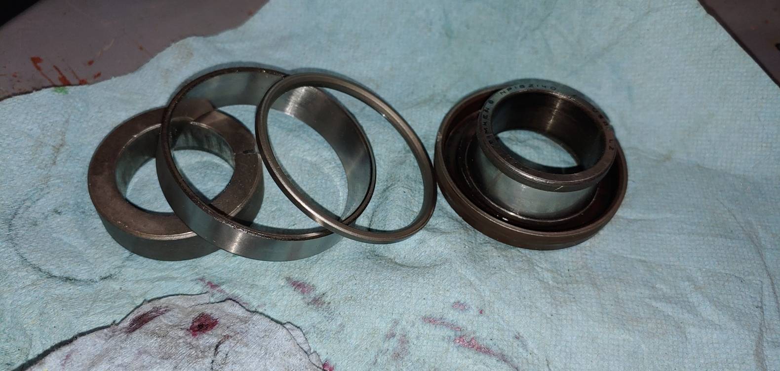

Call West Coast Differentials and order an AK D44JL kit. Comes with bearing, seal, and retainer.
I'm going to start carrying one under the seat on road trips because nobody seems to have a listing for the bearing/seal combo locally.
*Update: "SET80" bearing kit
10026762 seal
