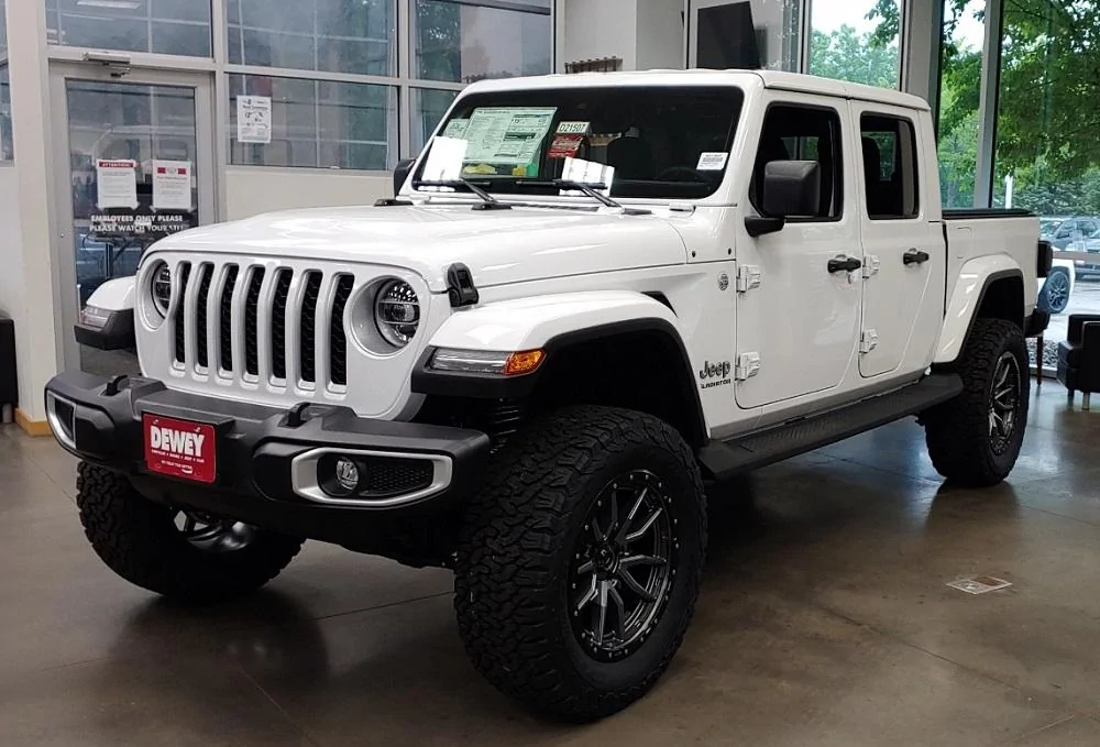

Got the call that the parts are in. Appointment set for Thursday. I'll be sure to mention the brakes and if they don't have the brakes in stock I won't be leaving the truck. Even though I'll get a rental I just hate being out of "my" vehicle for any amount of time. I'll be sure to check up on their work and hopefully they do the right thing and clean ever little bit of oil they can. Already had an issue with them almost not ordering the axle because I don't have factory size tires. According to their paperwork I have "larger tires than factory" but they didn't put down the size, I have Mojave take offs so its not like I have some outrages tire size.
40,442
53,859
..................... Already had an issue with them almost not ordering the axle because I don't have factory size tires. According to their paperwork I have "larger tires than factory" but they didn't put down the size, I have Mojave take offs so its not like I have some outrages tire size.
LOL - that's funny. They maybe don't realize that MOPAR dealers sell bigger tires and some of them sell JTs modified with bigger tires and different wheels?
Show them this 'dealer modified right after it came off the transport truck' JT for sale in the showroom of Dewey in Ankeny. I believe it's a 3" lift, bigger wheels, bigger tires, still has the window sticker on it.
Dealers sell them already modified with bigger tires.

The service manager did mention something about paying for a tire "upgrade" not exactly sure what he said but pretty much jeep wants your money just so you can "keep" your warranty.
40,442
53,859
I wonder - could he have been talking about programming in the tire diameter - which you have likely already done?
When I asked my dealer about it a couple of months after I bought my JT and when I was putting the Rubicon A/T take-offs on it, they said yeah, they could do it and would be happy to reset things but told me I'd be better off buying a device to do it myself.
