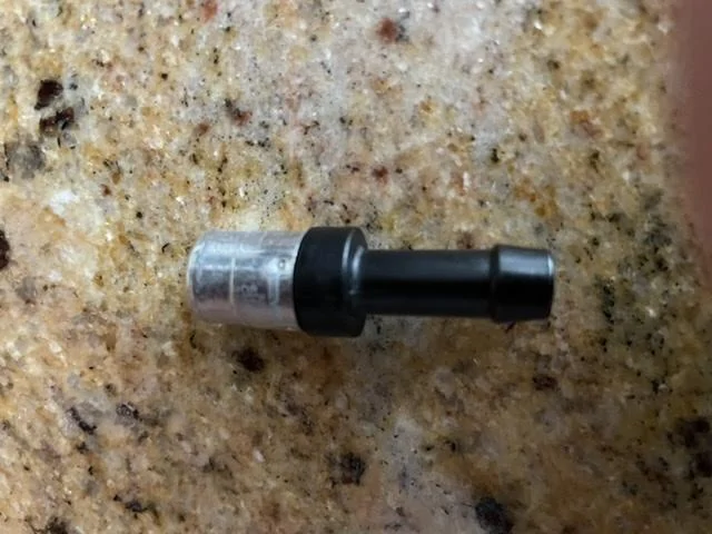

I didn’t see this info in the thread but can someone please advise on how to replace the rear diff vent? For some reason I can’t seem to even find it on my JT. I picked up this replacement:
You don't know where your stock Gore Industries vent valve is even located, but you've decided you should replace it with that thing? Follow the vent hose from the passenger side axle tube...if you must.
I have to ask - why?
Hmmmm, replacing an item that's not proven to be a problem (I said proven by professionals) All vehicles I am aware of that are 4 wheel drive capable (meaning SUVs, SUV wannabes, even my EAGLE, has a HOSE that runs the vent up into the frame. Been that way for many decades. Follow the hose - most vents are in the frame or waay up high in the back.

It's above the frame crossmember, over the axle. I was actually considering extending mine, but decided it wasn't worth the trouble after I found out it was a Gore valve. I did extend the front vent up above the fender line, just to be extra cautious for deep water crossings.

This was the part I was recommended. That’s why I posted it as I wanted to ensure it was the correct part - perhaps it’s incorrect then.
My understanding was that folks who had swapped the vent out didn’t see the re-occurrence of the axle leak so I thought this $5 part couldn’t hurt. Maybe I read that wrong. Just was asking for guidance as I’ve not replaced this type of vent before, and perhaps I shouldn’t bother.
The Gore vent causing the problem is just a theory, which was tested maybe once. That theory can't be confirmed without putting a Gore valve back on that Jeep to see if it starts leaking again after putting it back on. If the Gore valve is the problem, why does the axle leak disproportionately on the right side vs. the left. There isn't going to be a pressure difference between the two sides.
Ok thanks Renegade for the info.
40,442
53,859
If I recall, it was replaced in a case where the axle was already replaced. So it may well not have leaked anyway.
I found specs for Gore valves that MAY be what is used on these and the volume of air they move is pretty decent - measured at 1 psi, which is the limit of what most humans can blow out with their own lungs. (few can exceed that).
Seals like these - with a wedge-shaped lip, withstand 7psi - some more. To a point, pressure against the large backside of the lip pushes it harder against the axle shaft.
If the valve moves more volume than what an axle housing has, even at 1 psi, it tells me that it can move more air than the housing holds and at a pressure 6 psi lower than the seals can withstand at a minimum.
I need to go through all axle leak threads and set up a spreadsheet like I did on the trailer brake controller and other stuff - find the dates, models and other information and quantify things.
Right axle - why right? If in theory both seals are capable of handling 7 psi and the vent moves more air than the differential itself holds at a rated pressure of 1 psi - let's say 1 psi builds up, both seals can handle 7, then why only the right?
Even if you build up 5 psi (unlikely as the flow is rated at 1 psi) both seals should hold. Pressure against the wedge-shaped lip should seal it. So I believe it's not pressure-related at all, but a defect in the seal, the axle, the tube or the installation.
Replacing a vent after the axle is replaced doesn't prove anything.
Replacing the vent and saying "my axles don't leak" also proves nothing as they may well not have leaked anyway.
Even if the seal stops leaking if you replace the vent - doesn't prove that's THE issue as the left never leaked with the original vent. It likely only indicates that the right seal has a problem and can't handle ANY pressure at all, none, while it should handle several PSI - like the left one does.
So saying "I replaced the vent and it stopped leaking" doesn't say anything at all about the vent being the issue - it simply proves the right seal can't handle anything other than totally equal pressures when it SHOULD handle several pounds of pressure - the left one does.
