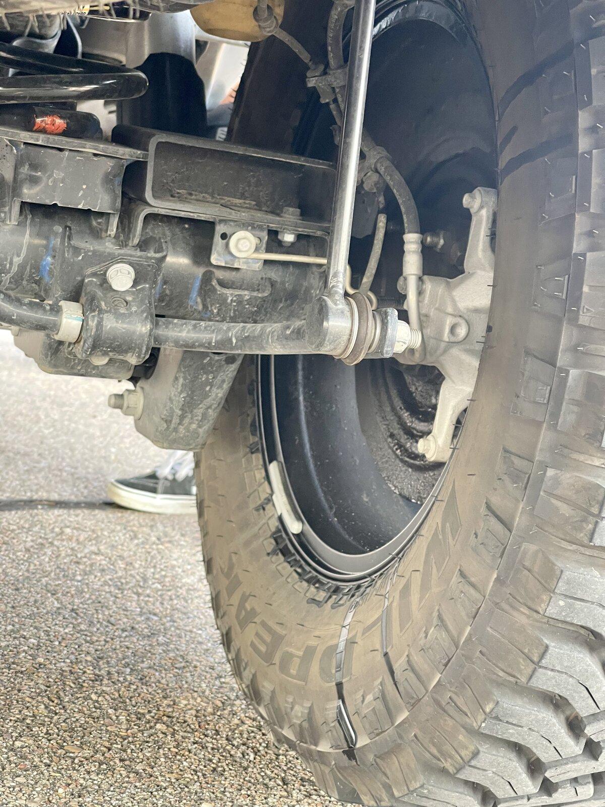

Add me to the club. Rubicon. Right rear passenger. Diesel 2021 10K miles.
that's a BAD one.. mine quit after changing the rear breather vent, but it was never like that
