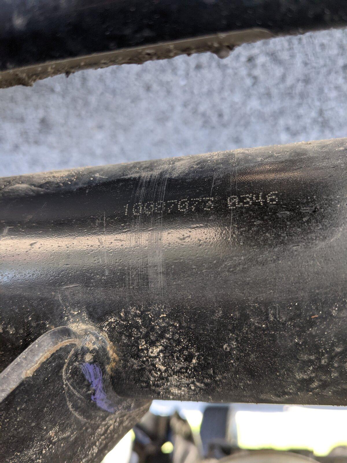

This is where the date that should be close to MDH date is. Not sure what the 8 digits to the left are for, but the 0346 would be 2020 Dec 12

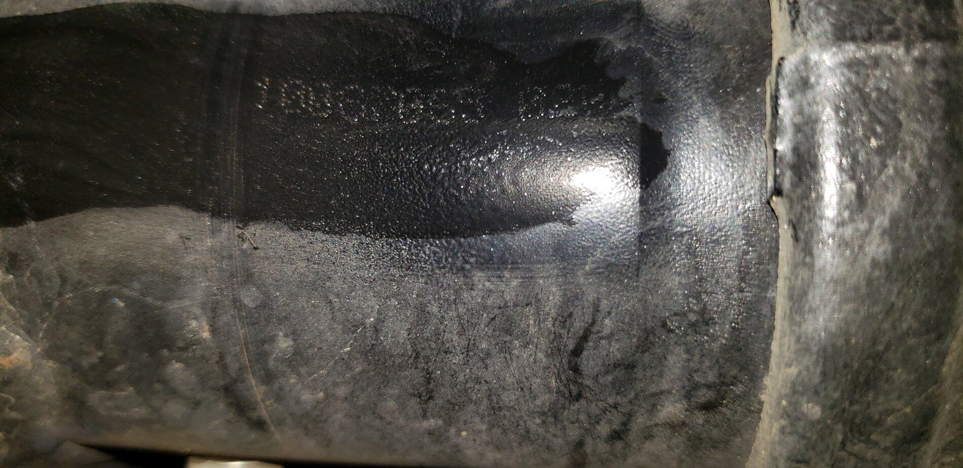

Well I looked earlier and didn't see it, so after your picture I looked and its extremely hard to read and my numbers are upside down. I flipped the pic, but is yours upside down?
Yeah, I had to rotate the pic too.
