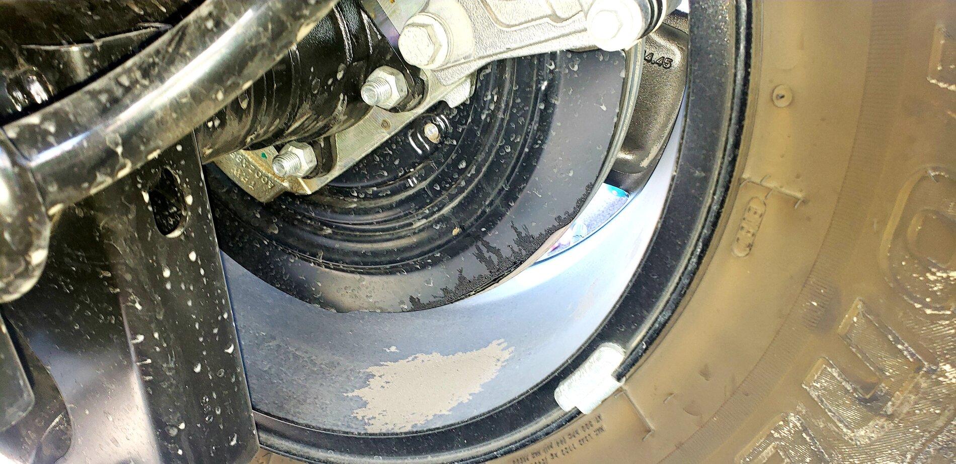

Welp, just checked mine based off the number of reports. Its looks small but could easily turn into a big issue. What do you think? 2021 Sport S
I didn't notice mine until recently. It's obviously been going on for awhile now. I still don't have any visible drips on the ground, so it's not leaking too bad yet.
Take it in. Jeep needs to be made aware so they can track numbers, build dates, axle types and more. If you let it go - that's one less that know about and then if it gets worse it contaminates your brakes and.......... yeah, I'd take it to the dealer.
Thank you and I agree, when I took a 2nd look, it looks like it dripped into bottom of rim and sand covered it up. It looks worse than the first time I looked at it

Update: Appointment Thur Sept 9. Service department said they may just replace the seal, but won't know until they actually look at it. If they just replace the seal it will be done that day. If they replace axle then it will have to be ordered and I would be released to drive until it comes in. I brought up warranty and he said it should be covered (they haven't actually looked at it yet) so fingers crossed they don't pull one over on me and void it.
Any help you can be I would appreciate @JeepCares.
Latest update this morning:
Dealer checked it out this morning. They are going to do new axle. Could not give me time frame due to backorder. Releasing me to drive it until then. Also said would be warranty, so that's a relief.
