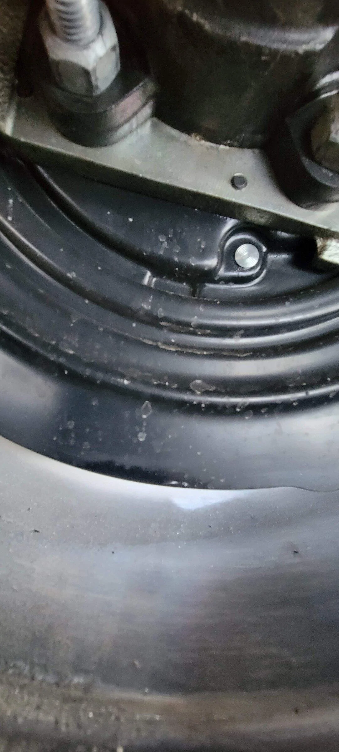

Well after the 3rd attempt to fix by putting a entire axle housing, 1250 miles later, we have a leak. I am honestly done with this truck.

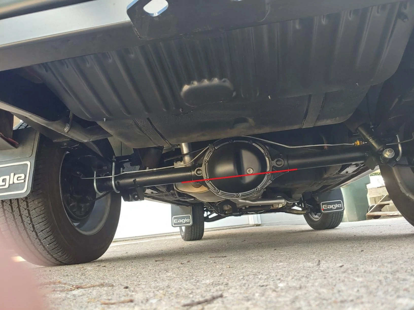

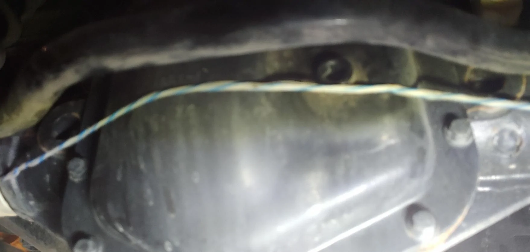

Look at a typical fill hole compared to the axle tubes - and explain how to over-fill it. Even at the top of the hole, if you pumped and held it in with your thumb until you inserted the plug, you can't fill the axle tube.
Below that is a JT Dana rear differential cover showing a string line stretched from bottom of axle tube to bottom of axle tube and look where that line intersects the fill hole........... try to over-fill it.
Jeep Gladiator Leaking axle seal? sx4-differential-lin
Below is a JT rear axle - even if you filled until it's running out the hole, it won't fill the axle tubes. Even if it did, that's what seals are for.
