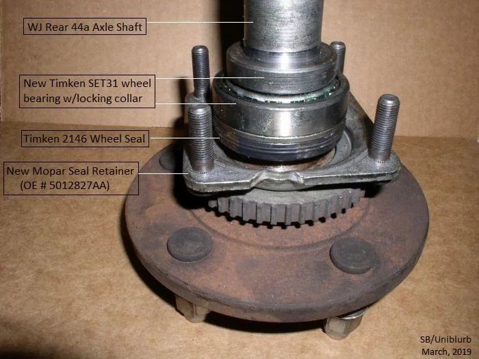

An axle that's too short would simply not engage fully in the carrier gear splines. Without an axle in hand, can't see how length has anything to do with anything as far as leaking.
The bearing and seal boss on the axle is on the outboard end, and length can't impact that unless they were machined incorrectly.
Here's a typical axle configuration - hub (integral part of axle), retainer, seal, bearing (either ball bearing or tapered roller bearing), retainer (in most cases, not all)
If the axle is too short, it simply won't engage as deep into the carrier side gear splines, but the seal area would be the same.

No, you misunderstood my problem with the LF axle area. It was not leaking but had a grinding/whining noise.
That is separate and distinct to the RR axle leak.
I got into the conversation with the tech because when he said the axle was too short I enquired about the stats of the hub, and didn’t want to wait another month for more parts once disassembled.
